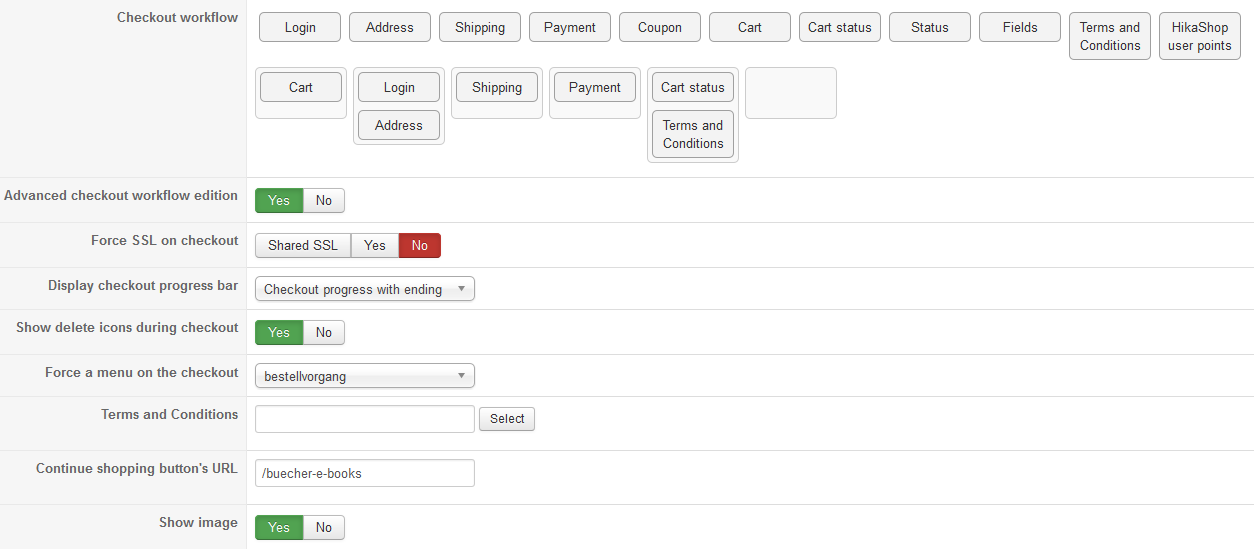

Would it be possible to have a screenshot of your Checkout workflow ?
  • Posts: 154
  • Thank you received: 4
11 years 9 months ago #178645
sure, there you go

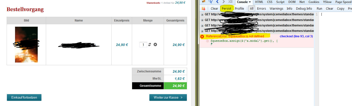

11 years 9 months ago #178946
hi jerome,
problem still persists, be careful to enable "persist" in firebug console, and also keep in mind that this only happens the first time adding something in cart. in order to reproduce this afterwards you need to clear your browsercache/cookies...
i attached you a screenshot
  • Posts: 26381
11 years 9 months ago #178961
I think that
JHTML::_('behavior.modal');
is still call in the HikaShop cart helper.
The following user(s) said Thank You: olivnewton
