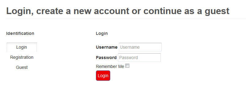

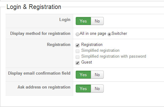

Problem 1 - I need registration and guest option. I set it to login: yes, switcher, registration: registration and guest. When you go to checkout you can only login, the buttons to switch to register or guest does not work. Also, if you have logged in, it does not seem to log you out. You go back later and put an order in, the last login shopper comes up.

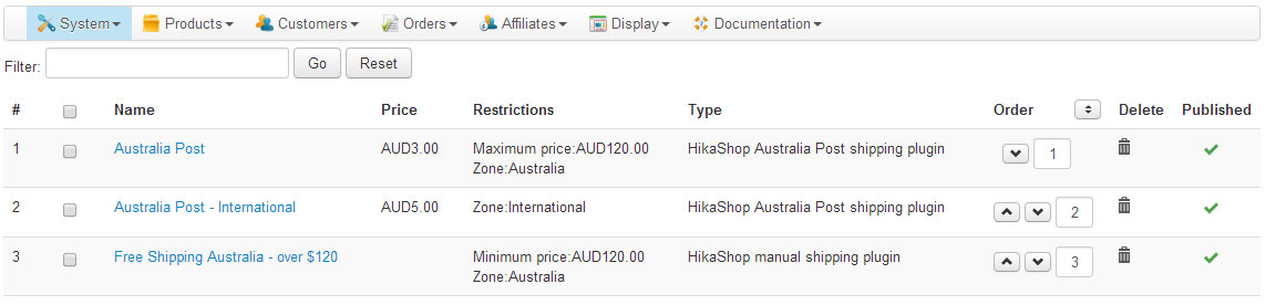

Problem 2 - Might have to revisit this after fixing the first one. We have free shipping for orders over $120. We use Australia, post, zone set to Australia, max amount $120. I have setup a manual shipping for Australia again with max amount $120, postage amount $0. When you go to checkout only free shipping shows up. (This setup was emailed to me pre-sale).

1. Strange, you don't have any javascript errors, the needed html is present. Could you try to checkout with a default Joomla template ? Do you have edited any views related on the checkout ? Removed any javascript file ?
2. Could you give us screenshots of your shipping method settings ? One of the method must be "Max amount = $120 - postage amount = XX$" and the other one "Min amount = $120 - postage amount = 0$"

It did work by switching template for checkout. But I need to get it working with my template.
I have not made any changes to the checkout file and I have not removed any javascript files, just CSS overrides. Do I need to add a particular javascript to my template for it to work? I am using bootstrap.

I think it is bootstrap related. I need it to be bootstrap though.

11 years 11 months ago #163444
Checking further on that, the issue is with the javascript of the template.
Maybe because the bootstrap javascript is added twice to the page ? I would recommend to try to remove the one of the template.
A easy alternative I can provide is to add that CSS:
#data_register_registration_method input{ display:inline !important; }
That will display the radios next to the buttons and the radios will work.
Another easy alternative would be to turn off the "use bootstrap design" option of the HikaShop configuration but then you'll loose the responsiveness.

I removed the bootstrap javascript and it looks like that did the trick :). I am will be testing to make sure everything is working as it should, it is looking good.

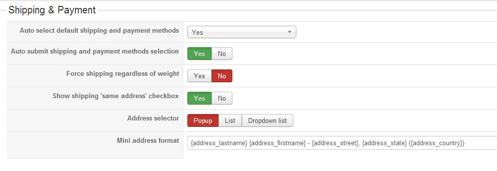

I still have an issue with checkout and postage. Unless you are logged in or if you are a guest and you have already typed in your details you get the message:
The total of your order is too low for all the possible shipping methods.
People need to get a chance to enter their details before they get an error message.
I have attached images of shipping configuration and postage options.

11 years 10 months ago #164331
You should disable the option "Auto select default payment and shipping methods".
That should solve the problem. You can change its value to only when only one is available.

11 years 10 months ago #164417
I set 'auto select default payment and shipping methods' to no, cleared browser history but I still get same error when I go to checkout.

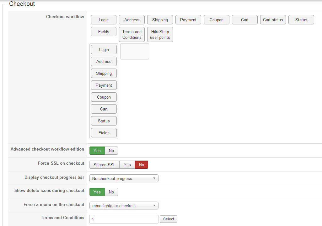

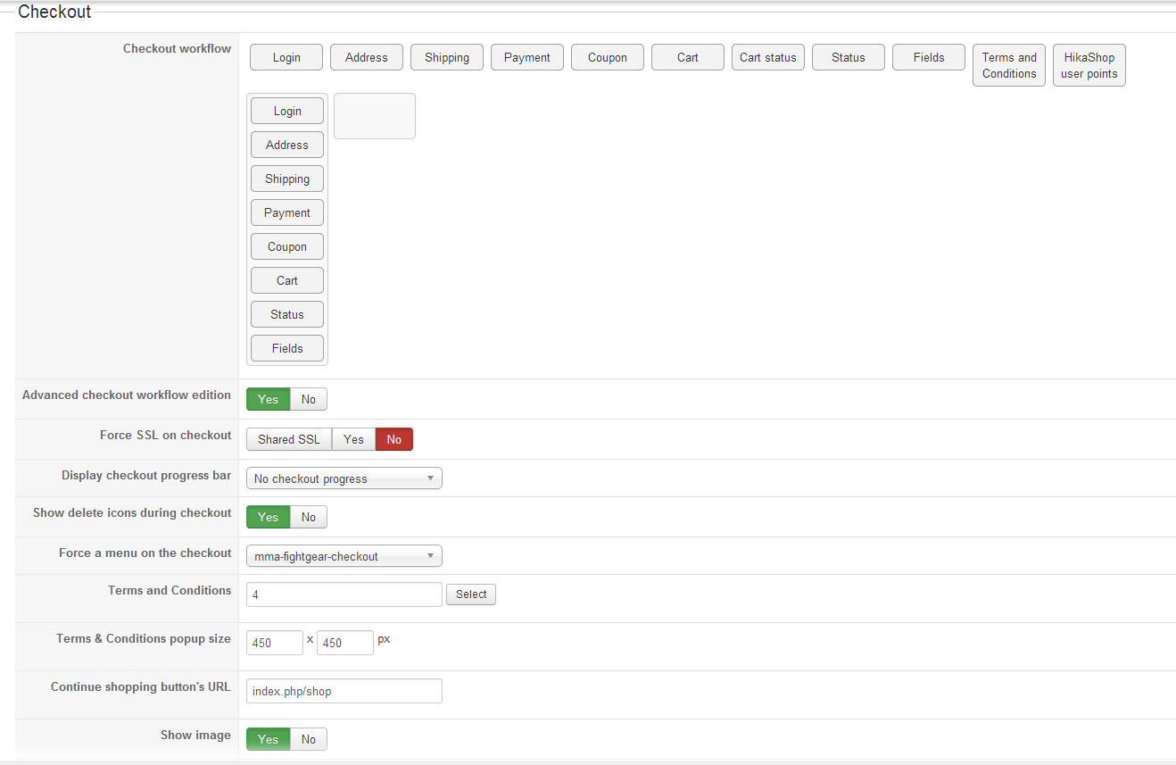

Can you please advise on the best order for the checkout? I have attached an image. The current setup is out of the box after installation.
Can you also tell me how I can change the order, I can drag it. I can see you can drop it into the empty square below. I would appreciate some explanation on how it works with the two rows. Is the horizontal (top) row the actual workflow or is it just available options to drag to build your workflow? And what is the vertical workflow currently in place?
I have attached an image of my current setup.
Thank you
Lene
11 years 10 months ago #164598
When checking out, you can setup many steps.
First step, some informations, then click next, and you have to fill other informations, etc.
So in the configuration screen, on column is for one step.
By default all the informations are asked in the only one step, the first one.
You can change this setting in order to have many steps by doing drag and drops to the empty place in the second column, and then you will be able to add a third step, etc.
Hope this will help you.

11 years 10 months ago #164790
Hello Lene,
I think that the solution will be to :
- Go to the page "Hikashop->System->Configuration->Checkout"
- Set 2 steps through your checkout workflow
- Set the "Login"/"Address" action through the first step, and the other actions through the second step.
