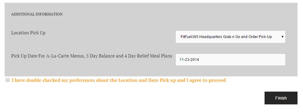

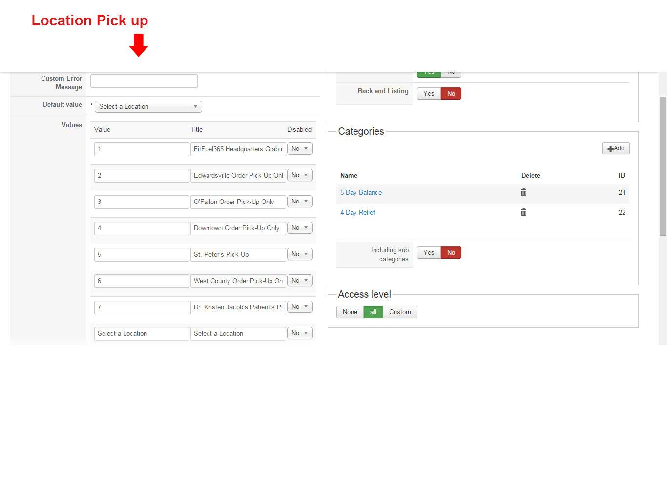

Hi Jerome,
Thank you so much for trying to help on this. It's really important part of the website.
Please, look at the attached screenshots. I currently deleted all the pick up dates fields and left only 2 for the first two options of the Location Pick Up field. The configuration is the same like the one on screenshot I sent you with a previous message, the only difference is that I disabled the Default today option for all cases.
One other important thing is that I don't see that the "Hour for extra day" is working at all!
