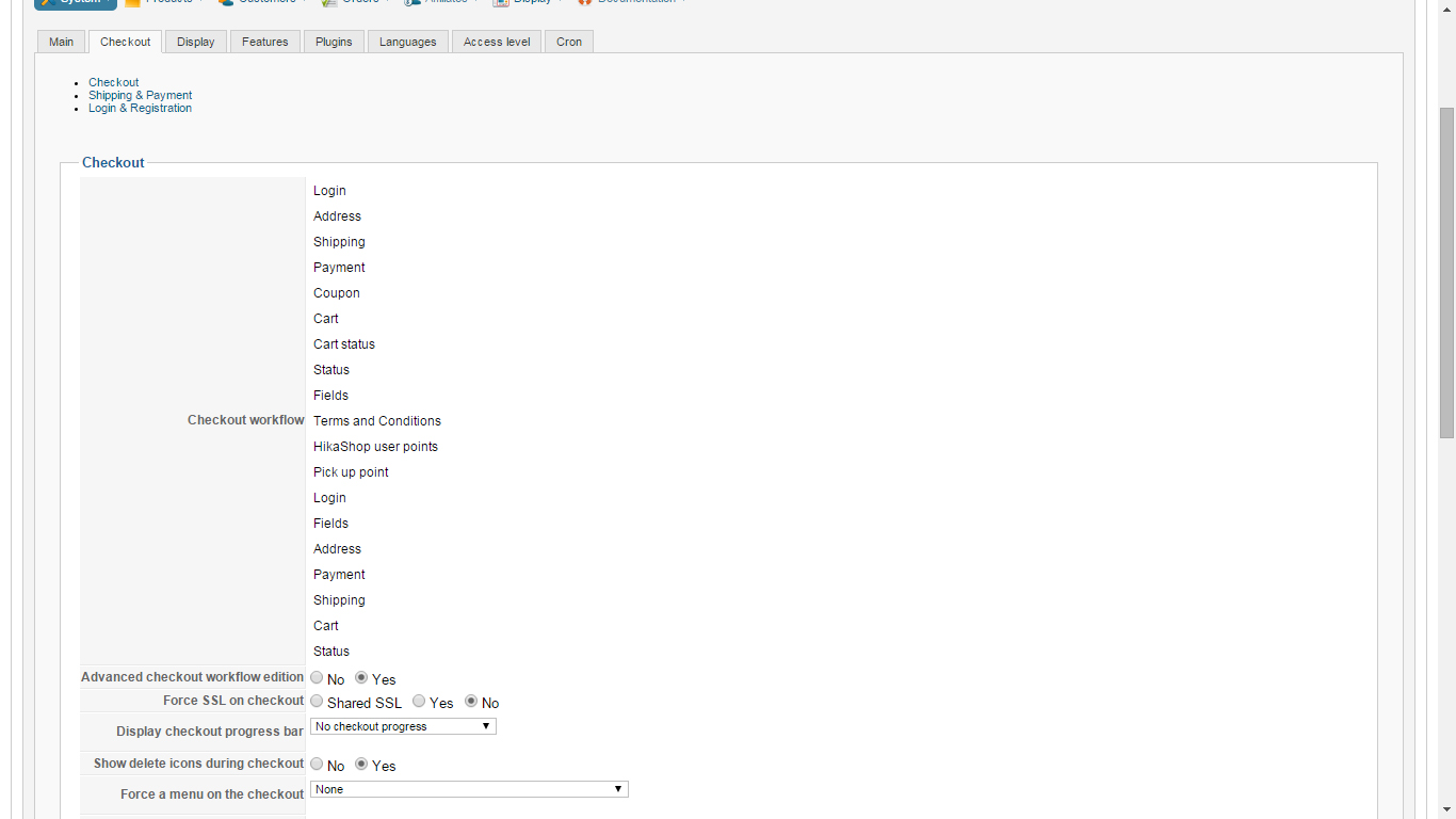

did you solve the problem? If so - how?
No I don't have that issue on my end so, can you show me through some screenshots how did you configured your checkout workflow via "Hikaoshop->System->Configuration->Checkout" after setting the "Advanced checkout workflow edition" option to "NO" ? And also tell me which shipping and payment method did you used ?

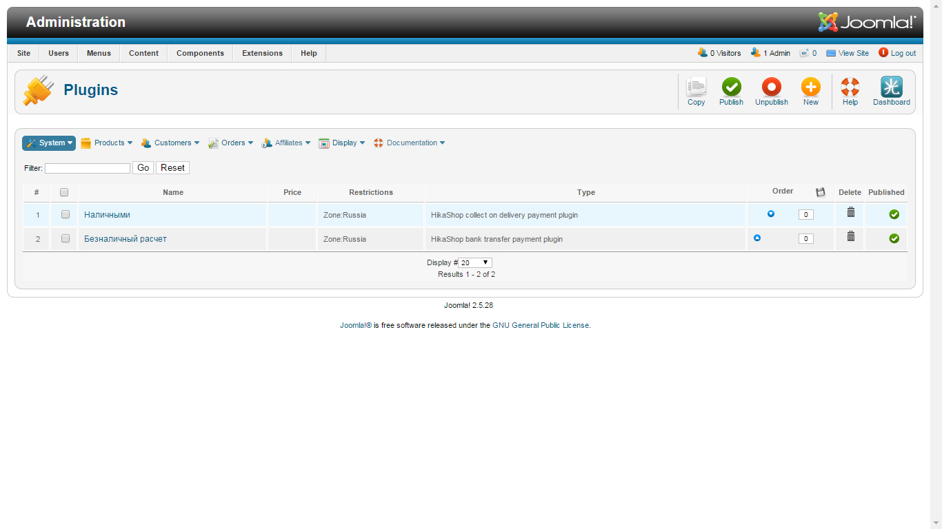

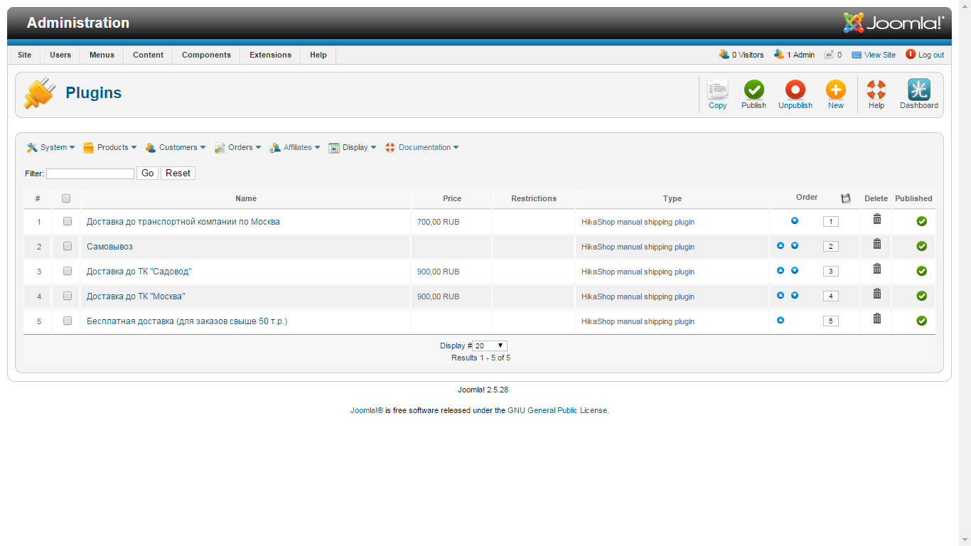

  • Posts: 24
10 years 10 months ago #209040
Hello again Mohamed!
there is some picture for you.
I hope these pictures will help you.

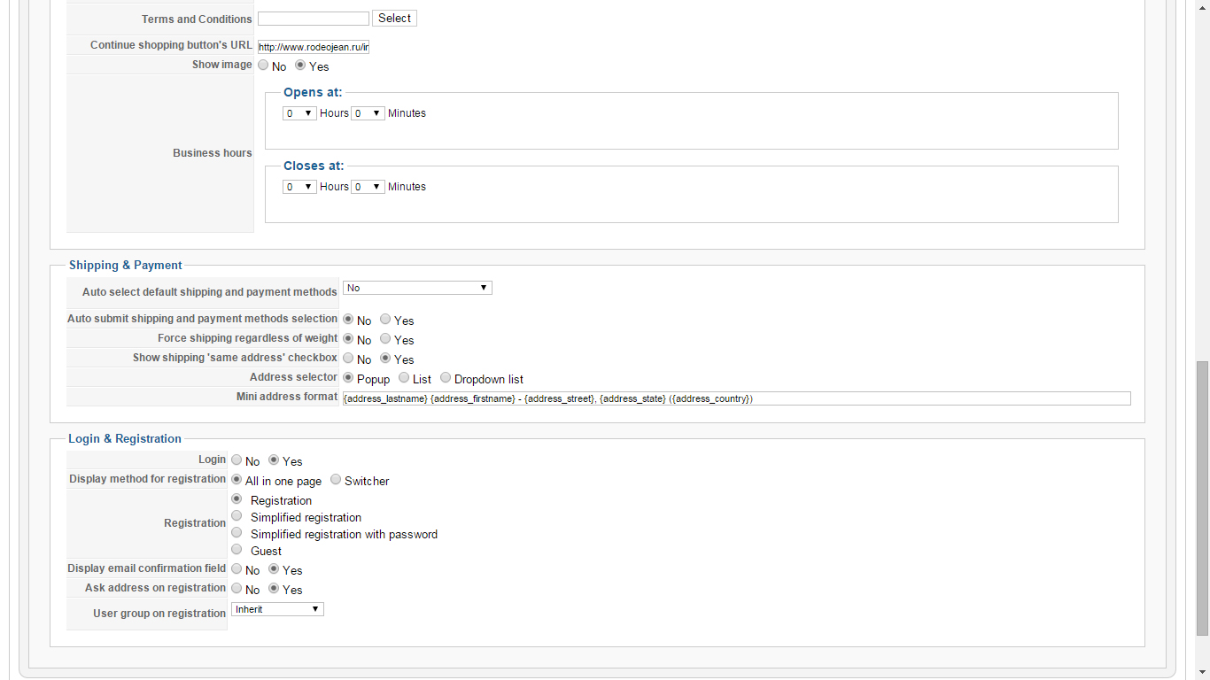

  • Posts: 26355
  • Thank you received: 4068
10 years 10 months ago #209126
Your first screenshot does not allow to see your checkout configuration.
It looks like your backend CSS file is uncompleted.
Would it be possible to know your checkout workflow configuration ? (like Mohamed asked you in the previous message).

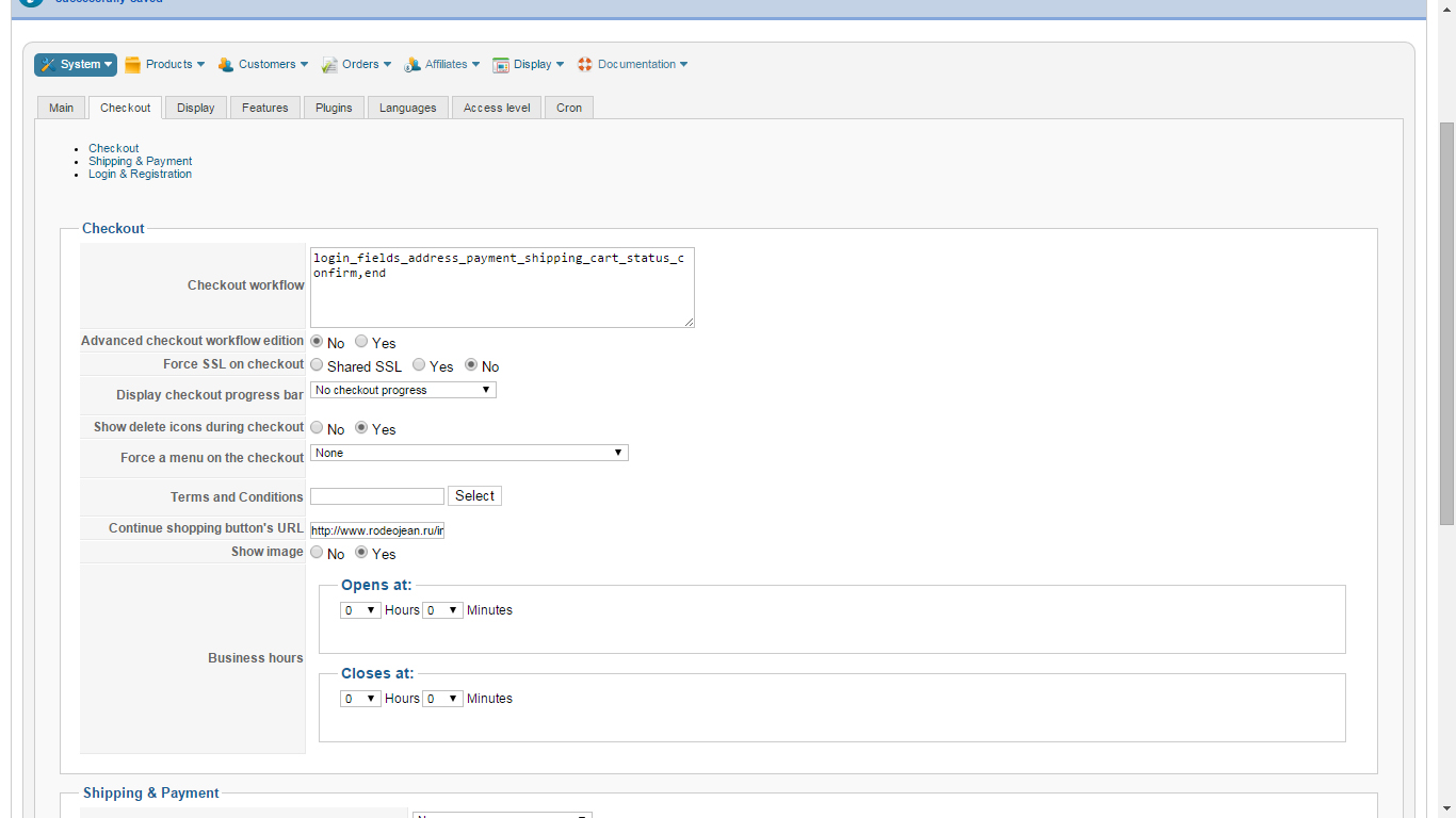

  • Posts: 24
10 years 10 months ago #209150
hi, Jerome!
there is a new picture.

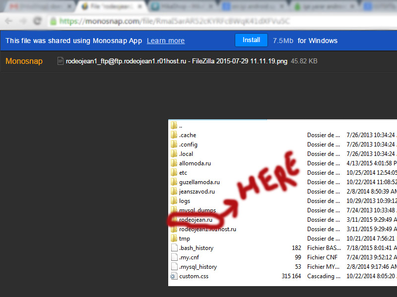

However, when trying to debug the necessary files via the FTP access you provided, the access didn't allow us to find your website files.
Here is what we see on your FTP:
take.ms/j03Fz
But there is no /home/rodeojean1/rodeojean.ru folder and we couldn't find the files of your website anywhere.
Could you also do something about it ?
  • Posts: 24
10 years 10 months ago #209991
i see in picture ''rodeojean.ru'' file wich you need.
