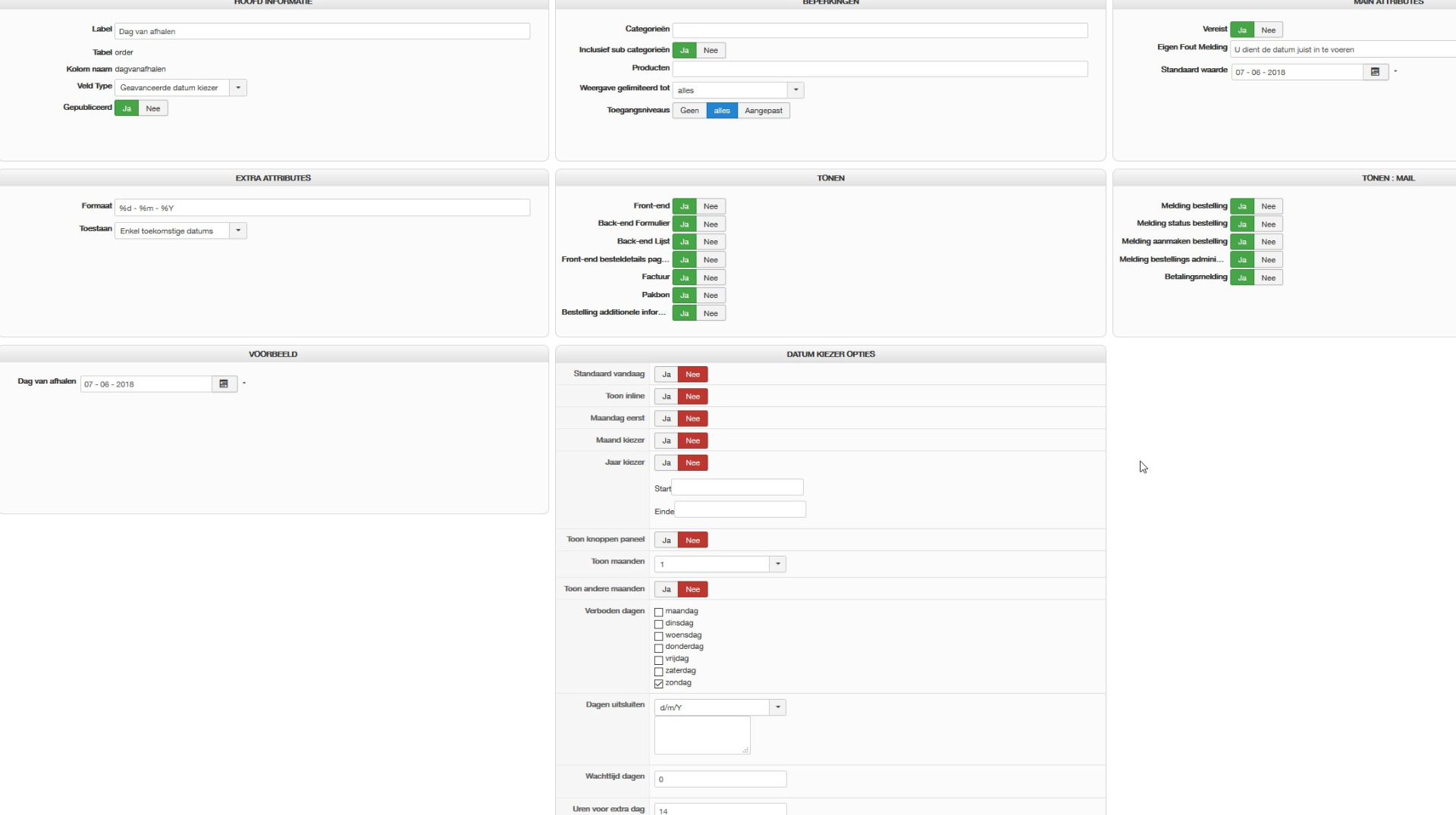

I want to set the datepicker hours for extra day in a way that the customer can pick up the order today if they order before 14:00pm .
If they order after 14:00 then the order can be picked up tomorrow.
See screenshot
The problem is after 1400 hr i still can select today
Last edit: 8 years 22 hours ago by WJ.

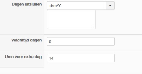

Hello Philip,
The setting i have at the moment waiting days "0"(or blanco makes no difference)
Hours for extra day 14
Allow only future dates
The problem is i can select both current day and future date, but after 14:00 pm (today) i need an extra day (after 14:00 today should not be available any more)
The situation now is that after 14:00 i still can select today.
Thanks and regards
i have reactivated the account i send you, go ahead if you like.
Last edit: 7 years 11 months ago by WJ.

I will try to do as well in the morning, but in my mind the root issue is your configuration :
- You have to remove the "Hour for extra day"
=> without this on my localhost I'm quite sure that I'm able to select current day morning and afternoon.
Keep in touch.
Last edit: 7 years 11 months ago by Philip.
  • Posts: 50
  • Thank you received: 4
7 years 11 months ago #294332
Hello Philip,
I did remove the hours for extra day and now i can select current day.
Thanks so far
