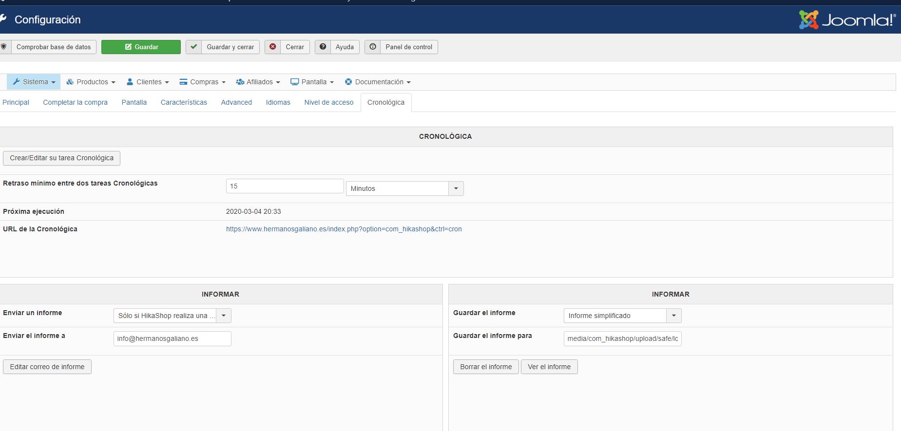

6 years 3 months ago #316232
Maybe this can leads you to the good way, but I don't see your Cron configuration of your HikaShop, from your Main HikaSHop Configuration, Cron tab :
Last edit: 6 years 3 months ago by Philip.

6 years 3 months ago #316264
Adjunto pantallazo.
¿Ves algún problema?
