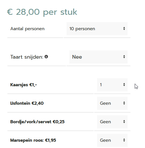

Ans asked me to have a look at her website so this is what i found in the plugin.
I don't know if this a wrong configuration of the website or a bug in the plugin, but i can't solve it by changing the options.
I have created a simple formula to explain the problem
{cart_product_quantity}*({price}+{kaarsjes})
mitz.westerbos.nl/index.php/webshop/taar...t/slagroomtaart-rond

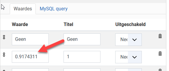

The cake costs 25.69 (28.- incl.)
A candle in this example costs 0.9174311 (1,- incl)
and must therefore be entered excluding VAT
(see 1.png)
Then I select 1 cake + 1 candle
(see 2.png)
Below that is the (wrong) price because 28 is incl. 9%VAT and 0.92 is excl VAT
This should, of course, be 28 + 1 = 29.
(see 3.png)

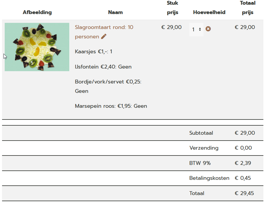

When i go to the checkout , i see the right prices and tax calculations because the Cake and the candle is calculated with 9% VAT
(see 4.png)
