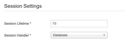

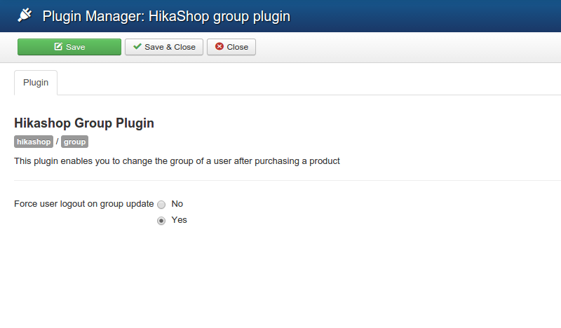

What you can do is to configure the "session handler" of the joomla configuration to "database". That way, the users session will be handled by a table of the database and the user group after purchase plugin will be able to delete the user session of the user of the order when the order is confirmed by the payment plugin receiving the payment notification from the payment gateway.

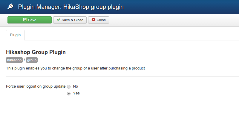

Note that this also requires that you turn on the "force logout" option of the user group after purchase plugin via the Joomla plugins manager.

Nicolas - it looks like I have everything setup to your reccoemdations already. I tried a test purchase again just to confirm that I getting the same results. Here is the documentation of the test.
Plugin settings:

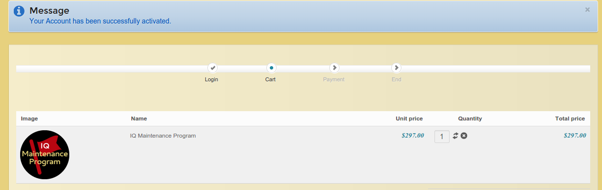

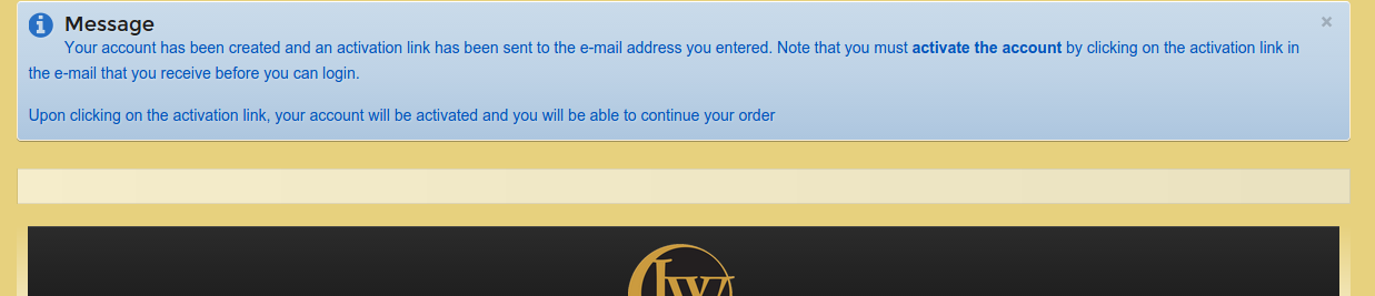

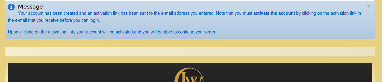

Registration of new user to complete purchase, email has been sent to new uer:
Email received, and followed link back to site to complete process:

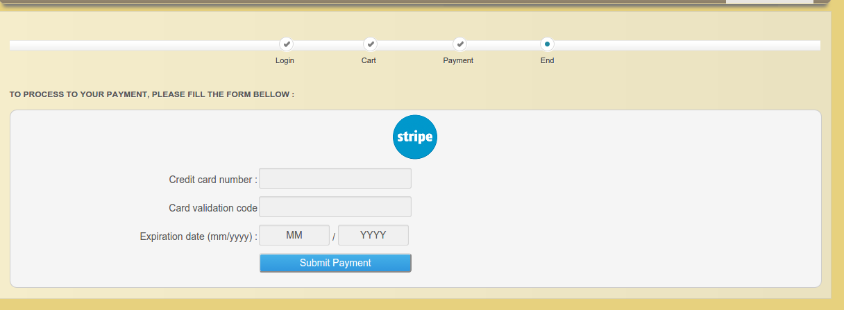

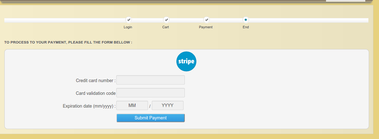

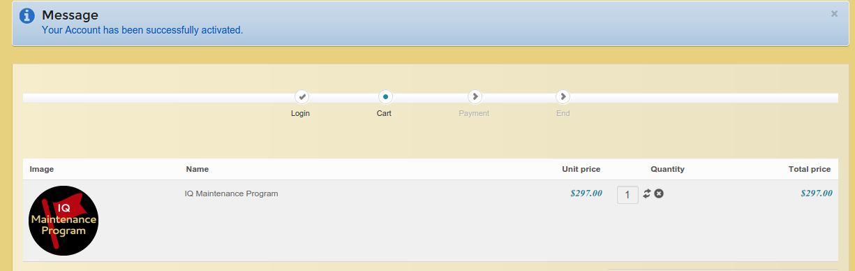

Arrived at payment step, not complete yet:
Payment not complete, checking new user group level (expect to only see "registered")
Confirmed.
Credit card entered and payment process complete:

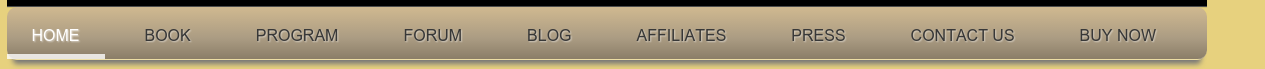

Checking menu to see new addition for "maintenance group"
not there....
At this point I can move through the website without a forced logout, and I still do not have any additional permissions.
Check user to see if there is a confirmed login:
No...

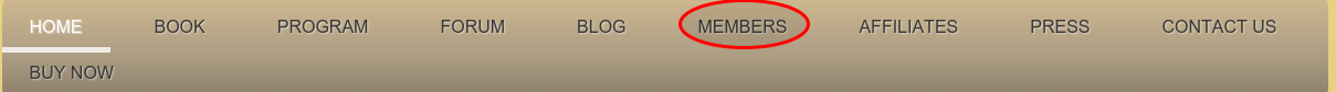

Log out and log back in to see if the menu entry exists then:
Yes (I know it went to two rows, will not stay like that live...)

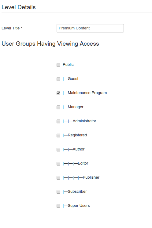

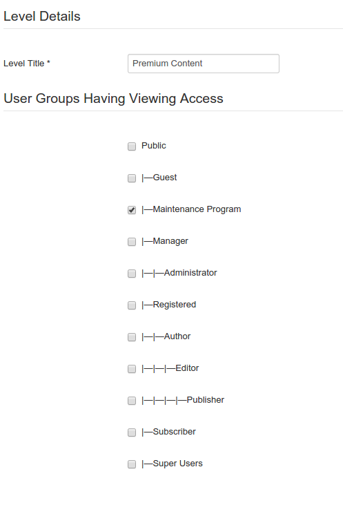

Check to make sure menu is setup right:
We already knew that user could see the menu after a re-login, just wanted you to be able to compare that stuff side by side.

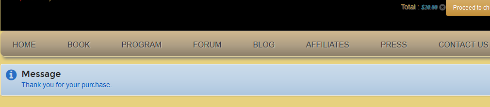

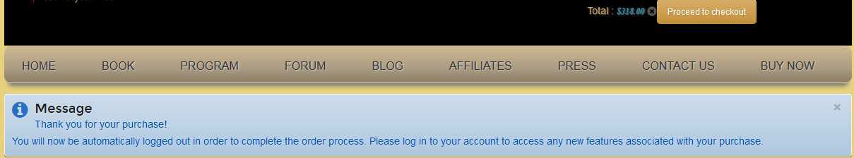

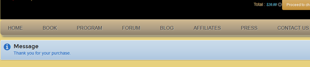

The second suggestion does work, but I end up with something showing that is shown to be in the shopping cart, but after a click on any link on the site, it disappears. Do you have any suggestions on how to get this to stop happening?
This is the screen I see after the purchase is complete:
That is not the purchase I made. It is the first item listed in the store though.
Like one of the previous users mentioned, can I modify this screen to show a message as to why they are being logged out? I might as well just tell them that this is being done on purpose so they do not immediately think something is wrong.

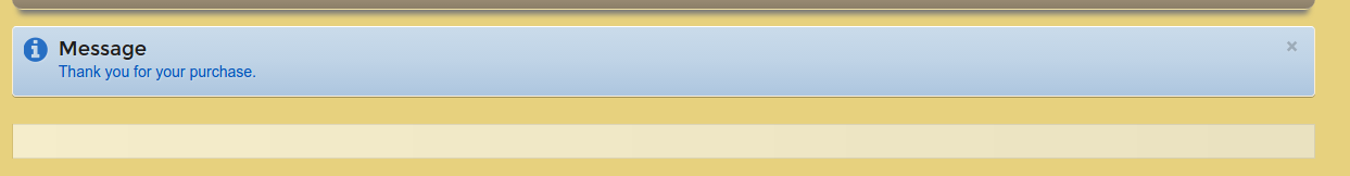

Thanks webcandy. I got the new message in there so at least they know they are being logged out. Now if I could just get the mysterious purchase to not appear in the cart after the purchase, I am hoping this is a workable option.

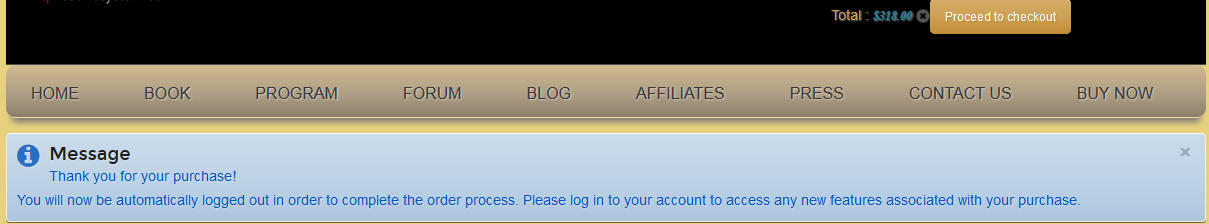

1) Refresh drops the phantom cart from the header, but I stay on the order complete site that has the new thank you message. Here is a pic to see it with the phantom cart. Check out the value in it. I just made a purchase for $297. Before it told me I had $20 in the phantom cart. I think I will go drop the site cache just in case.
