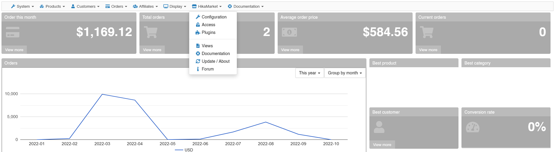

We use HikaMarket 4.1.0 and HikaShop 4.6.2 on our demo website and the vendors listing in the backend as well as the frontend login still works fine there.
You're saying that the "vendor listing is gone in the back panel". Do you mean that under the "HikaMarket main menu of the menu bar, you don't have anymore the "Vendors" sub menu ( i.imgur.com/5w2Lkwv.png ) ?

3 years 10 months ago #345274
Yes to this
"You're saying that the "vendor listing is gone in the back panel". Do you mean that under the "HikaMarket main menu of the menu bar, you don't have anymore the "Vendors" sub menu ( i.imgur.com/5w2Lkwv.png ) ?"

1. And do you see the other menu items of HikaMarket ?
Could you provide a screenshot of what you have for HikaMarket in the menu of the backend ?

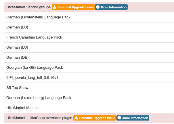

Doing the update to joomla 4.0 hika failed update checks

Regarding the "update to joomla 4.0 hika failed update checks", these are not fails. It just means that Joomla found code in HikaMarket which isn't compatible with Joomla 4. And that's normal between our extensions support both Joomla 3 and Joomla 4 with the same files. And so, in some cases with have a check on the current version of Joomla and then we run the code for Joomla 3, or the code for Joomla 4. So if you just parse the code, you will find the code for Joomla 3, but it doesn't mean that it will fail on Joomla 4 since this code won't be executed. That's why it says "Potential" on your screenshot. Basically, it doesn't know. The goal of this screenshot is not to certify whether the extension will work on Joomla 4 or not, but if it finds a potential issue, to make sure with the developer that the extension will work fine on Joomla 4. And It's been 1 year that we've advertised HikaMarket as compatible with Joomla 4 so you can ignore these "Potential Upgrade Issue" for HikaMarket.

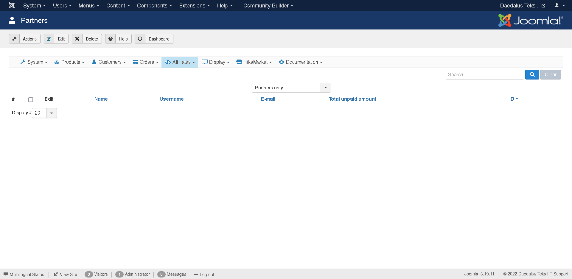

Thank you I have another note. Was the partner thing ever fixed? I saw a ticket from 5 years ago that there were bugs but we can't do anything.

3 years 8 months ago #347127
The partners listing will only display users that have activated their affiliate account. For that to happen, you need to configure the affiliate mechanism with the settings of the Affiliate section in the HikaShop configuration.
If you don't want to use the affiliate mechanism, you can just disable the HikaShop Affiliate plugin in the Joomla plugins manager and the partners menu, as well as other menus related to the affiliate mechanism will be removed.
If you do want to use it, you want to check this documentation:
