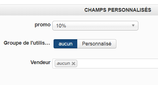

I have just installed Hikaauction, and I don't see the "Behaviour options" panel.
Where can I found it, please ?
And when I go to a product specifications,I don't have the Auction option, in Custom fields.
Can you help me, please ?
Regards.
  • Posts: 85884
  • Thank you received: 14125
2 years 11 months ago #354150
The "Behaviour options" panel is on the configuration page of HikaAuction. You can access it via the menu Components>HikaAuction>Configuration in your Joomla backend.
The Auction options are not under the custom fields area on the product edit page. They are under the "auction" area:
i.imgur.com/kHUcRxP.png
Note that as per our changelog ( www.hikashop.com/support/documentation/3...ction-changelog.html ) version 3.2.1 of HikaAuction requires HikaShop 4.4.4 minimum to work properly.
You won't be able to make it work properly with HikaShop 2.6.4

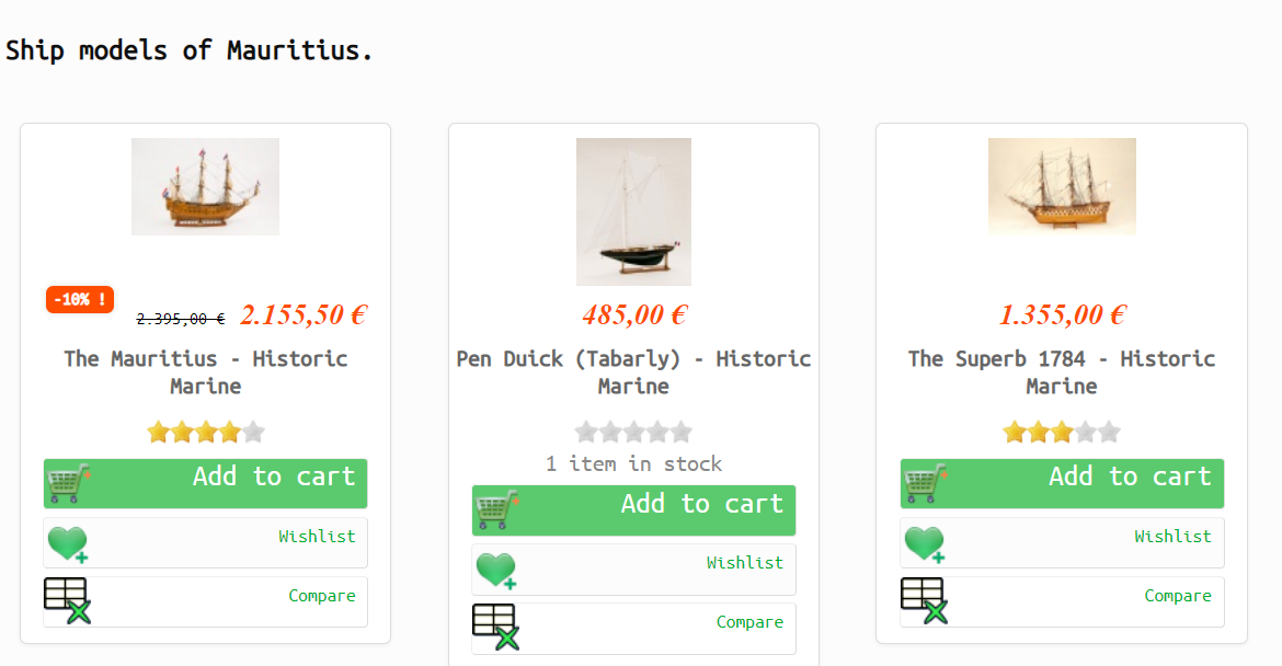

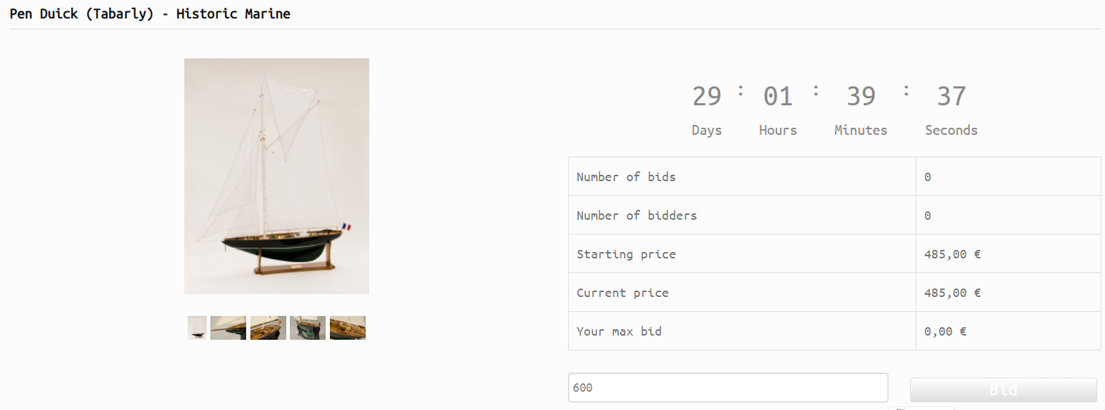

I installed Hikaauction 1.2.1 but I have some issues.
On the products list, the "Add to cart" button remains displayed (see Penduick ship model).

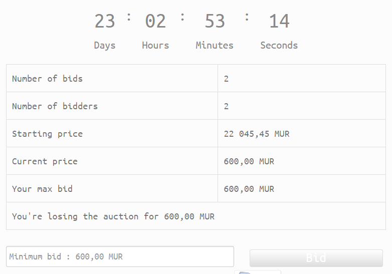

On the product page, when I enter an amount and click on Bid, nothing happens. And the bid is not registered (see attached files).
Can you help me please ?
Thank's.

The issue on the listing is because your version of HikaAuction and HikaShop don't support dynamically changing the add to cart buttons on listings. This was added in HikaAuction 3.1.0 and HikaShop 4.4.3.
With your version of HikaShop and HikaAuction, the only solution would be to turn off the display of add to cart buttons on listings.

Is it possible to turn off the display of Add to cart button for a category or a product ? If yes, how ?

2 years 11 months ago #354382
The issue with the bid button comes from a javascript error on have on that page:
i.imgur.com/xeDGeSB.png
This prevents the javascript of HikaAuction from being properly initialized, leading to the button not responding properly.

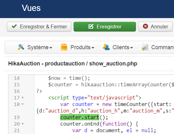

So I've investigated this javascript error, and it comes from HikaAuction's javascript not finding HikaShop's when first initializing itself for some reason. In the file productauction / show_auction, it has the code:
window.hikashop.ready(function(){
			counter.start();
Replace it to just:
counter.start();
via the menu Display>Views and it will prevent this particulat javascript error, without changing the behavior of the counter system. That should in turn allow HikaSerial to initialize itself and the bid button should then work properly.
Regarding the display of the add to cart button on listings, you can hide them for only one category.
For that, you can add such CSS code on your website:
.hikashop_category_listing_xxx .hikashop_cart_button{ display: none; }
where xxx is the id of the category.

2 years 11 months ago #354389
I update the file productauction / show_auction as you said (see attached file), but it doesn't work. ( www.mauritiusproducts.com/en/categories/...arly-historic-marine )
However, I also added CSS code to hide "Add to cart" button for a category, and it works fine ! ( www.mauritiusproducts.com/en/categories/category/142-encheres )
Thank you for that.
Do you have another suggestion for the "Bid" button ?
Regards.

No. The javascript error is gone on the page, but the button is still not firing the javascript of HikaAuction to generate the bid.
I only see the GA code being fired.
I would need a backend access in order to look into it.

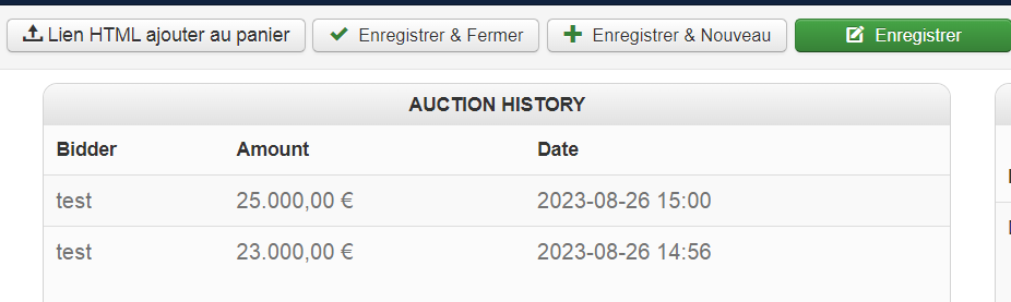

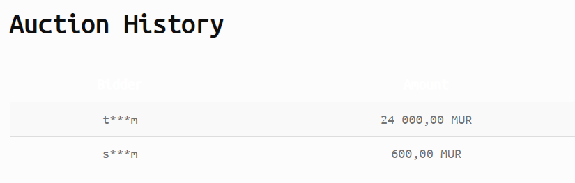

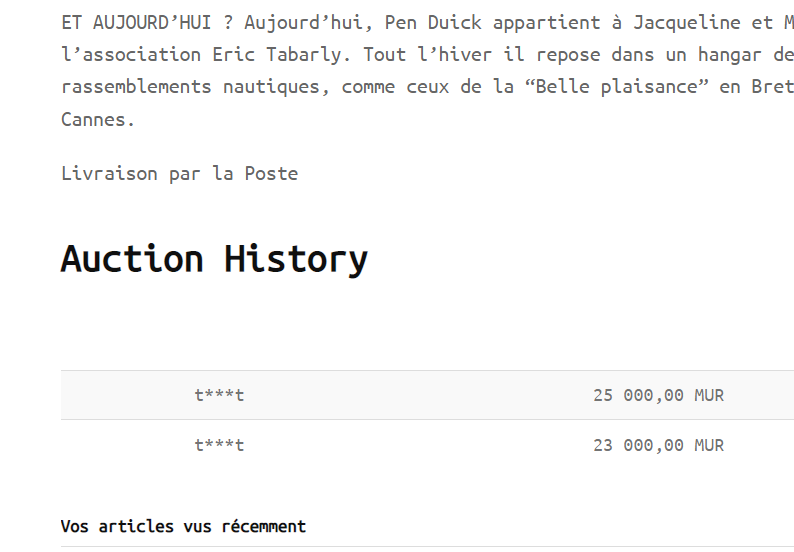

But, there is another issue, when the bids were done with different currencies, amounts are not always converted (see attached files).
Regards.

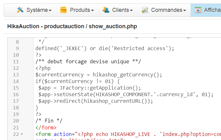

What you can do is to add that code at the beginning of the productauction / show_auction view file:
<?php
$currentCurrency = hikashop_getCurrency();
if($currentCurrency != XX) {
 $app->setUserState(HIKASHOP_COMPONENT.'.currency_id', XX);
 $app->redirect(hikashop_currentURL());
where XX can be replaced by the id of the currency in the System>Currencies menu.
That way, it will force the currency on the auction products.
  • Posts: 96

I added the code on the productauction / show_auction view file, but I didn't get the result I wanted (see attached files).
I expected prices to be displayed in euros on the product page, and so on the auction history, even if the customer chooses another currency.
Is it possible to get that, please ?
Thank's.

I think you want to use "1" not "01".
However, it should normally not change anything.
I tried to access your previous links but it didn't work at all:
i.imgur.com/8V5GG9m.png
Could you provide the URL of an auction product page in order to check the situation ?
