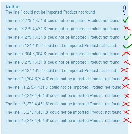

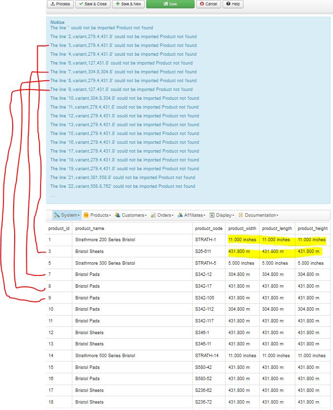

12 years 11 months ago #125856
Hi Xavier,
Thank you for the update, that has fixed the display issue but I still have the problem on csv import that I am getting a notice that says some products can not be found when they do actually exist, they are even listed in the report at the end of the mass action.
See attached screen shot. The red crosses mark lines in the notice that I think are incorrect as the products do exist.
I have attached the csv file I am using and will also pm you login details to the site on my development server as these have changed.
Thanks again for the excellent support.
Ian

12 years 11 months ago #126050
Thanks for your reports, it allow us to improve our features.
I have corrected many things about this importCsv, this will be in the next release.
To correct it now, thanks to replace the function "getFromFile()" in "administrator/components/com_hikashop/classes/massaction.php" by:
