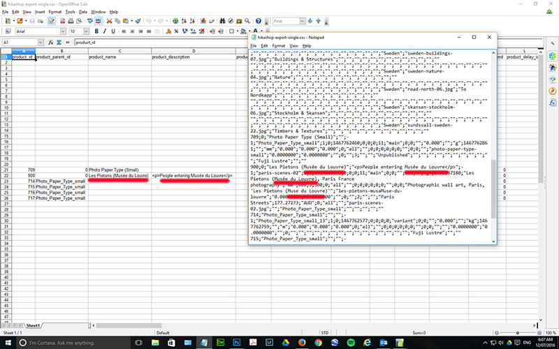

Hi Nicholas, I thought I would do a retest.
First image is the file with the exported product that with the accented characters corrected in the backend. You can see that in both OpenCalc and notepad that characters are as expected.

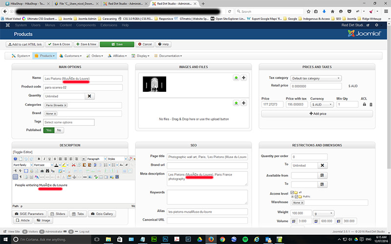

The second image is the product after the same file above is imported (unopened, unsaved, as it was exported)
