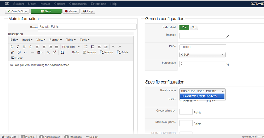

  • Posts: 80
9 years 4 months ago #266519
Please, find atttached the screen of the Hikashop Payment with points plugin. I don't see any option for AltaUserPoints / AlphaUserPoints. The installation of the AltaUserPoints component is done right, I have already checked that it's working by rewarding points to new registered users. But I mentioned a wrong version of the Hikashop I use, it's 2.5.0 and not 3.0.1
  • Posts: 86042
  • Thank you received: 14174
9 years 4 months ago #266557
AltaUserPoints didn't exist when HikaShop 2.5.0 was released. So it's normal that you can't select it in that setting.
You'd have to udpate your HikaShop in order to be able to use it.
