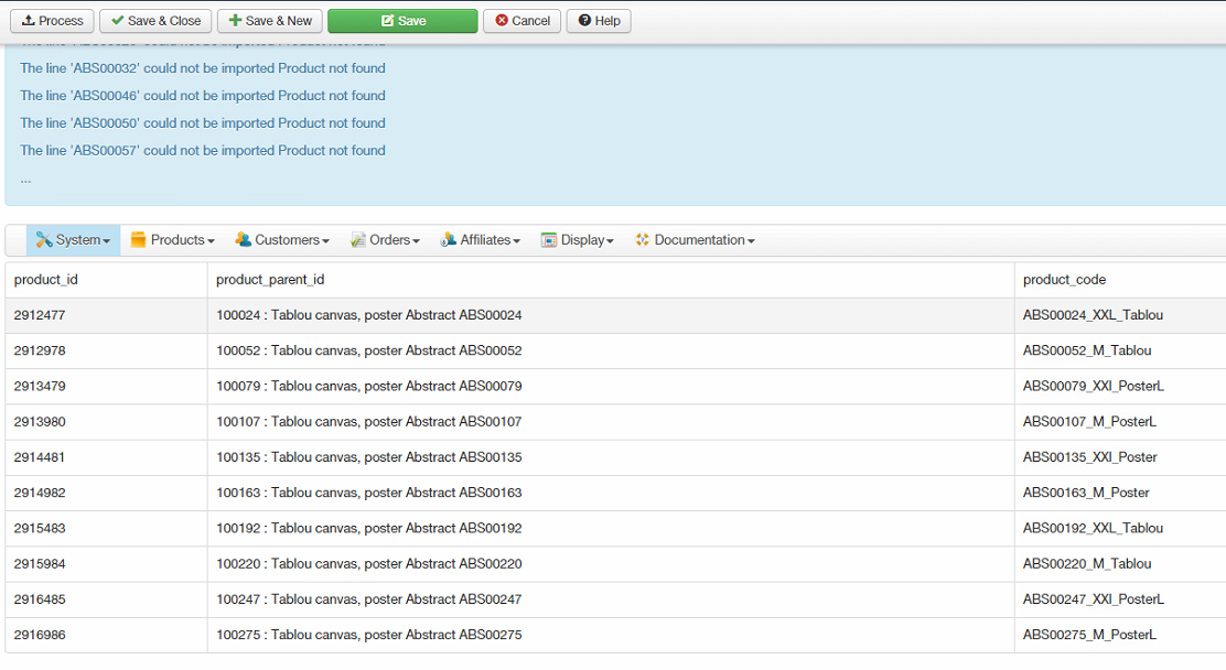

11 years 9 months ago #177607
Indeed, now the speed is not an issue - everything works fast.

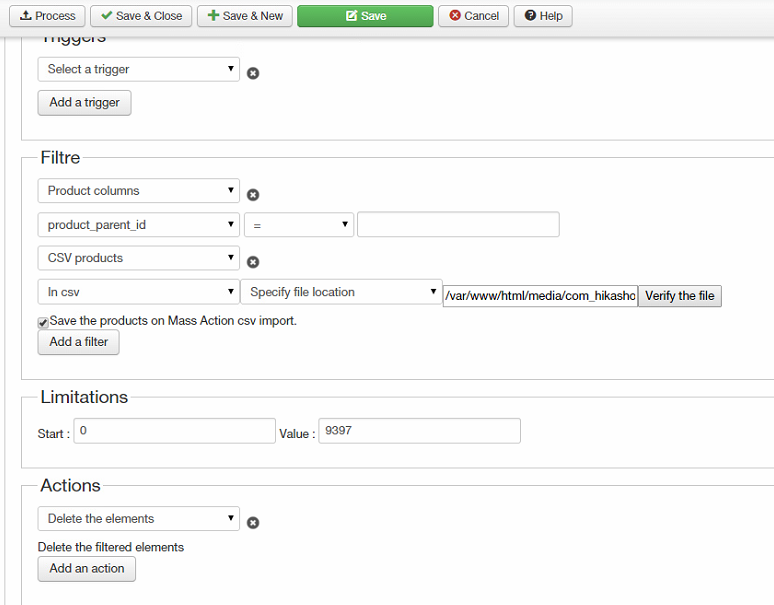

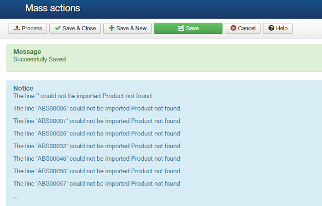

I created a new mass action and you can see the settings - printscreen.
Also you can see the result in the error.png attachement.
I changed the mass action filter to not delete but to show the results. It gives the same error but it also gives me a table below. I attached for this display-products.png
in this image you can see how the app shows the product_parent_id - as a long string, not just the codes in blue above (which are in my csv).

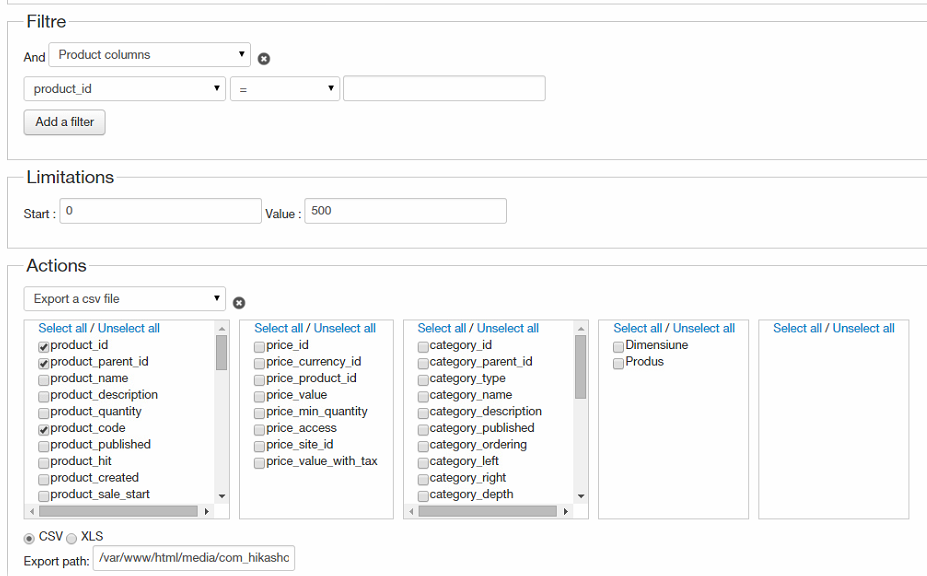

I created another mass-action, to check the correct product_parent_id. You can see the filter attached: export-products.png
This created the csv attached: export.csv
In this export you will see that product_parent_id is the same as in my filter csv - the format ABS00024 for example. Not as it appears in display-products.png
Please help me sort this out - it is really getting on my nerves, it should be something easy to do and I just can't get passed it. I left the actions there, the one set up to delete the products is named ID-to-delete.
11 years 8 months ago #177736
Please uncheck the option "Save the products on Mass Action CSV import".
This option allow to add the products in your shop, but in your case the products are already in, and needs to be deleted.
Having the full name in display-products.png is normal, to be more understandable we display the product full name, but we check only it's code.
If unchecking the option is not enough, please tell me and on Monday I will go back on your extplorer in order to debug that.

This is how my csv starts now. And it's not product code it's product_parent_id.
I exported using mass action and it is exactly the same as my imported file now.
Are you sure all settings are correct in the mass action? Because the error is all mentioning "could not be imported Product not found".
