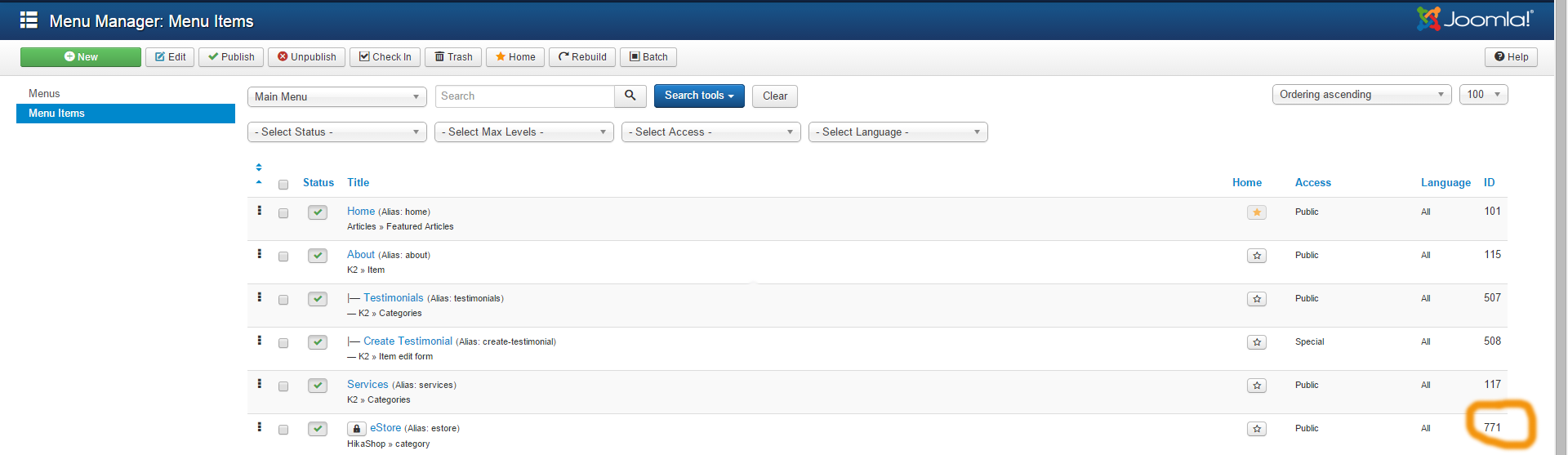

I also checked my menu entry id for hikashop and it is 771 but when i click on checkout it shows me
http://websitename.com/component/hikashop/checkout?Itemid=721

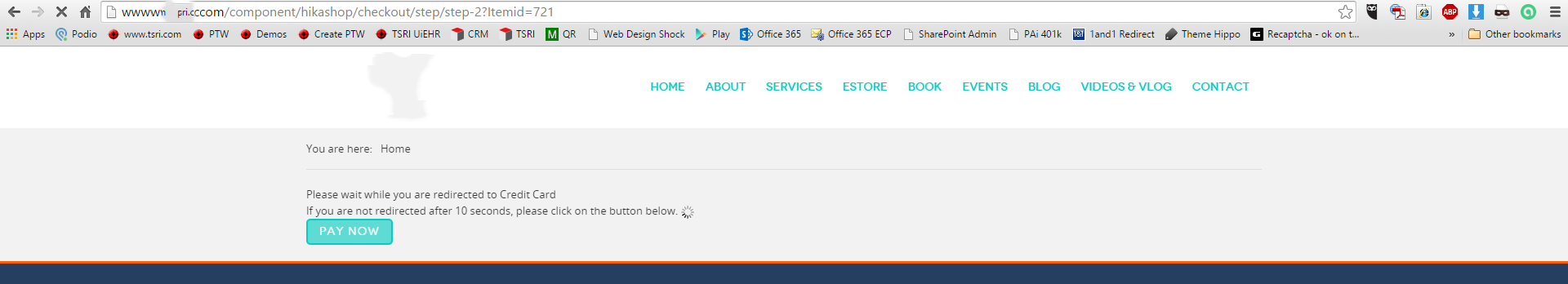

  • Posts: 31

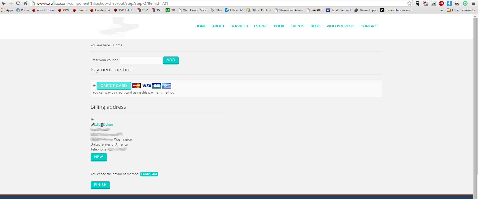

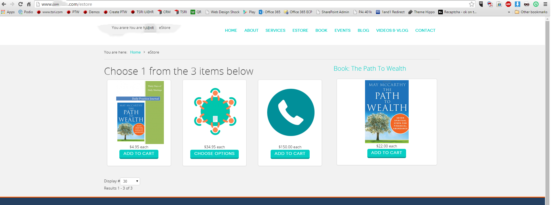

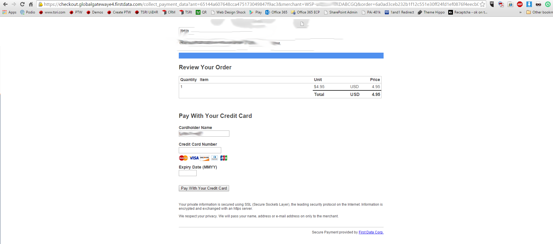

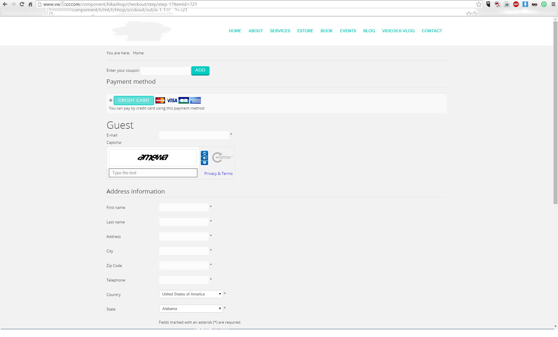

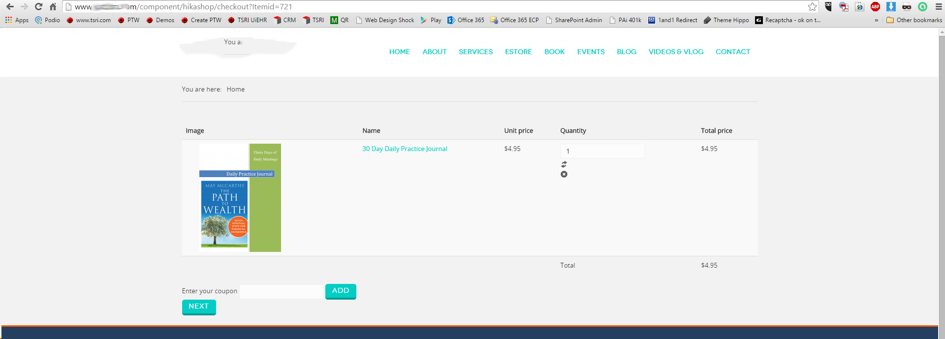

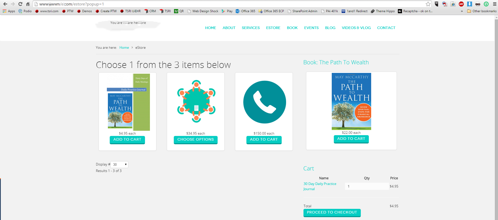

11 years 4 months ago #194372
Here is what it looks like when I buy something at my store:

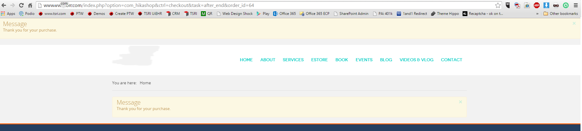

  • Posts: 31
11 years 4 months ago #194374
After I click on the link, I get redirected back to the regular thank you page.

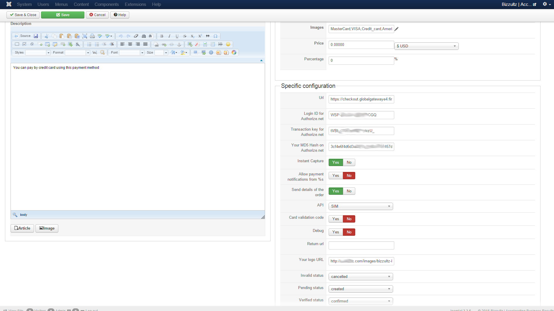

Here is a view of my plugin, with %s set to no.

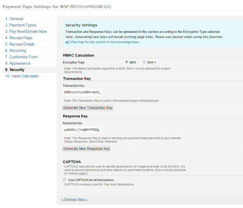

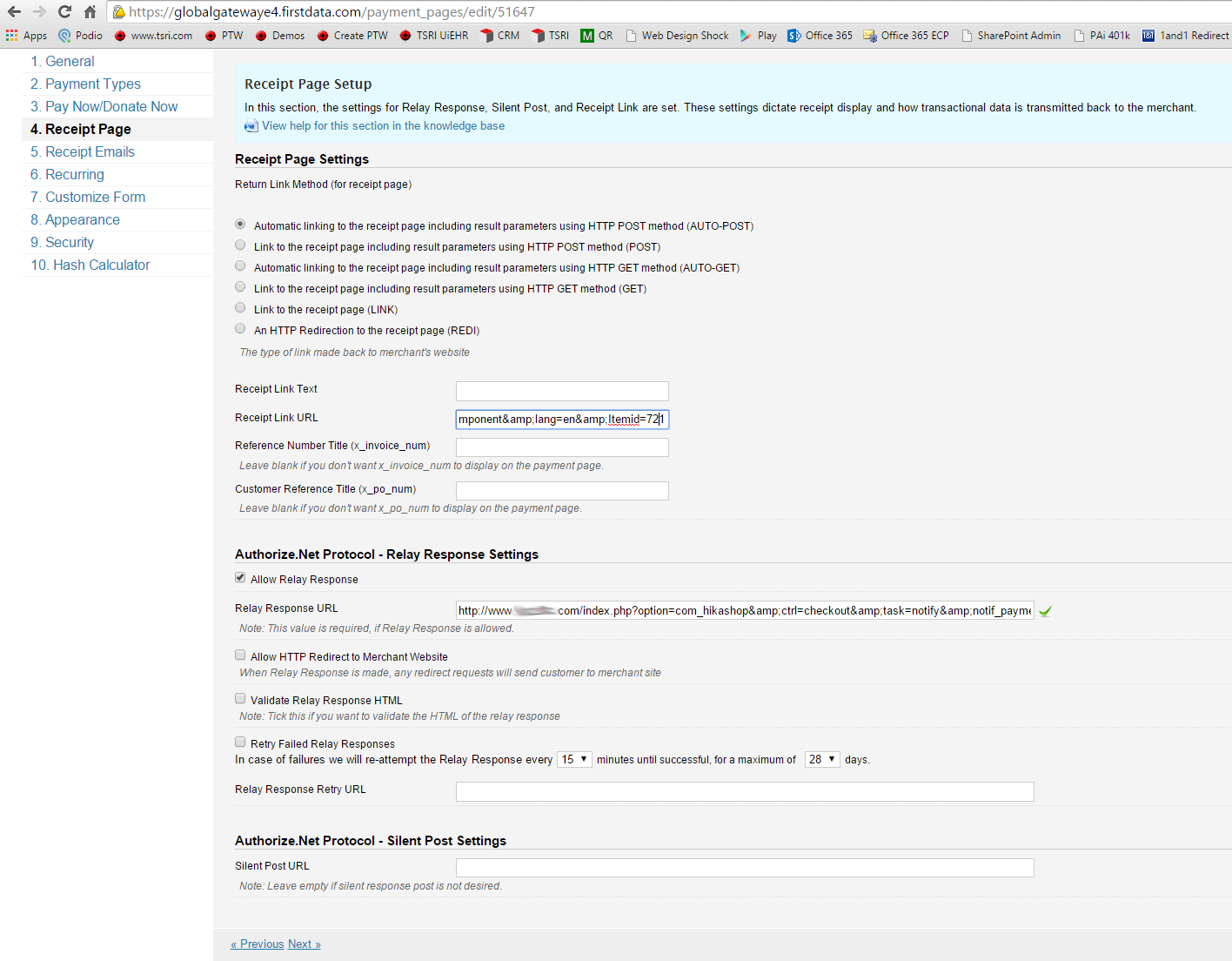

This is the payment settings pag ein FirstData
This is the security page in FirstData
This is the Hash Page in FirstData
Please note the response and relay URL are the same with the item id 721
here is the joomla menu manager with eStore being the store item

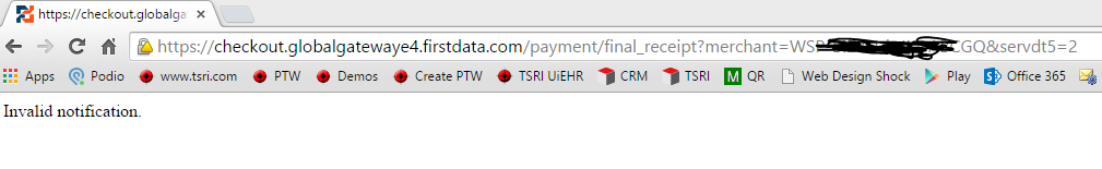

  • Posts: 31
11 years 4 months ago #194538
When I enable it, I get the following error from FirstData in an email:
x_relay_url : Invalid x_relay_url. Must be the same as configured for the
payment page

When I disable it I get paid but not response back :(

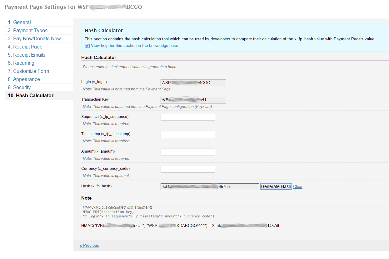

  • Posts: 31
11 years 4 months ago #195031
Good and bad.
Ok so I took of the www on all links in first data and i changed the item id to 771, I also turned on allow notification from %s which allowed me to go through to firstdata without an error. Now the problem is coming back to the site i get an error. The payment also went through successfully but I got a page back that says: Invalid notification.
My card was charged but the order shows up as cancelled in hikashop.
I read on another posts to check my hash id, but they match just fine.
  • Posts: 31
11 years 4 months ago #195070
I just received a hikashop error:
An Authorize.net notification was refused because the response from the Authorize.net server was invalid. The hash received was 2c29xxxxxxxxxxxxxxxxxxxx8fc2 while the calculated hash was 662FCxxxxxxxxxxxxxxxxxxxxxxx36A42. Please cehck that you're set the same md5 hash key in Authorize.net and the plugin
But the hash it shows in first data is this one: 3cf4e6f4dxxxxxxxxxxxxxxxxx1457db
Which is also the one I have in the payment plugin...
What is going on?! I just want it to work and am growing frustrated...
Do I have to regenerate some kind of token every time i change the reciept url or what?!

One setting I have different from you in my HikaShop's Authorize.net plugin settings is I have "Allow payment notifications from %s" set to Yes.
I also don't set the logo URL as I found I could set that in FirstData's end and I don't think it worked any ways.
I've reviewed my FirstData setup and other than the Relay Response URL I've already mentioned above, everything looks the same.

11 years 4 months ago #196796
wldworks: Yeah, I hat that problem with the hashes not matching too during my original testing/setup last year.
Actually I think I see what you might have done wrong. You used the Firstdata Hash Caculator to generate the "Your MD5 Hash on Authorize.net". That is NOT correct.
That is just a test calculation for debugging. You would manually enter the price, etc. and it would generate a value that you could then compare to what Hikashop generated. You don't need to do that at all.
The value you should enter into HikaShop Authorize.net plugin's "Your MD5 Hash on Authorize.net" is under FirstData's Payment Page's #9 Security -> Response Key. It is just below the Transaction Key.
That was one thing I had in my write notes as the key discovery. I made that same mistake last year when I was doing my original setup. The labeling is what is confusing (neither side matches the others) and I discovered it via trial and error and a hunch.
