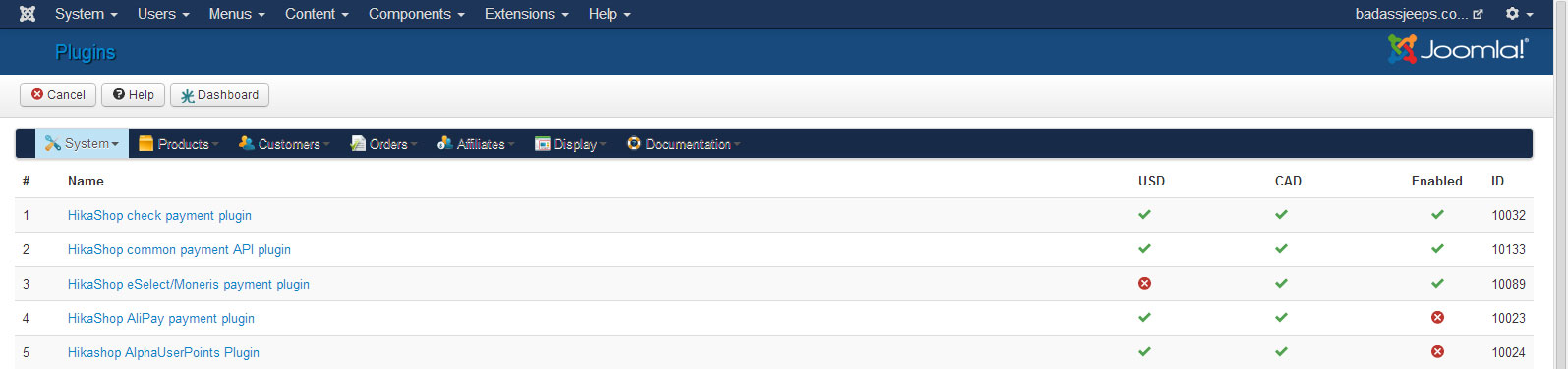

I think I may have found an issue:
When I went to create a new payment method, take a look at the attached screenshot. Notice how on the moneris eselect payment method that USD is disabled? I can't seem to enable that and am not sure where I make that change. Both CAD and USD currencies are enabled in the currency menu, so not sure where else this needs to be changed.

Yes, the eSelect plugin is not available for the USD currency. That's because the eSelect payment gateway doesn't support that currency and thus it is blocked by the plugin so that it doesn't generate an error when going to the payment gateway.
You can unblock that by editing the file plugins/hikashoppayment/eselect/eselect.php and changing the line:
var $accepted_currencies = array( 'CAD' );
but if the payment gateway doesn't support the USD, it won't help as it will just display the same amount but in USD instead of displaying it in CAD which is not what you want.
