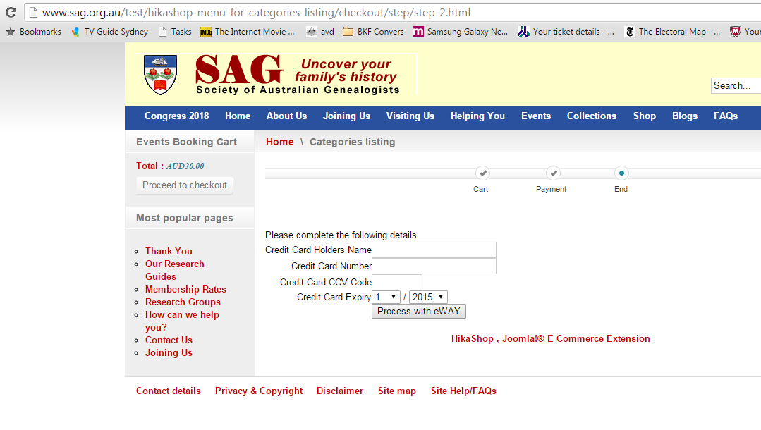

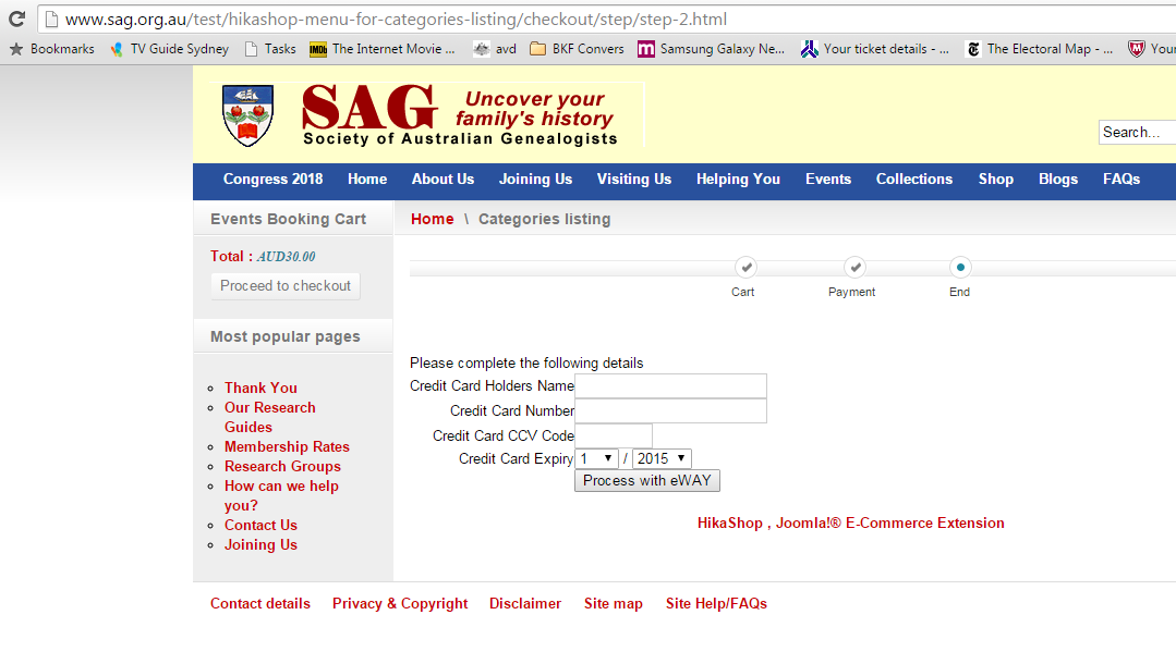

For the J2.5.28 live site, I was reluctant to uninstall the original Hikashop eWay payment plugin in order to test the eWay Rapid plugin. So I have created a new mirror J2.5.28 test site and there I have uninstalled the original Hikashop eWay payment plugin and installed and activated the eWay Rapid plugin you provided above.
Installed fine, and no errors. However on Hikashop Checkout Step 2 it asks for credit card details while still on our site - see attached. It does not take the user to the eWay server to take the credit card details as expected and wanted. Am I missing something obvious?

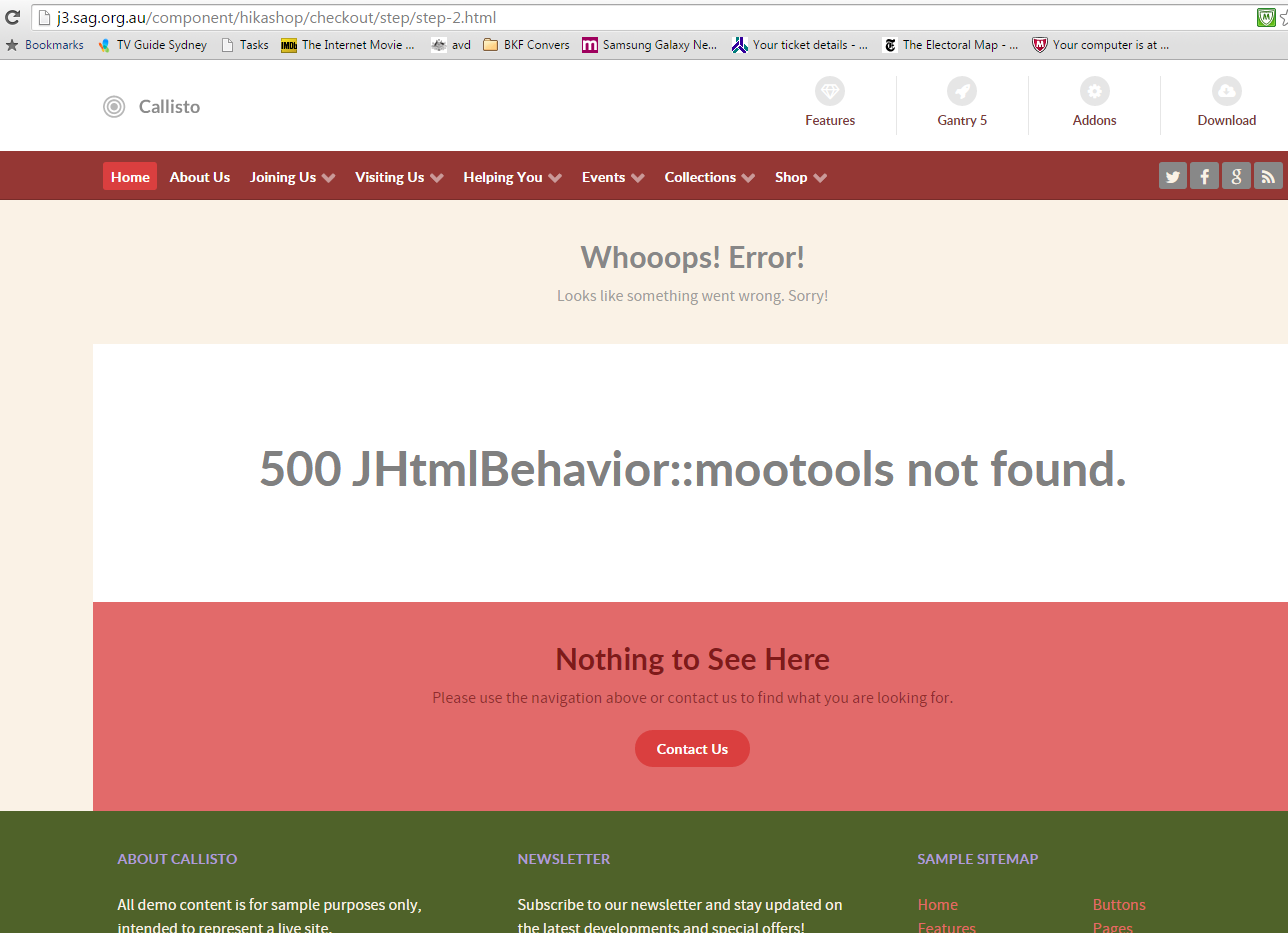

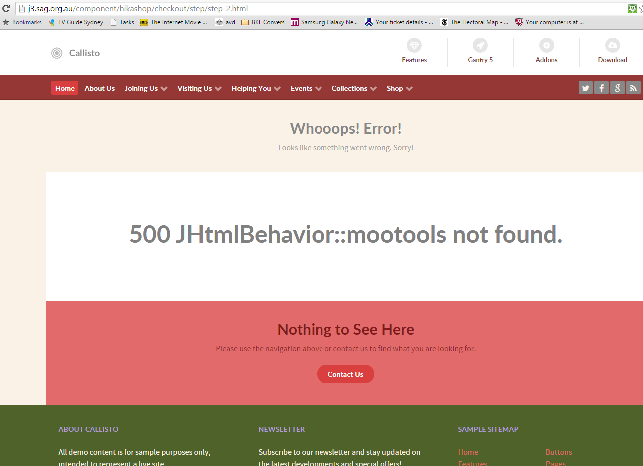

Also on the j3.4.3 version RocketTheme provided a fix to their template framework, and now a test transaction comes up with a different error (see attached).
The link on the contact us button was " j3.sag.org.au/component/hikashop/checkout/step/step-2.html# ".
To me this suggests the eWay Rapid plugin (or Hikashop itself) is looking for mootools which is not installed on the J3.4,3 site. Is this how you read it?

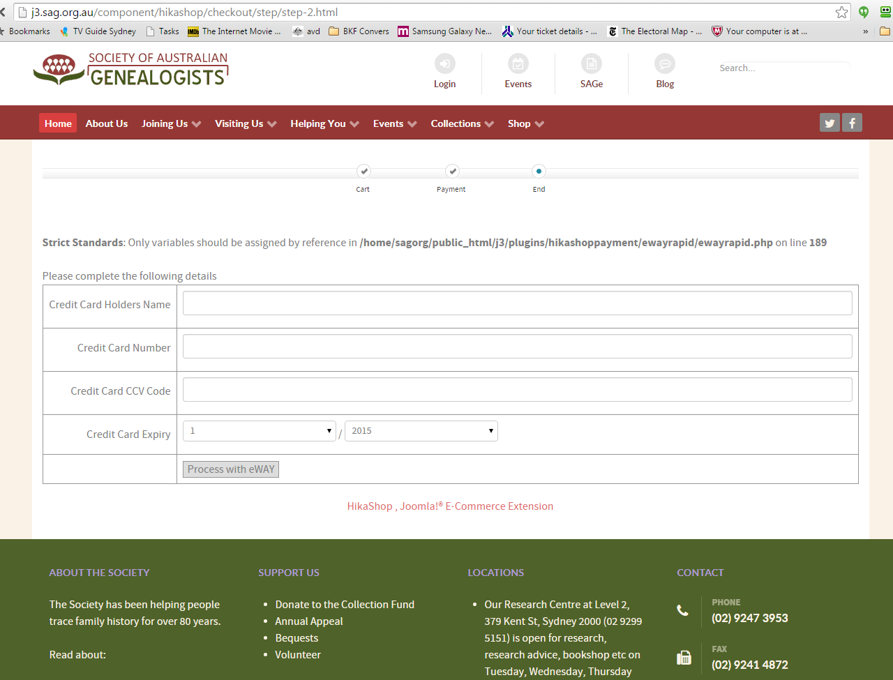

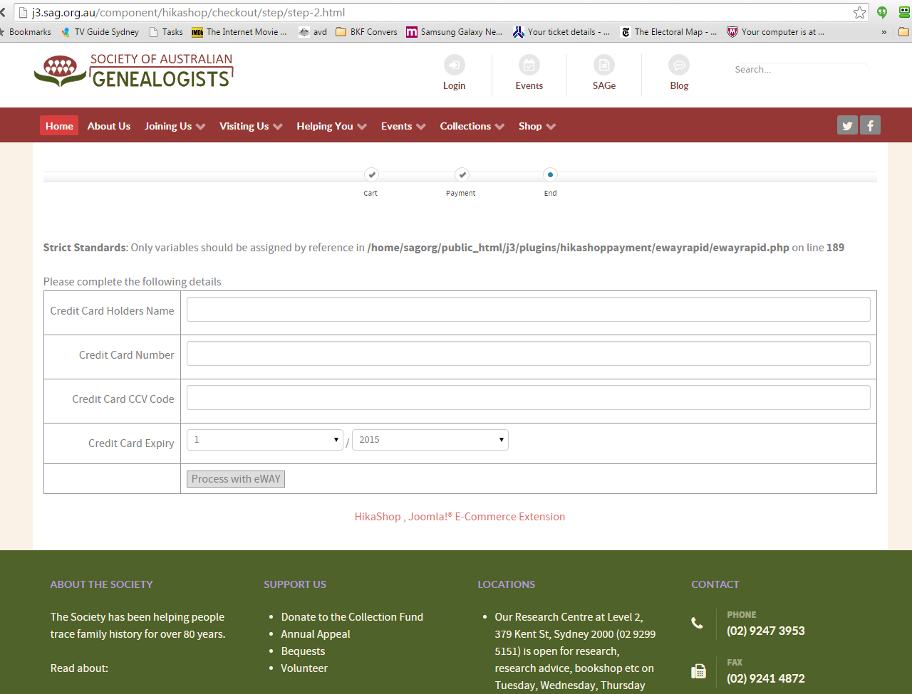

On the J3.4.3 site, I have changed j3/plugins/hikashoppayment/ewayrapid/ewayrapid.php line 220 from JHTML::_('behavior.mootools'); to JHtml::_('behavior.framework'); following advice on another forum to ensure that the plugin loads the mootools library. With this a test transaction managed to get past the error message and now asks for credit card details - but still on our site rather than at the eWay server. See attached.
So it is in the same position as the problem on the test J2.5.28 site.
What am I missing? How does one get the plugin to take the user to the secure eWay server for the input of credit card info?
