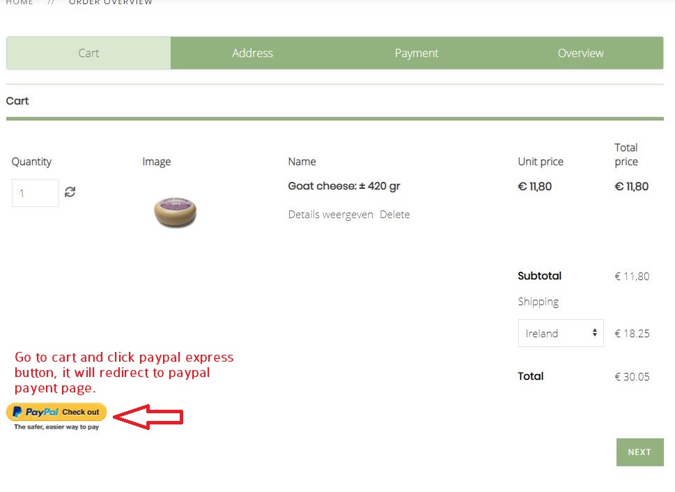

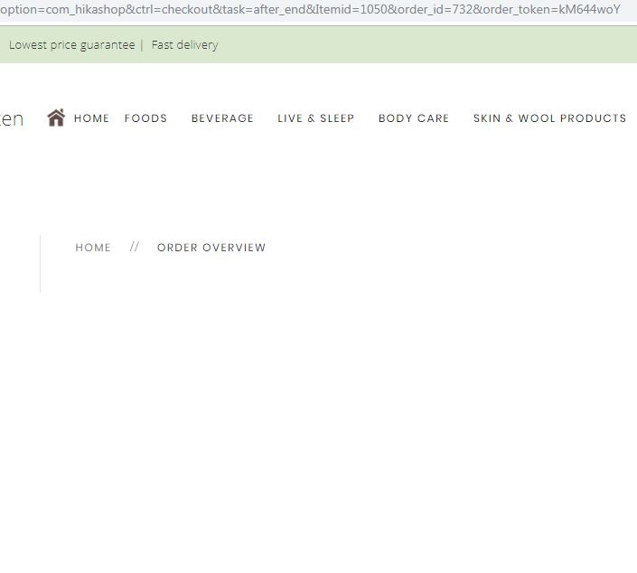

Hi, thank you for your quick reply.

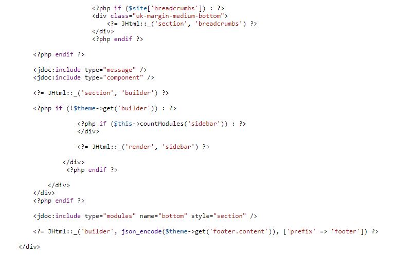

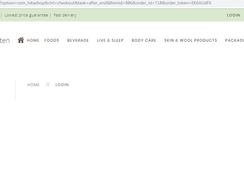

Only the main area is blank. Photo below is the overview page. It seems like return to login page.
<jdoc:include type="message" /> is already located in the index.php.
What should be the problem?
Hope top hear from you soon.
Thank you.
Jern

It's strange that this main area is blank. If you're on a login form page, then you should see the login form of Joomla. I suppose that there is some customization (of you or your template) hiding that form on that page.

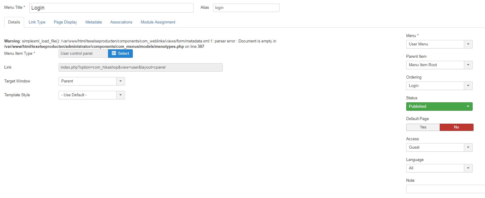

From what I understand, with the additional information you provided, your issue seems to be that Joomla finds that you don't have the right to access the current menu item as you're not logged in.

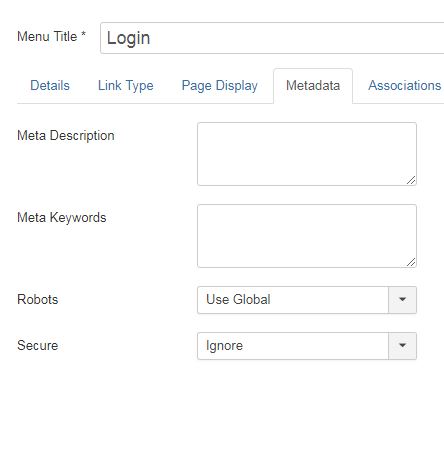

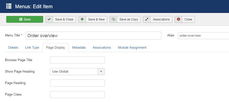

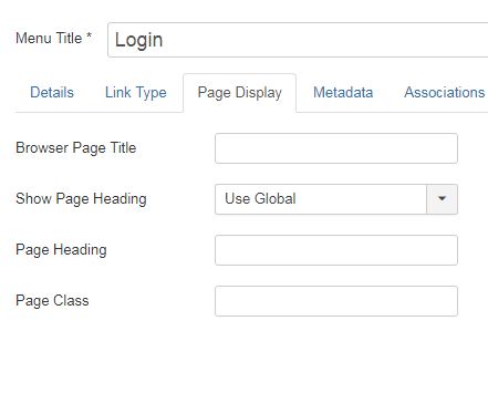

As you can see in the URL of that page, the menu item used is the one with the id 886. So first, I would recommend to check the settings of that menu item. Could you provide screenshots of the different settings of that menu item ?

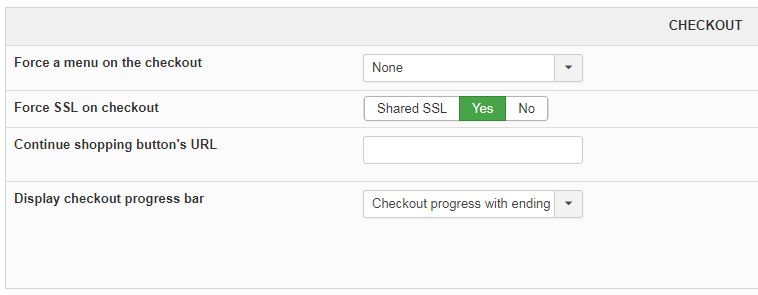

Normally, the menu item used when coming back to the shop is the same as the one you had when you left the shop, which, if it was the checkout, can be controlled with the "force a menu on checkout" setting of the HikaShop configuration.
So it would be great to check on that setting too. How is it configured ? And if you change it to a public access menu item, does it help ?
And finally, since the issue is related to the user not being logged in, how is your checkout process ? Did you login/registration before paying ? Did you go through the checkout in "guest" mode ? Or did you skip the HikaShop checkout completely by going through the "checkout with PayPal Express" button on the cart in order to bypass the checkout ?

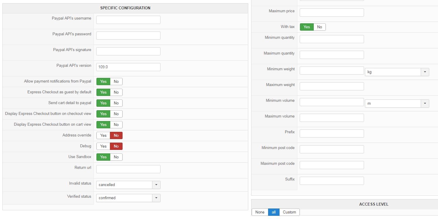

Could you provide screenshots of the settings of your payment method and of the settings under the "checkout" tab of the HikaShop configuration ?

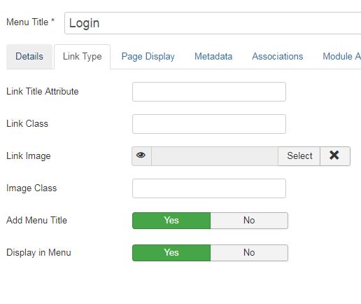

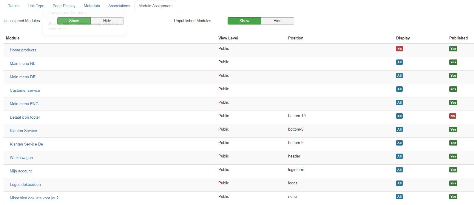

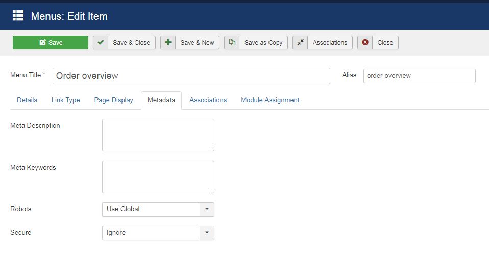

1. Screenshoot menu-item
2. Change to public access menu item, but it doesn't help.
3. Force a menu on checkout screenshot, settings under the "checkout" tab.
4. I did paypal express checkout, it skip the HikaShop checkout completely and direct to paypal payment.

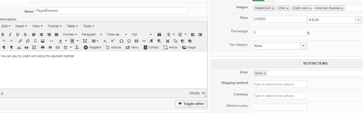

5. Screenshots of the settings of payment method for paypal express checkout. *I remove paypal API details.
These are the settings. Any clue why is that?

7 years 3 months ago #306336
You should configure a public menu item of the type "HikaShop checkout" (if you don't already have one) and select it in the "force menu on checkout" setting. If you don't want it to appear on your website, you can assign it to a hidden menu.
That way, the PayPal Express checkout will use that menu item upon return to your shop instead of the "login" menu item which it selects automatically and isn't well suited in this case( it's a "guest" menu item for the cpanel, which redirects to the Joomla login form as it requires the user to be logged in, etc).

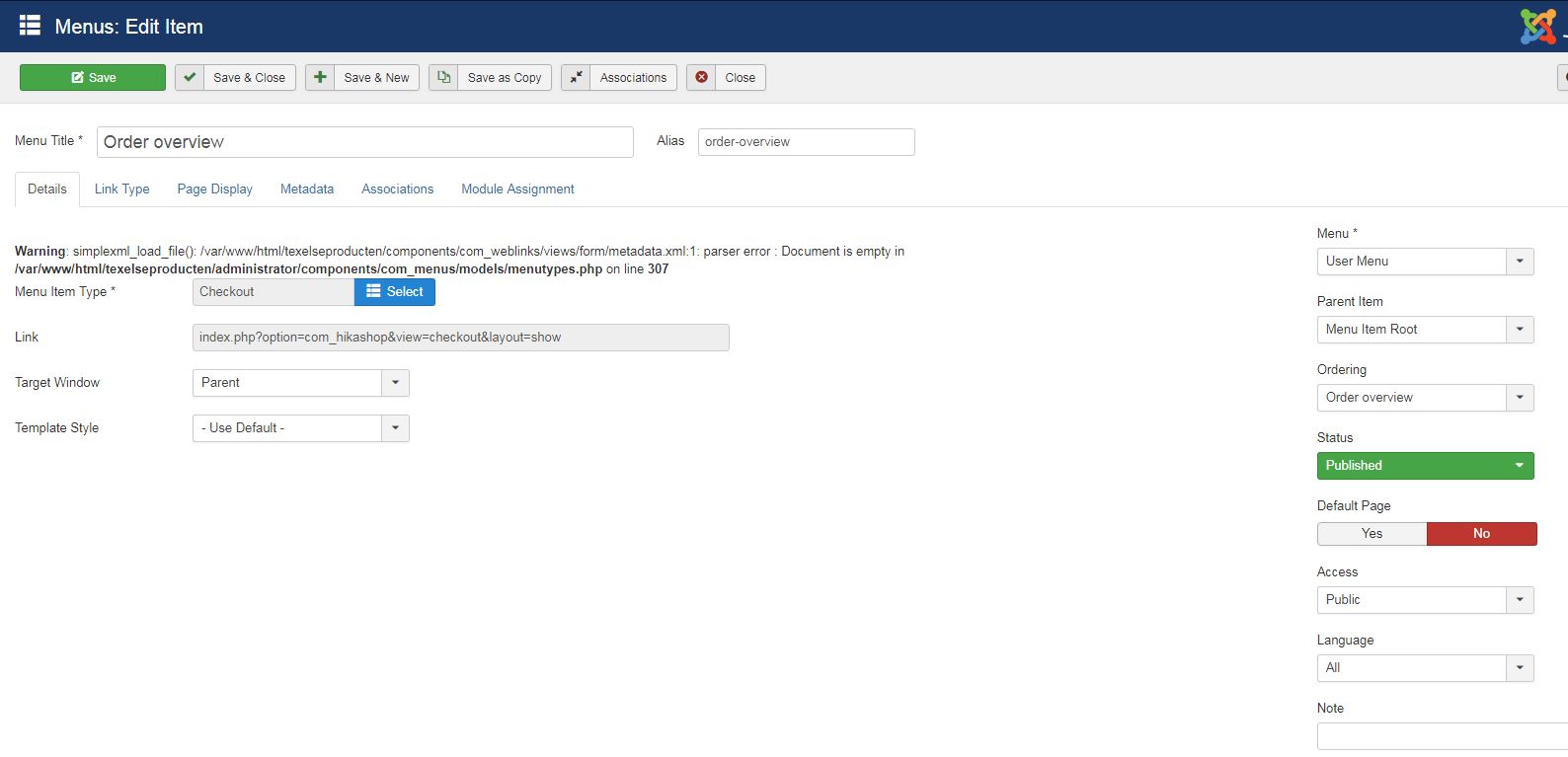

I have created a new menu item, and select it in the "force menu on checkout" setting. However, after I successfully made payment with paypal express check out, I return to the page I create, but it is blank as well.
How to solve it?

7 years 2 months ago #306492

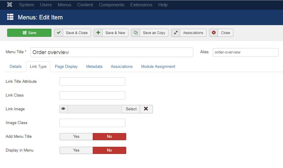

Can you provide screenshots of the settings of that menu item id with the id 1050 ?
Also, if you could provide precise instructions to reproduce the problem on your website, along with a link to it, that would be great.

Regarding the previous questions,these are the screenshot for menu item 1050.

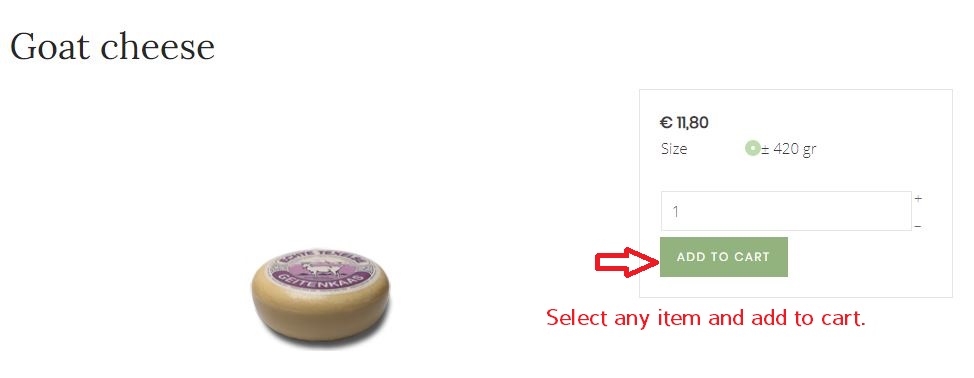

The steps are as following:
Just select any item and add to cart. Go to checkout page and select paypal express checkout.
It will redirect you to paypal payment page. You do not need to log in or sign up an account.
Hope to hear from you soon regarding this problem.

Reviewing everything, I think that the issue is what I was talking about from the start: your template is not displaying the error messages.
Do a payment test after switching to the default template of Joomla. With it, you should see the thank you message at the end when you're redirected back to the website.
That will confirm that there is a problem with the template.
And since apparently the issue is not with the <jdoc:include type="message" /> tag you would have to check with the template provider as to why this happens.
Otherwise, if you still have a blank main content area even with Protostar, then please provide a backend and FTP access along with a link to this thread via our contact form so that we can analyse the situation more in depth.

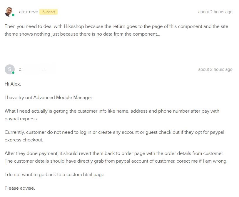

I have contacted yootheme, they said problem is with hikashop.
Attached picture from the conversation.
Please advise.
Jern

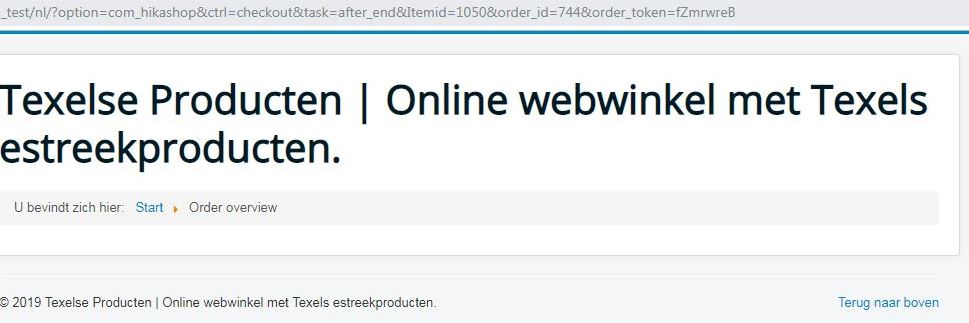

  • Posts: 34
7 years 2 months ago #306982
I have set my website to default template (ProtoStar) but it seems like the problem not with template.
Because when i check out with paypal express, it return to a blank page, after set the website to default template.
Attached the photo for the return page.
Hope to hear from you soon.
Thank you.
Jern
