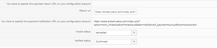

I don't understand what the address for 'You have to specify this payment notification URL on your configuration account' refers to, is this the address that SumUp needs to know?

Both point 1 and point 2 are probably because you didn't do "You have to specify this payment notification URL on your configuration account".
After a payment, the payment gateway (Sumup in this case) usually sends a payment notification to the website. For that the payment plugin integrating with the gateway either sends automatically the URL where the gateway has to send the payment notification, or asks you to manually provide that URL to the gateway. When the plugin receives the payment notification, it then changes the status of the order to confirmed and the email notifications are sent.
So this basically means that in the Sumup merchant account, there should be a place to provide that payment notification URL, and once you do so, it should all work fine.
It's probably what they call "webhook" here: developer.token.io/sumup_rest_api_doc/co...ashboard/webhook.htm
Sumup's support should be able to help you with this.

The link in 'You have to specify this payment notification URL on your configuration account' is www.artisan-pens.com/index.php?option=co...sumup&tmpl=component .

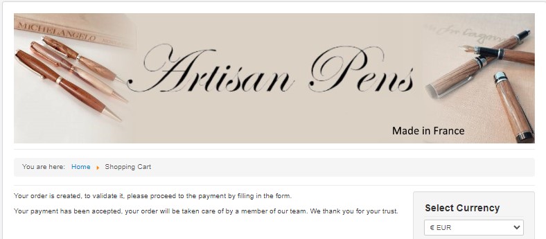

What is the link with your screenshot ? This screenshot just looks like the thank you page of HikaShop, which you've customized to adapt the text. But the customer coming back to that page has nothing to do with the payment notification as far as I know.

The screen shot is what is shown after the customer (me with a gmail address) has entered their card details and pressed 'pay' but that is all that happens (my SumUp account is credited at that point).
I would expect the order status to be changed to 'completed', the cart emptied and the product quantity to be reduced, none of which happens.

Do you what the return address on HikaShop should be to change the order status etc?
The SumUp part seems to be working, it's just that SumUp needs to know where to send the conformed/rejected notifications to change the order status etc.

It should be the URL on your screenshot:
www.hikashop.com/media/kunena/attachment...659_2023-07-17-2.jpg

Thanks, I hadn't noticed but that URL had more after the ? I have changed it to just artisan-pens.com/index.php and it's made no difference.

You need to use the full URL with everything after the ? too.

I've entered the full URL ( artisan-pens.com/index.php?option=com_content&view=article&id=4 ) in the return address and still not working.
