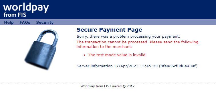

Trying to set up the plugin for Worldpay Business. I have set the Test Mode switch to Yes. There are several problems:-
1. The page does not automatically redirect to Worldpay.
2. The button to manually go to Worldpay has no text or image.
3. The Worldpay page (attached) says the test mode is invalid.
Worldpay support says the test mode parameter should be 0 for a live transaction, or 100 for a test.
The Debug information produced by the plugin shows testMode with the value of CAPTURED. According to the Worldpay documentation, that is one value that can be put in the Name parameter if the test mode is set to 100.
Some of the above could be down to incorrect configuration on my part (eg the button image/text as I have just left the default value in there), but I think the test mode setting is likely to be a bug in the plugin. As Worldpay want to see successful test transactions before they will allow use of the live service, this needs to be sorted out before we can move forward.

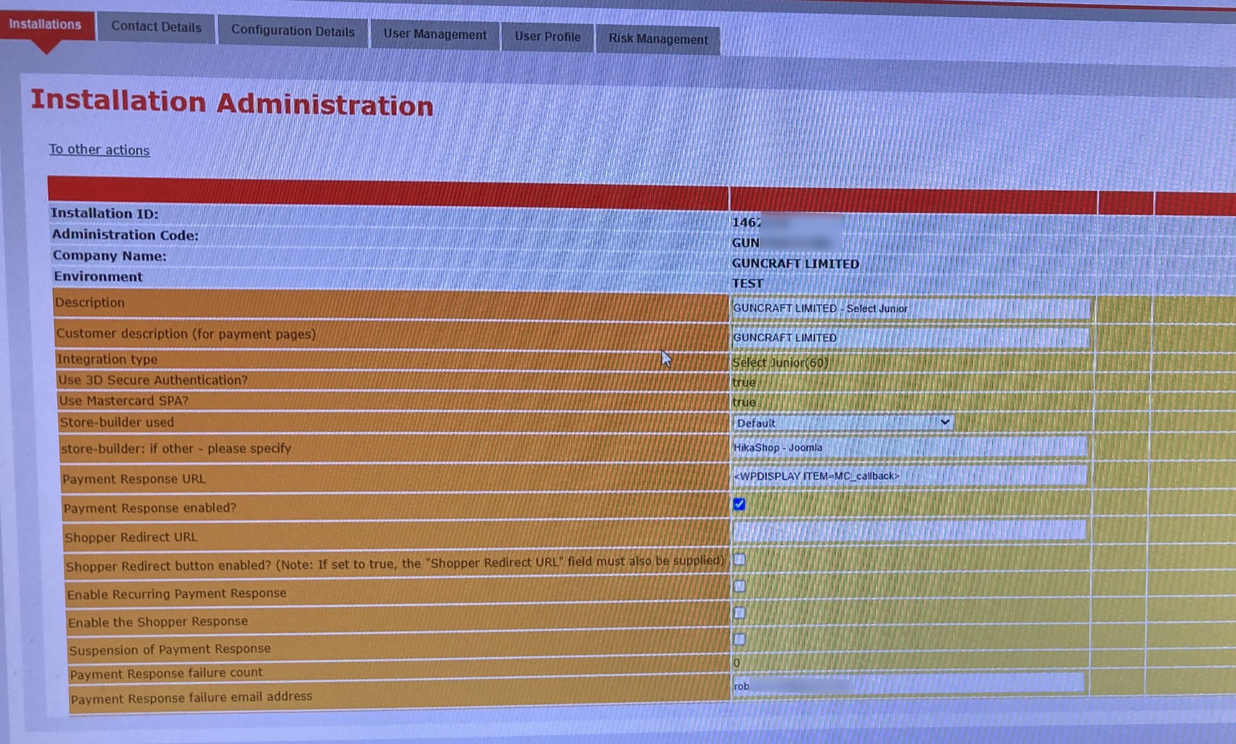

OK, here is the screen from the Worldpay setup:

The worldpay server doesn't send any response because, as I said at the beginning, the request it is sent by the plugin has an error in the TestMode parameter. It cannot validate the order because there is an error in the request.
As I said at the beginning, Worldpay support have confirmed this. Of the 3 problems I identified and told you about over a week ago now, 2 of them are before the plugin even sends the order to Worldpay. As a reminder,
3. The Worldpay page (see original post) says the test mode is invalid.
Worldpay support says the test mode parameter should be 0 for a live transaction, or 100 for a test. I am trying to perform a test transaction, as Worldpay won't enable live transactions until they see a successful series of tests.
The Debug information produced by the plugin shows testMode with the value of CAPTURED. According to the Worldpay documentation, that is one value that can be put in the Name parameter IF the test mode is set to 100.
If I knew enough about how the plugin gets stuff done I'd see about changing the testMode parameter, but I don't.
