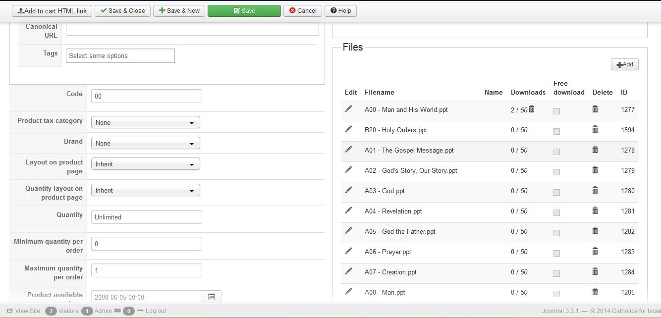

For a downloadable product that has several files to be downloaded, is it possible to sort the download files so that they appear alphabetically? Right now they seem to be in almost random order and I can't find any way to order them (see attachment).

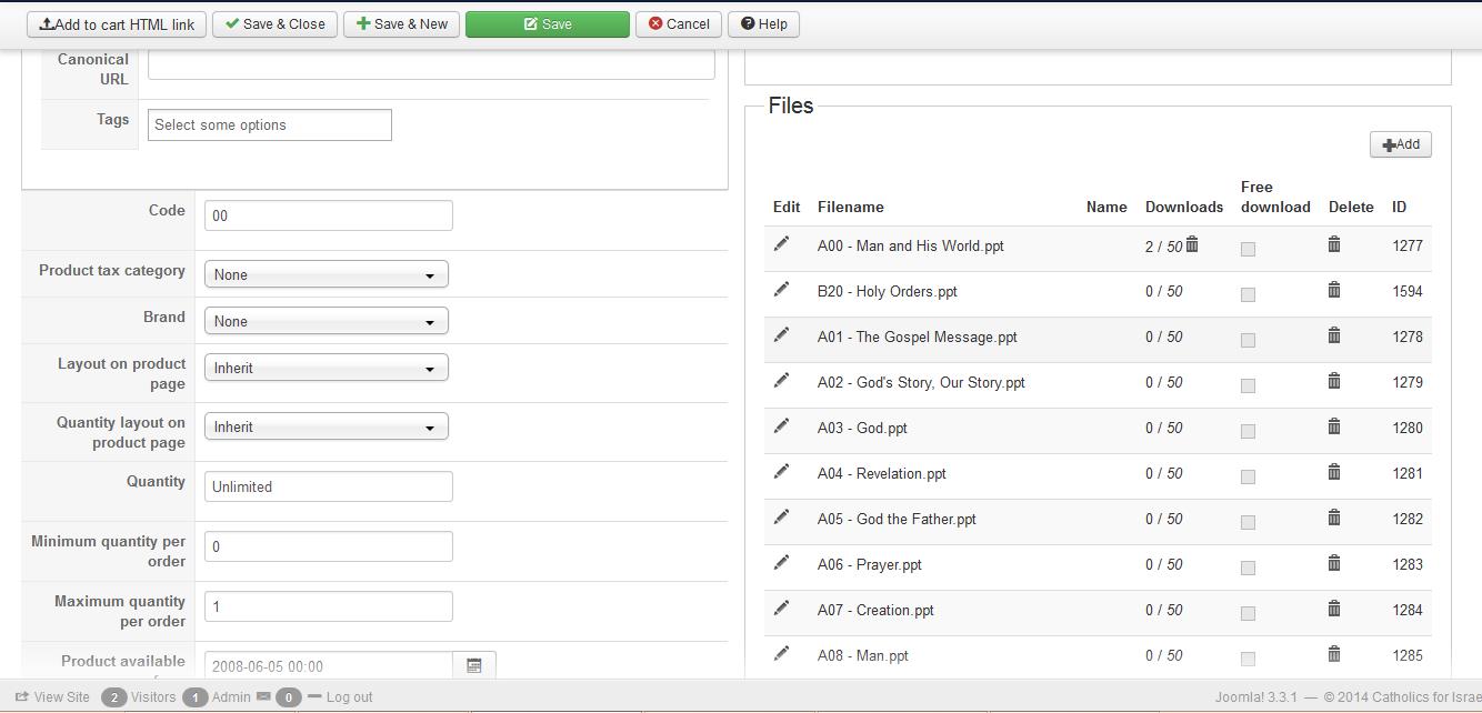

Thanks, but it still doesn't work. I have added the code at the beginning of the file as you indicated, but it makes no difference at all.
The download links are still disorganized and apparently in random order, either when looking at the product in the back end, or also in the customer notification email.
Still hoping for a solution.

I can see that you didn't enter any name for the files in your first screenshot, so it's normal that the code of Xavier doesn't do anything.
