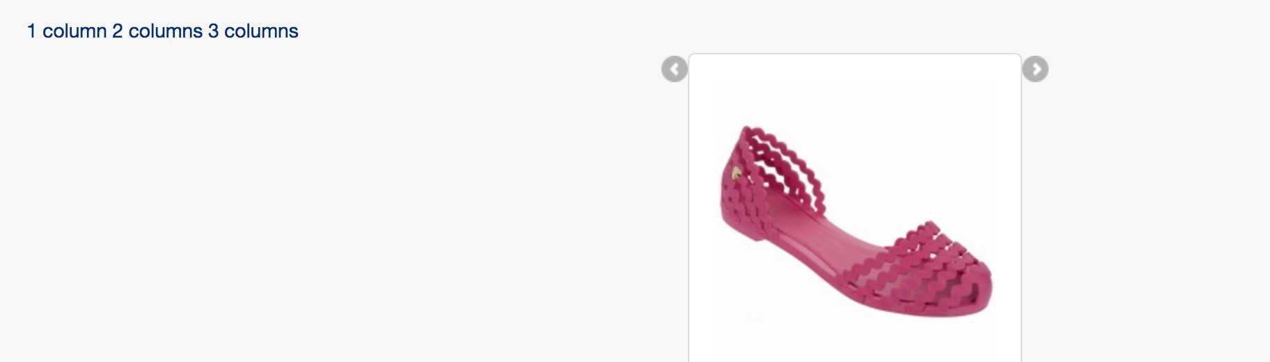

let me explain. i got the code below to work but my carousel modules are all in a list or single column because of code below.
//code for grid view altering columns
<?php
if(!@$_GET['columns'] || $_GET['columns']>3){ $_GET['columns'] = 1;
$this->params->set('columns', $_GET['columns']);
<a href="http://mayari.com.ph/store">1 column</a>
<a href="http://mayari.com.ph/store?columns=2">2 columns</a>
<a href="http://mayari.com.ph/store?columns=3">3 columns</a>

  • Posts: 85838
  • Thank you received: 14101
9 years 10 months ago #248935
As Jerome said, you're missing a bracket. The code should be:
//If we are on a product listing module
if($this->module){ null;}
else {
<?php
<?php
And also as Jerome said, this is basic PHP coding. Please contact professional developers to help you with such customization if you can't do it yourself.
