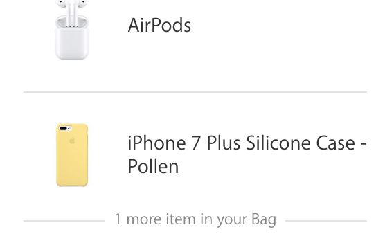

Hi, Nicolas.
i think i've explained bad or you have been misunderstood.
i have turned off the quantitiy option in mini cart module.
i just want to load an string of line inside an span tag to only show the total amount of main product inside cart.
for example if i have an iphone with software and another iphone with waranty i want that string at bottom of my cart to show 2
but it shows 4 even when i turn on the "Group options with product" !
i just want to count and show the total amount of main products it has nothing to do with hichashop mini cart quantity option i think !
Check this photo please

Then you should use such code:
		<?php
			if(!defined('DS'))
				define('DS', DIRECTORY_SEPARATOR);
			if(!include_once(rtrim(JPATH_ADMINISTRATOR,DS).DS.'components'.DS.'com_hikashop'.DS.'helpers'.DS.'helper.php'))
				return true;
			$cartClass = hikashop_get('class.cart');
			$fullCart = $cartClass->loadFullCart();
			$nbProducts = 0;
			foreach($fullCart->products as $product){
			    if($product->cart_product_option_parent_id) continue;
			    $nbProducts += $product->cart_product_quantity;
			echo $nbProducts;

You're My Man Nicolas,
It Finally Worked Thank you ;-)
