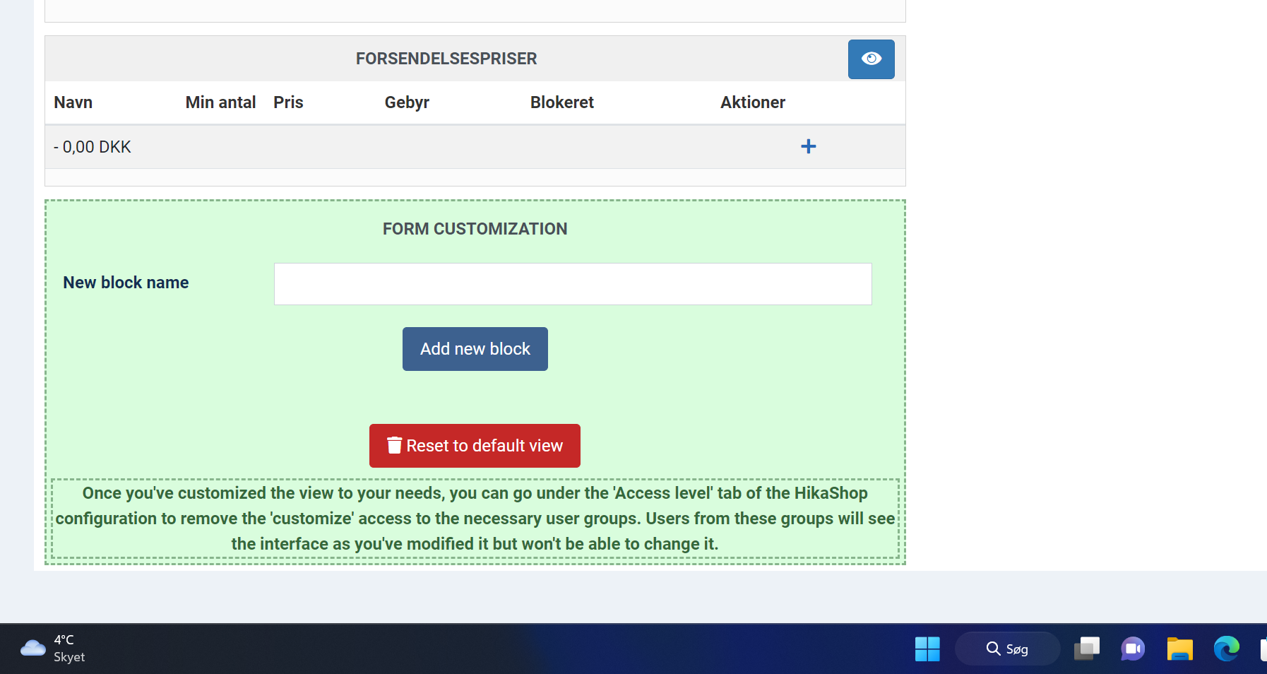

3 years 10 months ago #345219
I can only write in Microsoft Edge .
In firefox and crome I have to push the ret bottom "reset to default view" before I am able to write.
See photo.
  • Posts: 86051
  • Thank you received: 14179
3 years 10 months ago #345222
Do you have the issue with another editor ?
Could you also provide a backend access so that we could check on the situation ?
If so, please provide this along with a link to this thread via our contact form:

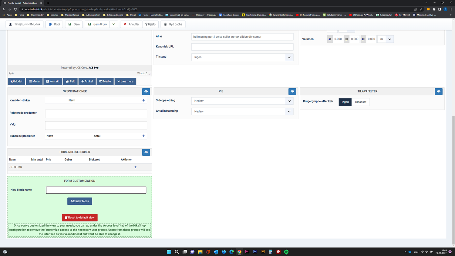

  • Posts: 159
  • Thank you received: 5
3 years 7 months ago #348370
I have the latest HIKA.
If I reset the red bottom in FORM CUSTOMIZATION it just go back after store the product. I have to reset to default view all the time.
I had Joomlashine before and I know there is some old design codes from them on some produtcs. Can this be the reason?
If I want to load a module from SP Pagebuilder to editor in products, it do not work too.
See photo. it stay like this all the time. Even after reset.
Br.
Peter
Last edit: 3 years 7 months ago by Peter Kjeldsen.
  • Posts: 86051
3 years 7 months ago #348374
Sorry, the option I was talking about has not yet been released. It will be in the next version of HikaShop with the "deactivate form customization" button :
i.imgur.com/DBbdVLx.png
The next version will be released in approximately 2 weeks.
