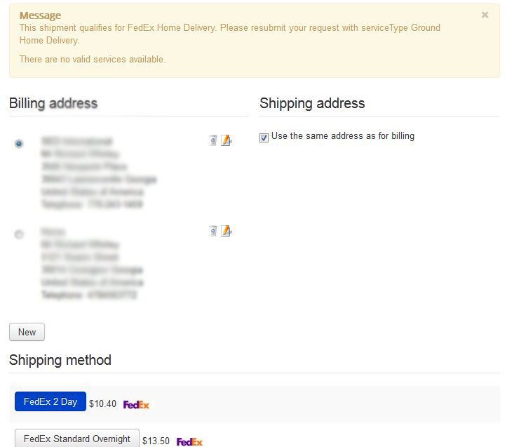

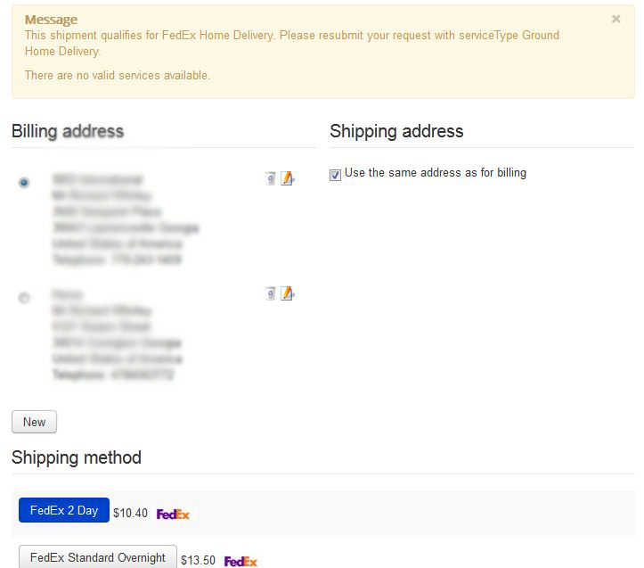

-- url of the page with the problem -- : www.canoneducation.com
-- HikaShop version -- : 2.2.0
-- Joomla version -- : 3.1.5
-- PHP version -- : 5.3.14
-- Browser(s) name and version -- : Firefox / IE - Any
-- Error-message(debug-mod must be tuned on) -- :
Message
This shipment qualifies for FedEx Home Delivery. Please resubmit your request with serviceType Ground Home Delivery.
There are no valid services available.

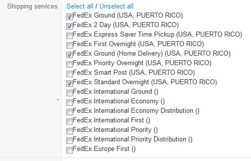

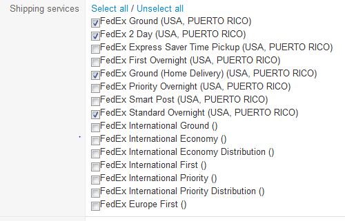

I can't get this message to go away. Clearly there are valid services available, it's listing them... And the FedEx Home Delivery is checked in the back end. See screen shots.
Thanks!
12 years 10 months ago #119673
The temporary solution will be to unpublish the FedEx Ground (USA, PUERTO RICO) service and use the FedEx Ground (Home Delivery) (USA, PUERTO RICO) service.
Then your FedEx shipping method won't display any error message.
