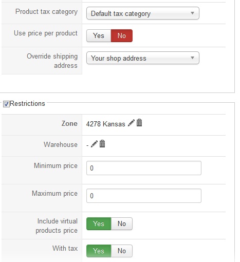

11 years 11 months ago #165025
I'm trying this patch (client is fine with it not filing TaxCloud at this time).
However I cannot get a HikaShop tax rule to apply when choosing the local pickup shipping method.
it doesn't apply TaxCloud tax rate (good) if I pick the local pickup.
If I pick another shipping method (e.g. UPS), the TaxCloud rate is applied (good)
If I choose the local pickup (with shipping address overide); it doesn't apply any taxes to the order.

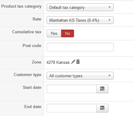

My Default tax category rule is as follows:
The Main tax zone is set to "United State of Americia)".
And the manual shipping setup for Local Pick up as the "Product tax category" set to "Default tax category" as are all products:
Any idea what am I missing to get the 8.4% tax to show up for only for local pickup method?

I guess that it's because your user address is not meant to be taxed as per your tax rules.
Here is a new version of the plugin which has that new option is was talking about:
You can install it and configure it to use the origin address if the shipping address if overridden.

11 years 11 months ago #165061
This is basically the same set I use for non-Tax Cloud states that have 1 rate for the entire site.
The customer user's billing address is in Kansas; ore are you talking about some other user for the shopping cart?
Regardless I've tried the files you have - no change on the front end.
Still not charging a tax (TaxCloud or otherwise).

I tried that just now. That does fix the TaxCloud plugin form issue, thanks.
I do see the new setting and have set it to Yes:
And then I tried to place an order with the local pickup shipping method and still no taxes on the order. I can switch to one of the other shipping methods and the correct taxes show up just fine. No errors any where that I can find.
I also tried switching override to No in the plugin - still nothing (even with my tax rule).
When I unpublish the TaxCloud plugin, the HikaShop tax rule for KS works for every shipping method but the Local Pickup.
That pointed me to look at the manual shipping / Local Pickup with override closer. After playing around with TaxCloud turn off; I did manage to get taxes to show up eventually by:
  • Use price per product must be set to Yes - otherwise only the shipping cost was getting tax (0 x .084 = 0 or no tax)
  • Override shipping address has to be set to No (this was the key find)
The price per product makes sense I guess.
But override shipping address seems to be where the problem is.
Anything other than No and TaxCloud or not - it never charges taxes.
When Override shipping address to No even with Tax Cloud that is the only time it charges taxes (however at the wrong rate).
I confirmed this on my own internal test site/server which is actually running unmodified 2.3.1 version as well as the production site running 2.3.2.
So I think the issue might be more with the manual shipping method's override & taxes at this point.

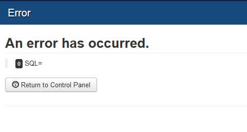

On a side note, I found another bug related to TaxCloud.
When adding a new order on the backend (Orders -> New) I get a error but the order is created:
In the web log files, it points to an PHP error with the TaxCloud plugin:
[Wed Jul 23 10:00:53.205982 2014] [:error] [pid 20377:tid 140096061830912] [client x.x.x.x:32126] PHP Warning: Invalid argument supplied for foreach() in /home/xyz/www/plugins/hikashop/taxcloud/taxcloud.php on line 451, referer: www.littleapplewoodenpuzzles.com/adminis...ale&filter_partner=0
[Wed Jul 23 10:00:53.308593 2014] [core:error] [pid 20377:tid 140096061830912] [client x.x.x.x:32126] Invalid status line from script 'index.php': 0 SQL=, referer: www.littleapplewoodenpuzzles.com/adminis...ale&filter_partner=0
If the TaxCloud plugin is turned off, there is no error. I upgrade my internal test site to 2.3.2 but left the TaxCloud plugin alone but enabled and it has the same problem. I thought I'd just let me know.
