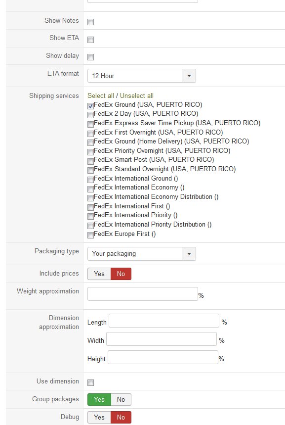

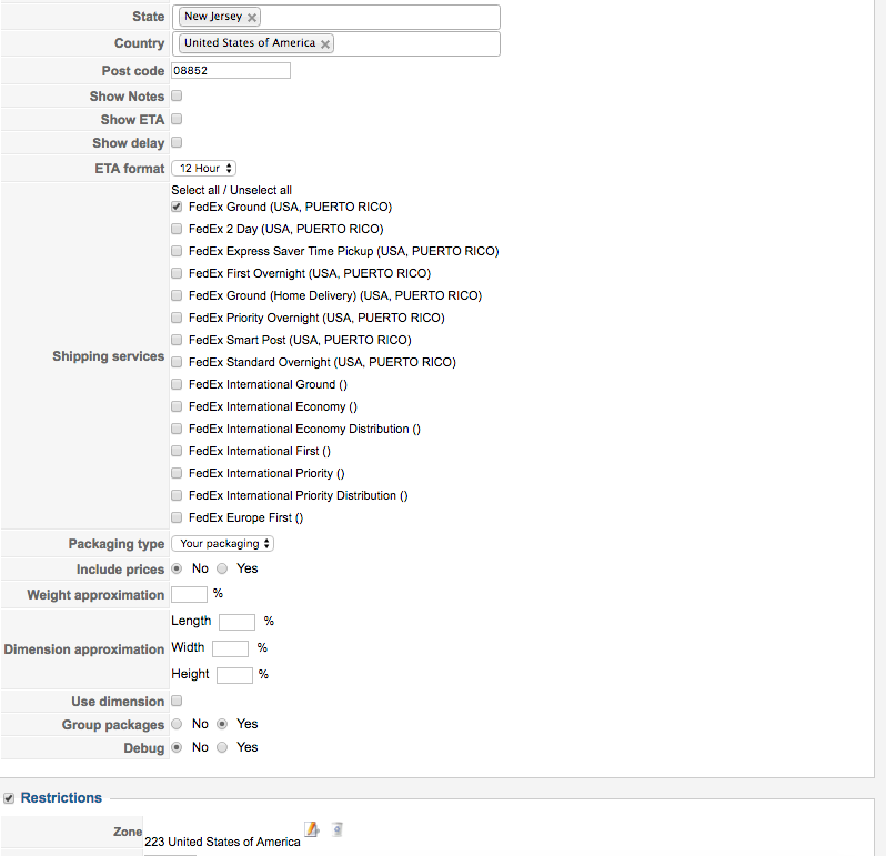

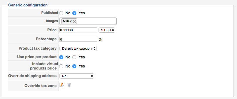

Hi, I came across this topic and mine is related slightly.
We've been having Fedex Ground issues and the prices calculated are much lower than what FedEx actually charges.
We have weight and dimensions for each product but the prices still come low ex.
Product
weight: 3.5 lb
dimensions: 24 by 12 by 12 in
The price calculated by FedEx plugin for Ground shipping is: $13.01, but an estimated shipping on the FedEx site is $94.19
That's a huge difference.
I am testing to send this from zip code: 08852 to zipcode: 98109
- Joomla 2.5.28
- Hikashop component has been updated to the most recent business version: 3.2.0 with hope that it would fix the problem
- SOAP is enabled
Is there a separate update to Fedex Shipping plugin?
Attached are screenshots of configuration.
Thank you for any help with this! I tried different settings and nothing works.
8 years 10 months ago #278343
Did you also test it with the "Group packages" option of your shipping configuration page set to NO ?
If not can you test it and see if the returned price is better ?

8 years 10 months ago #278375
The post code that you have to set through the FedEx plugin configuration is supposed to be your post code from which you are sending your packages.
Also I tested it on my end and it seems to be working fine, it's correctly displaying rates returned by the FedEx shipping platform. Note that the FedEx shipping plugin is only supposed to send to the FedEx platform information about your order, and then display rates returned by the FedEx shipping platform.
