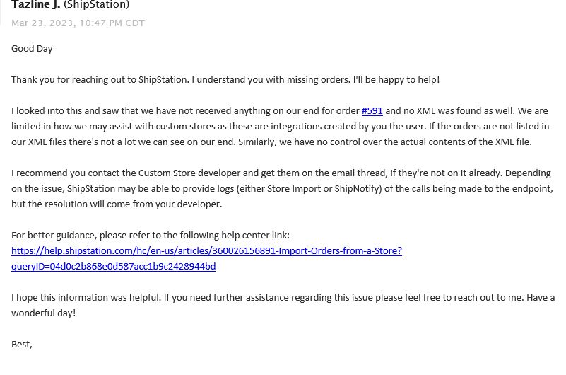

Here Is Response from Shipstation:
Thanks for reaching out today. I understand you are missing some orders. I am happy to help with that today!
I took a look at the store feed XML, and the custom store does not appear to be sending ShipStation orders at this time.
As this is a custom store, ShipStation support is limited on what we are able to do regarding this behavior, as the XML is not sending these orders to ShipStation.
I would recommend reached out to the developer for more insight at this time! This article provides more information as well.
If you have any other questions or concerns, please do not hesitate to reach back out.
Have a good weekend!
3 years 5 months ago #350615
I'm really sorry to have to say it like that, but Shipstation support is not really helpful.
Here is what we believe we know from our side:
- Your Shipstation plugin works as expected by producing a correct XML following a notification from Shipstation export notification
=> And note that with an adequate notification simulation we were able to create the XML relating to your missing orders.
- When we connect to your merchant account, we can carry out updates or connection tests which are successful...
From this we need more elements or we won't be able to progress on your subject...
We needs elements like :
- Idea about what can leads us to this kind of situation, explanation more specific, concrete case etc...
- We are quite sure that Shipstation have on his side some log file that may be useful to understand the issue, like breaking XML, error message, and any elements that can provide us new elements
Note that from experience, if we discuss directly with Shipstation as we are not a customer, there is a risk that they will not even answer us...
So it's up to you to do the intermediary unfortunately, and so of course it takes longer than if we could interact directly with Shipstation Support.
Really sorry for this return, but we hope that we will be able to progress on your issue.

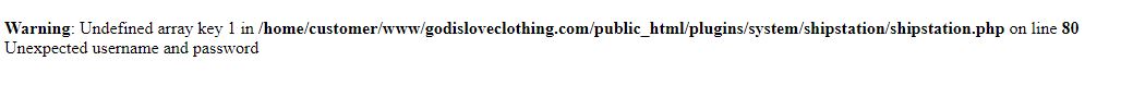

Also found this message when I turned on error reporting:
