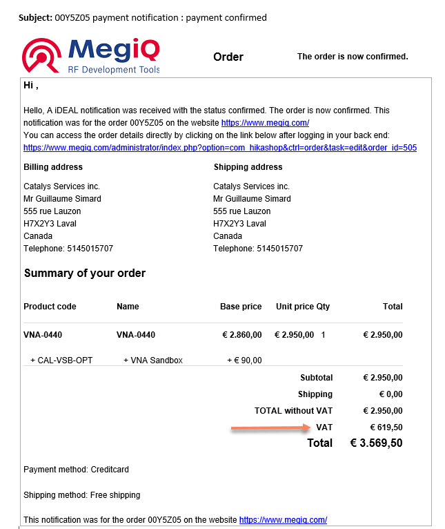

Tax only should be added to customers in the EU. But e.g. customers from Canada also get VAT. How to solve this problem?

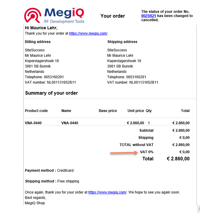

4 years 11 months ago #334075
Additional info for client from The Netherlands. It should calculate VAT, but it does not. See printscreen. Please help.

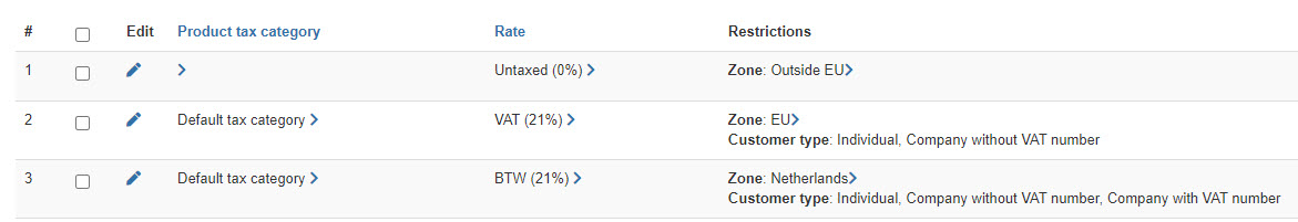

4 years 11 months ago #334067
Well, you need to check your tax rules in the menu System>Taxes.
Something must be wrong there.
Please provide a screenshot of that page and we should be able to tell you what's wrong.

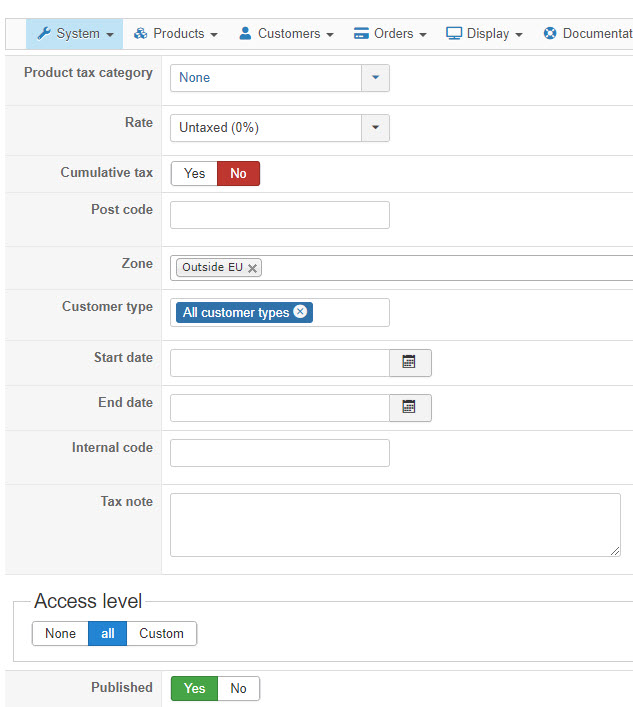

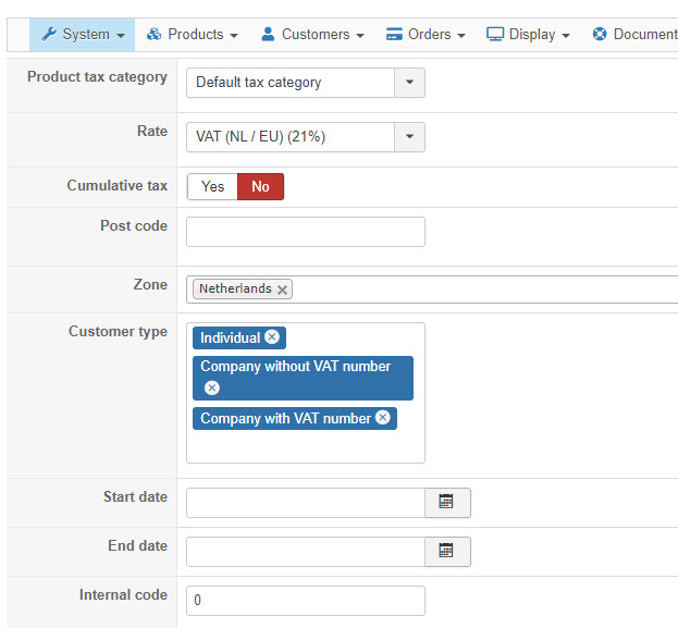

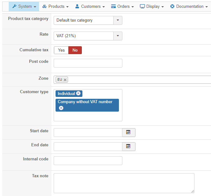

4 years 11 months ago #334108
Here are all the screenshots.

4 years 11 months ago #334119
First, make sure that the product you're testing with has its "tax category" setting set to "default tax category".
Second, I would say that the issue might be with the "EU" and "Outside EU" zones.
The EU zone should be of the type "tax" and contain all the EU countries except the netherlands.
The "outside EU" zone should also be of the type "tax" and contain on the other countries, not in the EU.
Also, in your shipping methods, there is a setting "override tax zone". If you set this setting, it will use the zone selected here instead of the zone of the shipping address when the shipping method is selected. So it could potentially come from there too.
Please check all this.

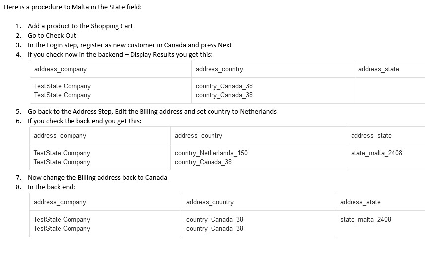

Some addional information.

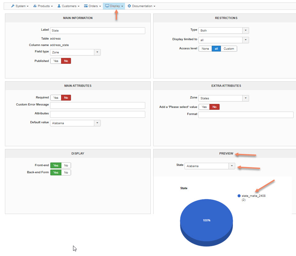

Here is a procedure to Malta in the State field:
Custom address_state field, see screenshot. Look at the preview part.
First of all, Malta is not a state but a country!
In the pull down list Malta is not mentioned.
But still the graph mentions state_malta_2408.
All very strange...
Last edit: 4 years 11 months ago by mlehr.
  • Posts: 85726
  • Thank you received: 14054
4 years 11 months ago #334257
Yes. I've done these tests already before my previous message.
And you can note that the custom field address_state is unpublished. I've unpublished and made that test, after fixing the address_state of all the addresses in your database to make sure that it was not HikaShop doing it since HikaShop won't take into account unpublished custom fields for the saving of the address.
Regarding Malta being a country, you're correct that Malta is a country.
But In HikaShop we have both Malta as a country and Malta as a state of that country, being the main island of Malta. There is another state named "gozo" for the two northen islands of the country.
Anyway, there is no reason why HikaShop would set that state in the address_state column, since that not even the default value of the state field.
Besides a custom plugin, I don't see what it could be.
