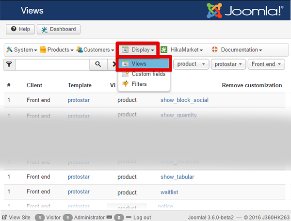

Note : To check your override view :
- Go to Components => HikaShop => Configuration
- On Display dropdown select Views
- Use the three filter dropdown to find your view product, in your front-end template
To learn more about override system, check this tutorial, here
