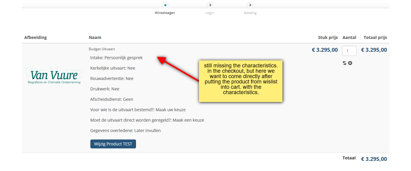

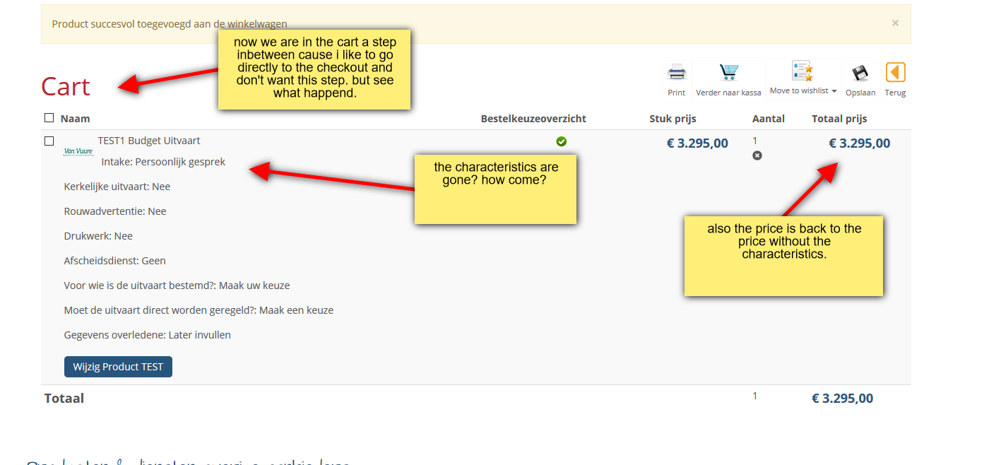

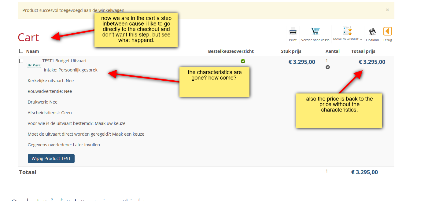

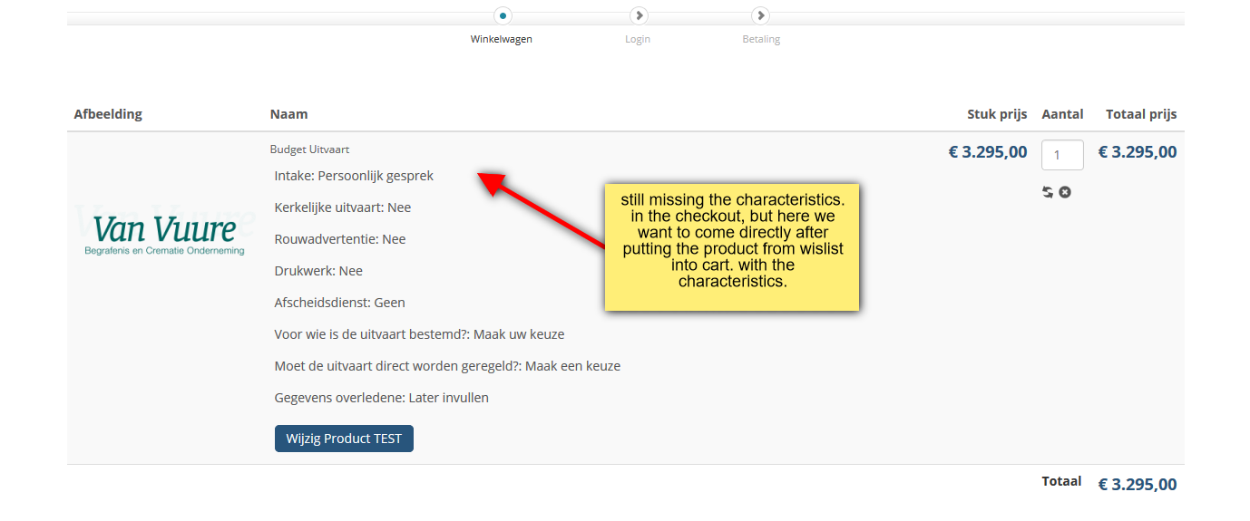

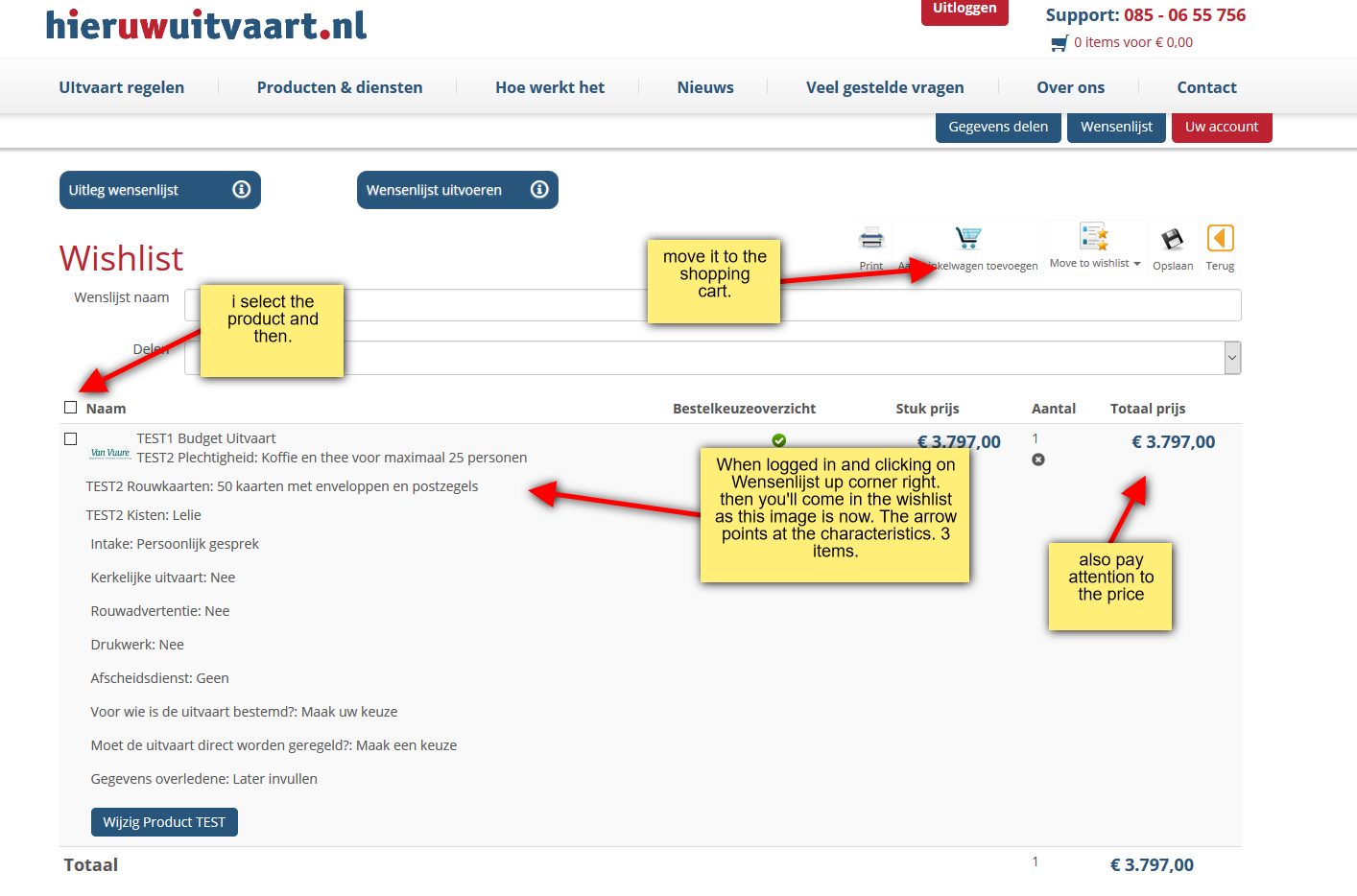

I got a problem with the wishlist and that is the following.
When i put a product with characteristics and other option of custom filelds in the wishtlist. they are neatly in it.
When i add this product with all options to the cart, the characteristics are gone ? why?
And also i want if we add the product from wishlist to be directly moved towards the checkout and not the step in between to the cart and then to the checkout.
Please help.
Thanks.

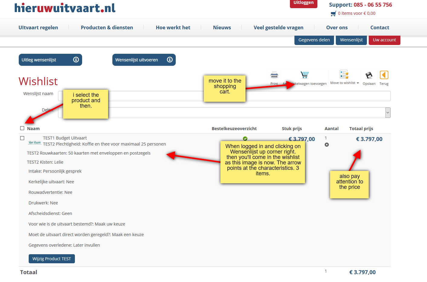

8 years 11 months ago #278320
I've made screenshots to show you what is happening. You can test it for yourself. I will give you 2 different users to log in cause with each user the wishlist is reacting differently.
Hope you can help out.thanks.

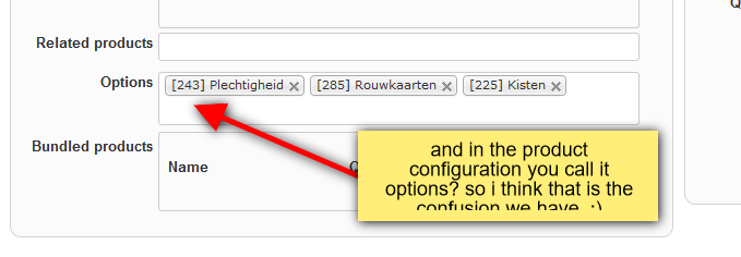

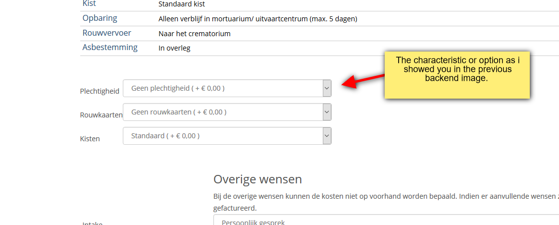

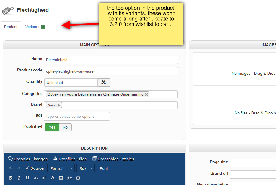

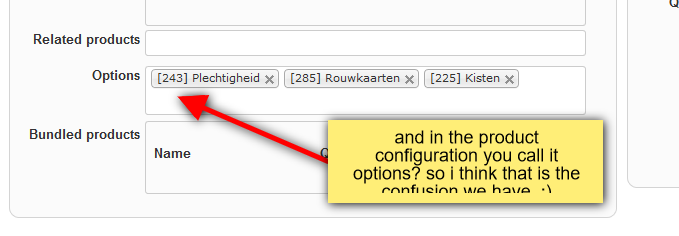

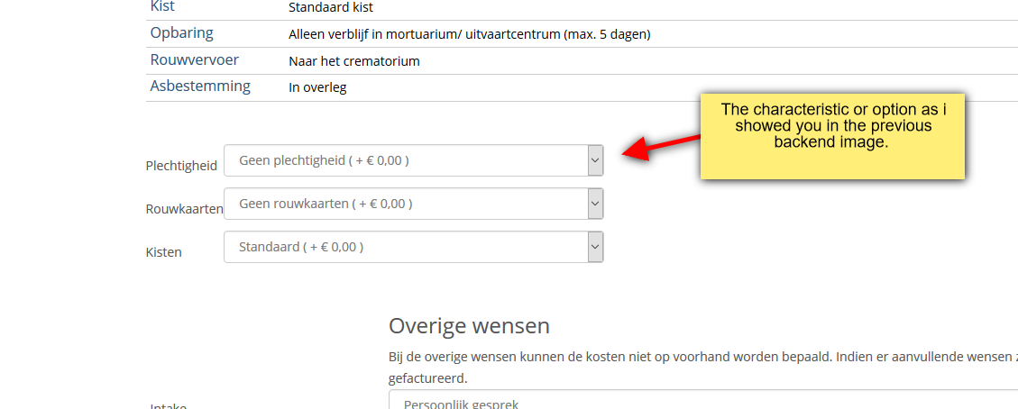

8 years 11 months ago #278419
Hello Jerome,
Sorry my bad, i confused i meant the options. it has to do with the options in the product. for example in this product.
hierutest.incunopra.nl/producten-dienste...oduct/basis-uitvaart
In the backend of the product it is like this.
and so in the option product it look likes this.
These won't go to the cart while they are in the wishlist.
Hope you understand it better now.
Sorry i mixed up some names. :)
Hope you can help.

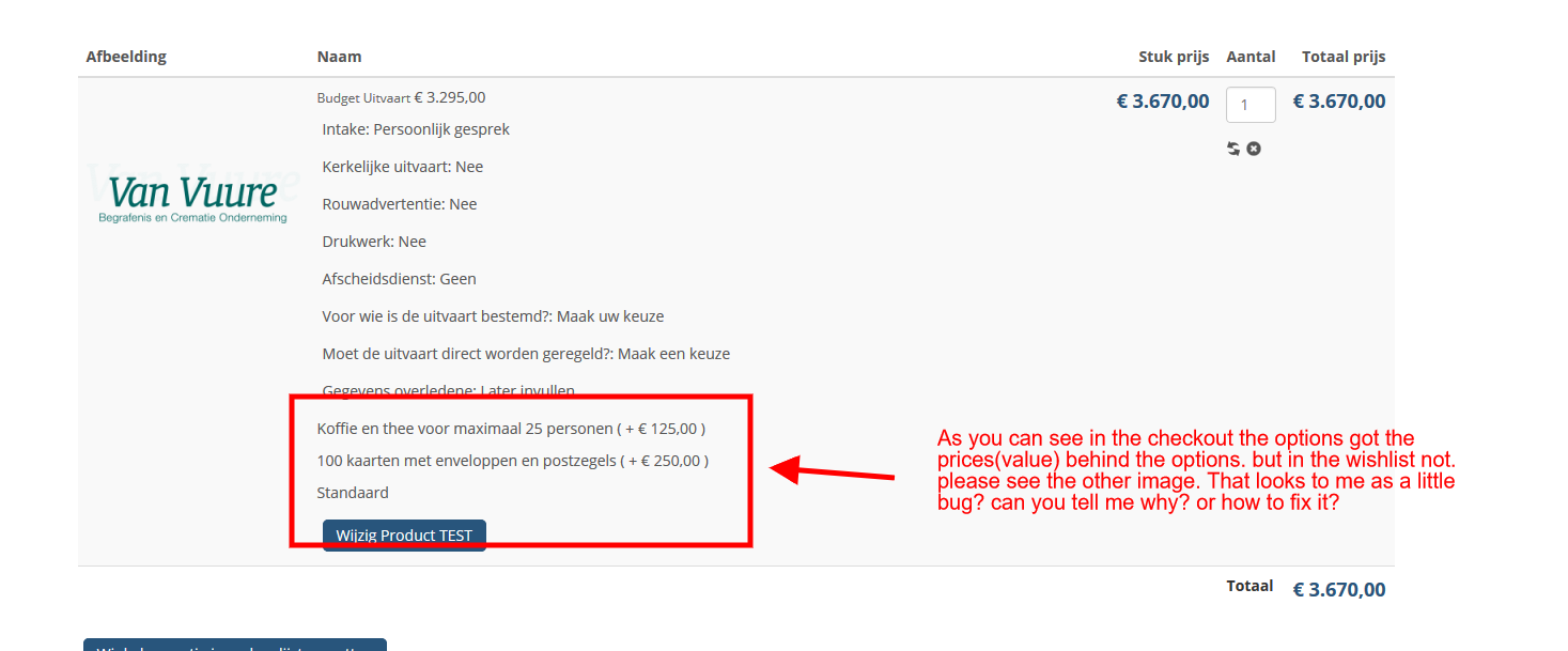

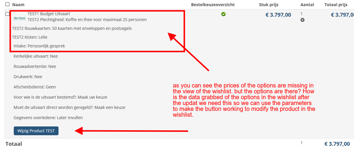

  • Posts: 424
  • Thank you received: 11

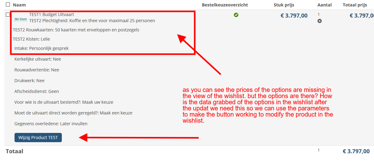

8 years 11 months ago #279126

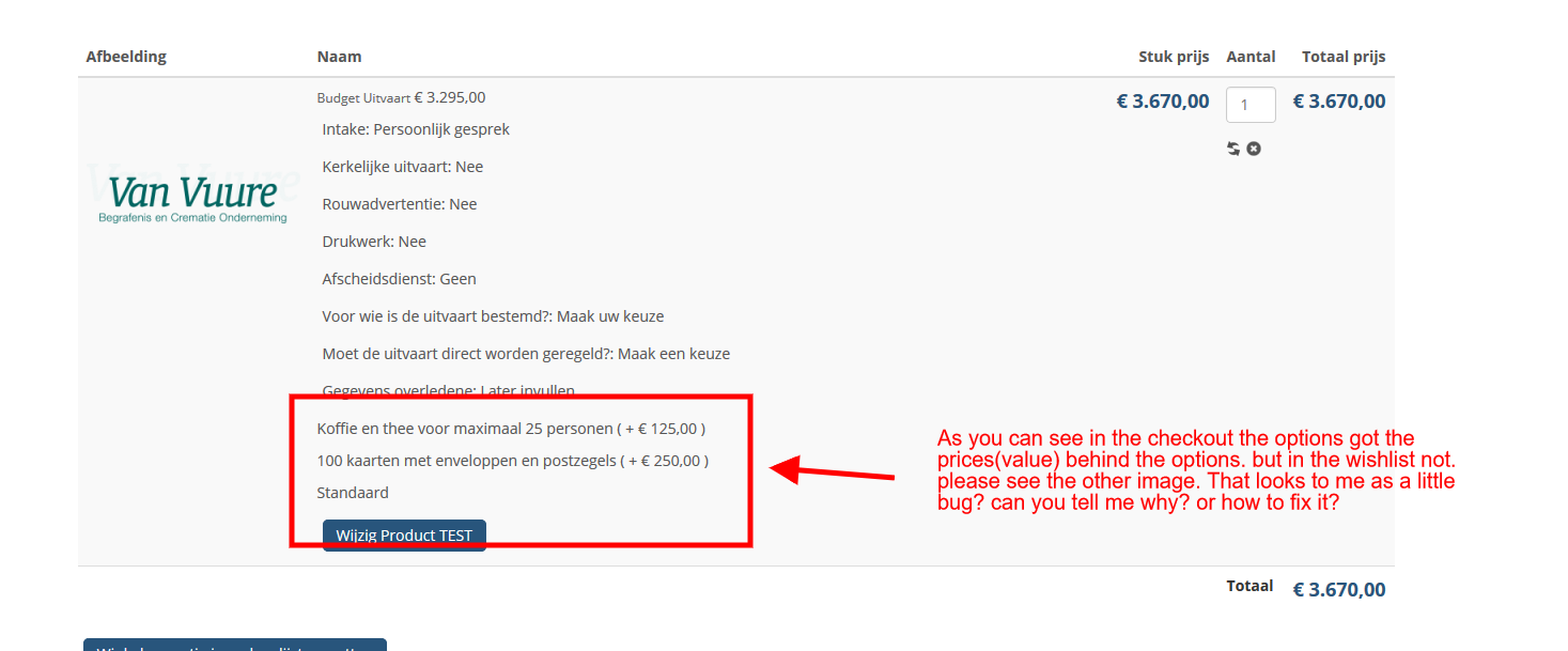

one little last question, how is the data for the options grabbed into the wishlist cause i see a diference of showing the option data in the checkout. see images.
can you please tell how this is done? or how i can fetch the data ?
  • Posts: 86099
  • Thank you received: 14200
8 years 11 months ago #279141
The data is already loaded in the view in the product data object in ->prices, like on the checkout.
We just don't display it on the wishlist/cart manager. So you could use code similar to the code in the show_block_cart view file for the price display.

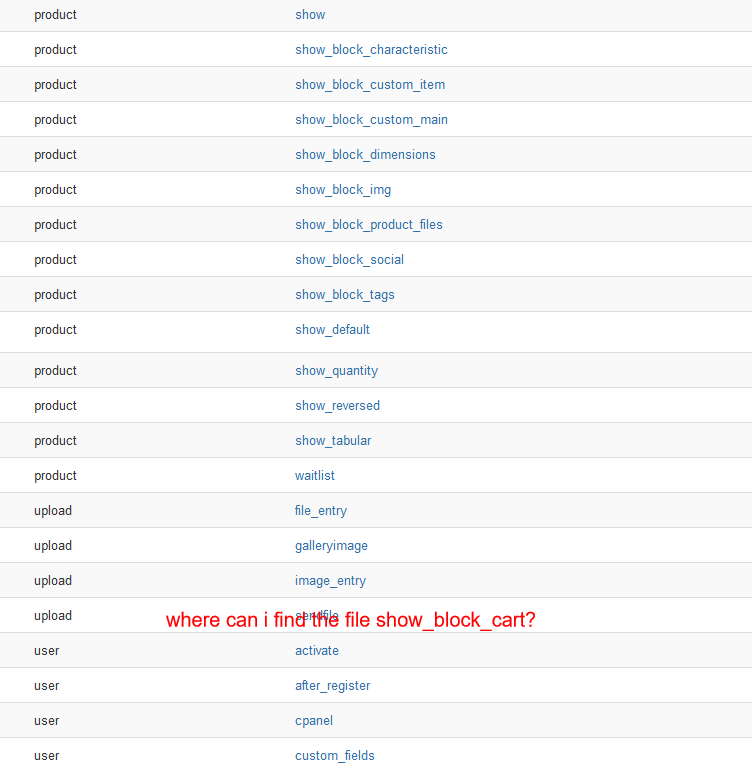

  • Posts: 424
8 years 11 months ago #279206
just a little question where can i find that view?
can not find it in the views. :)
  • Posts: 86099
8 years 11 months ago #279209
It is in Display>Views. So you must have missed it. Use the search input field in order to search for it.
  • Posts: 424

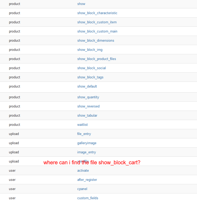

8 years 11 months ago #279421
As you said i search for this file in display->views using the search tool but this file isn't there: show_block_cart
8 years 11 months ago #279426
If you have Hikashop's 3.2.0 version, you should find it through the "Hikashop->Display->Views" page by searching for the "show_block_cart" file of the "checkout" view of your front-end template.
