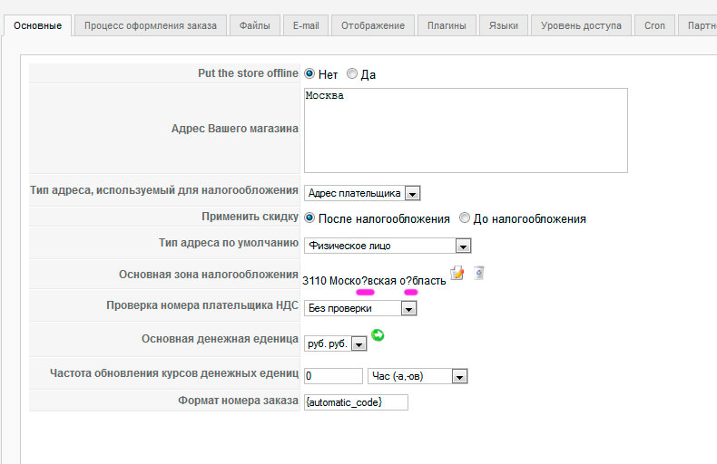

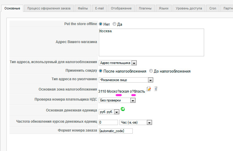

14 years 6 months ago #39183
here is unnecessary question mark in Main tax zone
it must be Московская область.
I can't fix it by myslef
Я здесь добровольно!

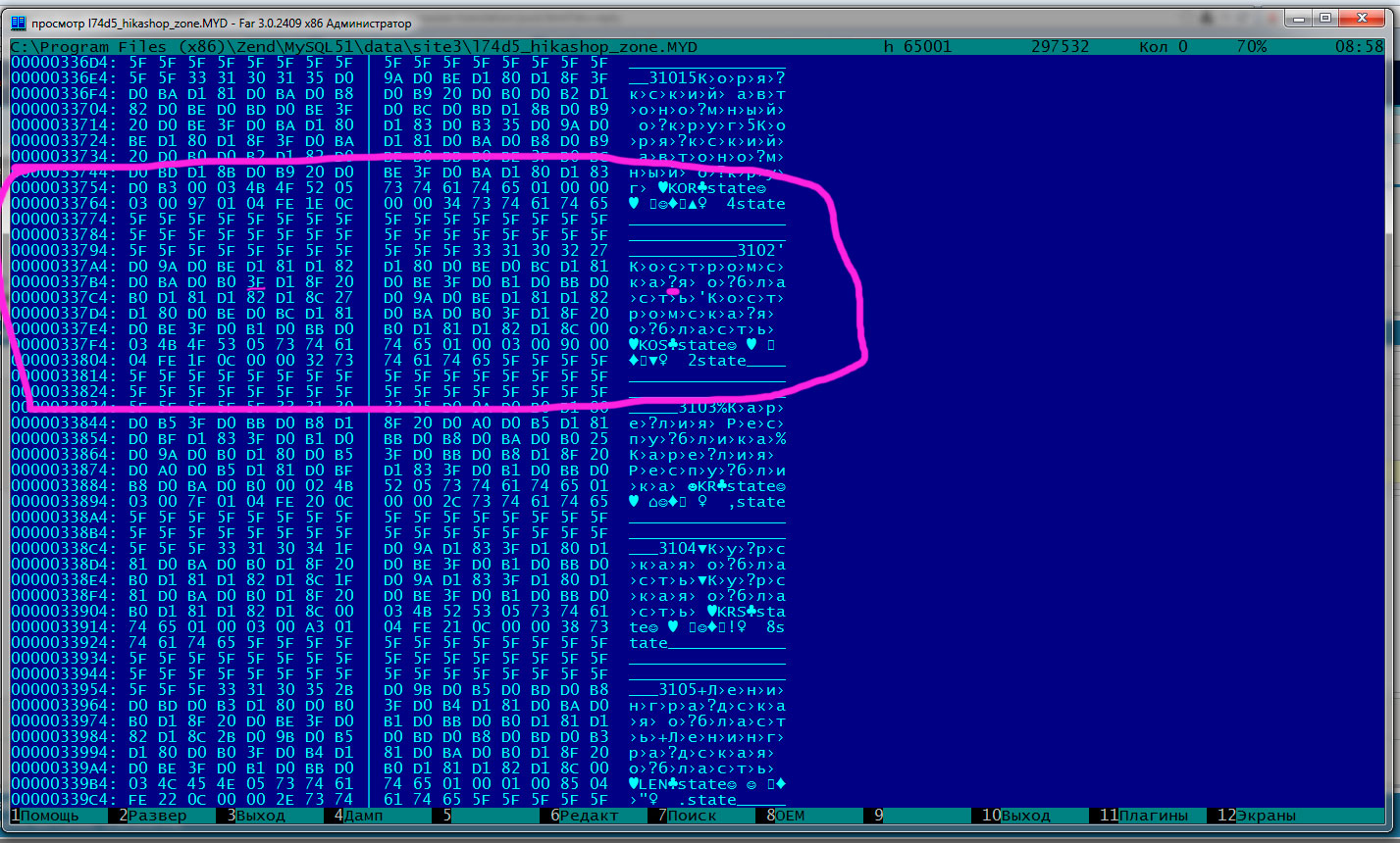

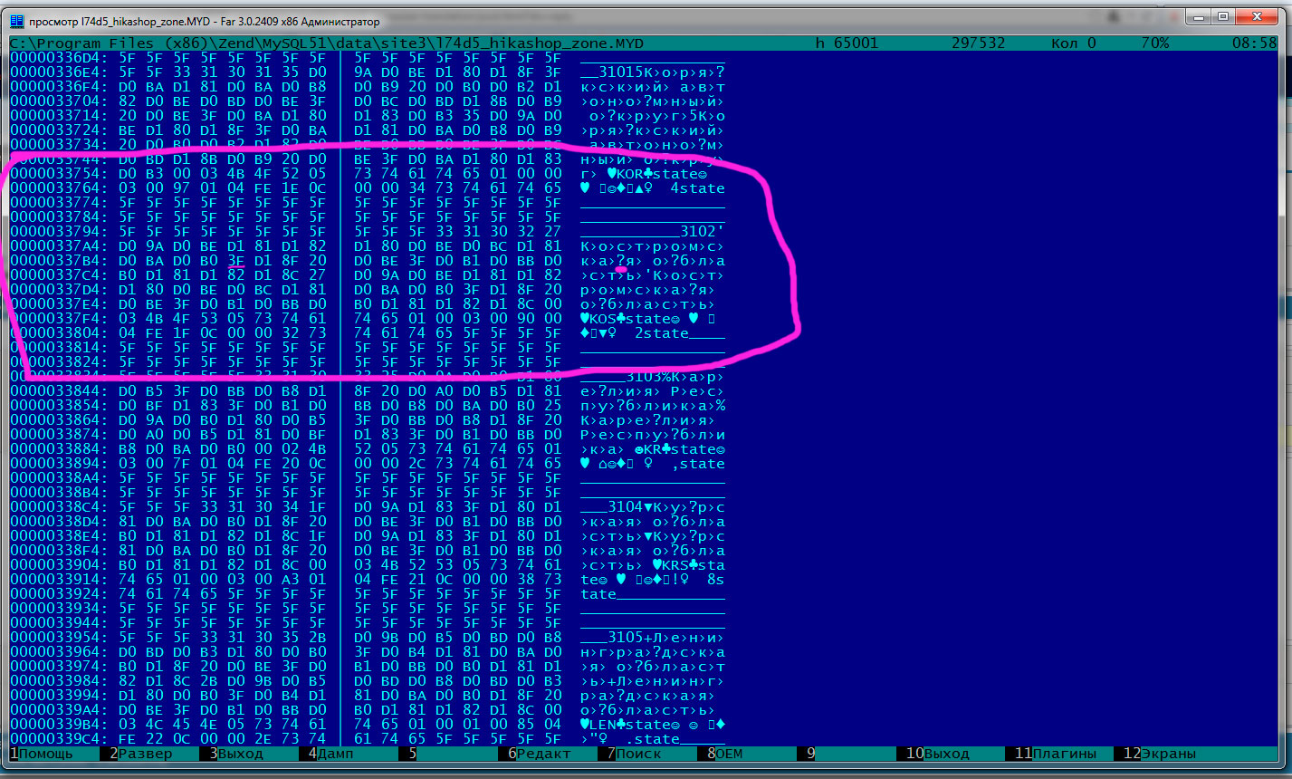

14 years 6 months ago #39422
Here is zone number 3102
Костромска?я о?бласть
(it must be Костромская область)
and here is screenshot of the mysql database in hex format of this record
