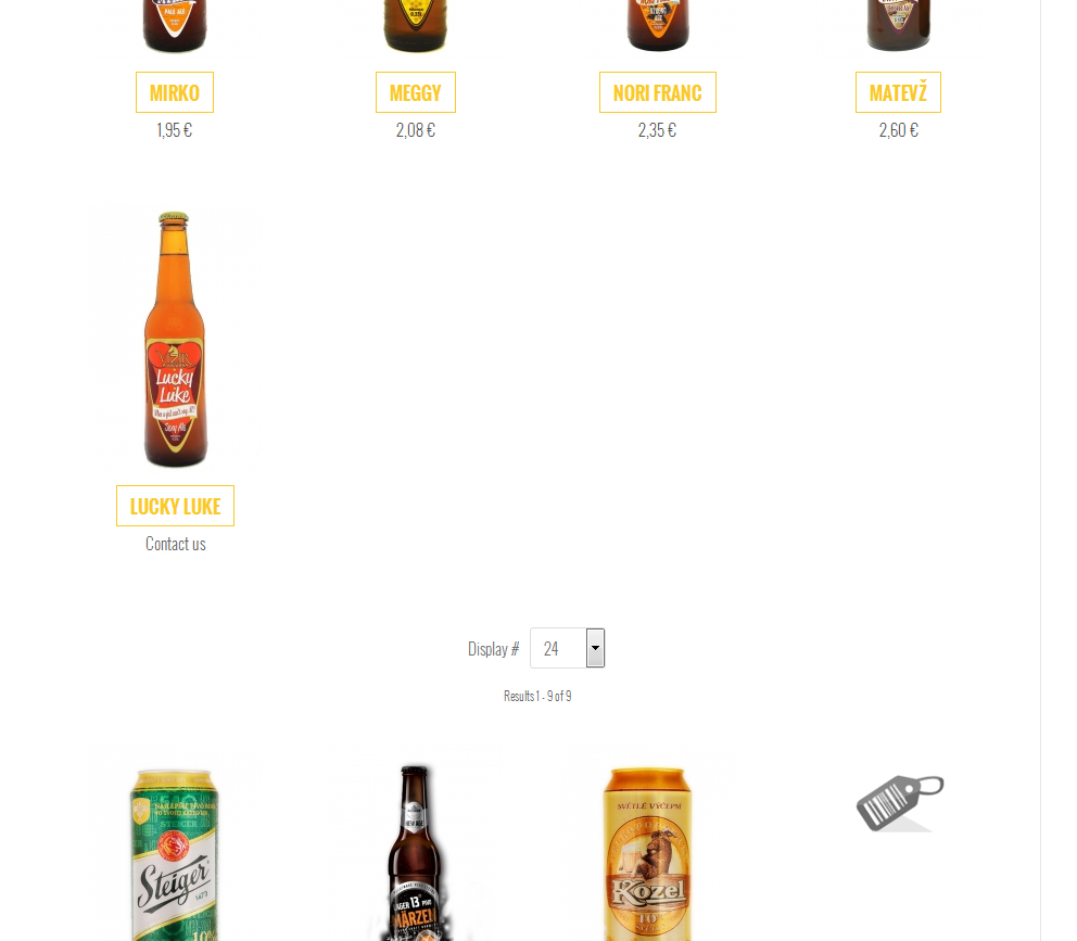

But there is also a problem. Below the product list are displayed all products - don’t know why (only on En. language). See the attached picture.

So there are errors IN INCORRECT LINKS connected with categories (all the categories) and displayed products after the list of category products.
