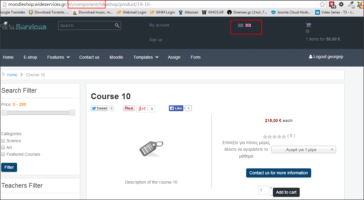

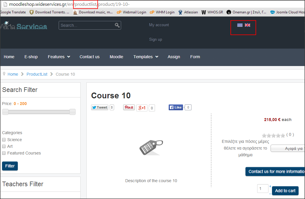

  • Posts: 95
12 years 2 months ago #158078
I have attached the issue I have found in my eshop. When I enter a product from the search filter the url is from a menu and the language switch module is fuctional. When I enter the same product from the front page - from component- the language switcher module doesn't work in order to change the language. This happens in both languages.Any ideas?
Thanks in advance

  • Posts: 86049
  • Thank you received: 14177
12 years 2 months ago #158845
If you see component/hikashop in the URL it means that you didn't enter the id of a products listing menu item in the menu/itemid option of your search plugin/filter module.
So please check that. Then, the results page will display links without the component/hikashop and instead it will have the alias of the menu item, like on your other screenshot.
  • Posts: 95
12 years 2 months ago #158901
Οk thanks ! I changed from the content modules the associated menu and it worked! Thanks a lot!!!
