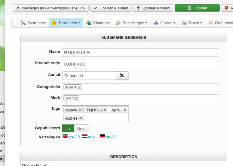

Product Description is not translating, for e.g the wishlist button translates. I have added the texts in the Product Area ( screen ) . I am using FaLang and as said all is translating but not the Descriptions

So you have set a description on the main product edition page, and when clicking on the other language flag added the description in the popup ?
If it is, that should indeed be working, I just make a test on my local with FaLang too and it is working as expected.
