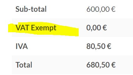

How to tranlsate "VAT Exempt"
  • Posts: 111
8 years 8 months ago #285225
-- url of the page with the problem -- : www.portal-gestao.com
-- Joomla version -- : 3.8.5
There seems to be no possible language override to "VAT Exempt".
Tried both joomla and Hikashop, but no luck.
How can I translate this?
Thank you.
  • Posts: 86176
  • Thank you received: 14211
8 years 8 months ago #285239
There is no such text in either HikaShop or Joomla.
So it's normal you can't override it.
Where did you get that text form ? Isn't it the name of a tax rate you configured via the "manage tax rates" button ?
In that case, you would have to create another tax rate with another name and select that other tax rate in your tax rule in order to change it.
The following user(s) said Thank You: nunonog
  • Posts: 111
8 years 8 months ago #285245
Thanks, that works!
