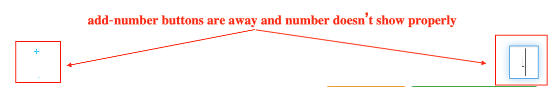

Thanks for your feedback on the RTL mode, I start to work on this, in order to upgrade the rtl.css, I can suggest you to add this on your
rtl.css file (in YourWebSite\media\com_hikashop\css)
Add this code :
#hikashop_order_main .hikashop_order_right_part,
#hikashop_order_main .hikashop_order_left_part {
float: left;
margin-top: 5px;
clear: left;
.hika_toolbar .hika_toolbar_btn.hika_btn_32 {
float: left;
You can add this at the end of your file.
For your specific quantity filed issue can you provide an Url link because on my side I have this, so basically nothing seems wrong on my localhost.
If you have any other issue with Rtl continue to inform us for rtl.css improvement, as it isn't easy to test everything...many thanks !

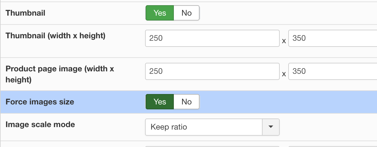

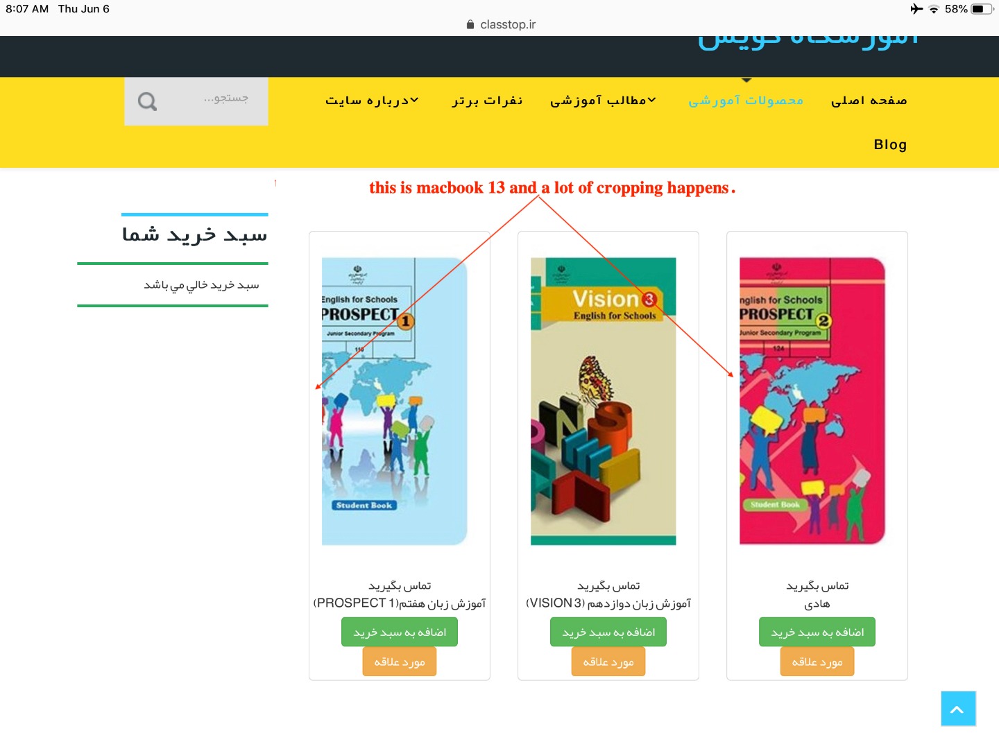

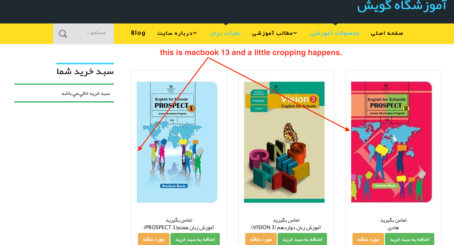

another case (as you will see in the url) is that in small desktops and tablets, instead of resizing the images, it crops some of my pictures.
I don't know if I have to resize all of my images?!
this is the sizes advised by my theme provider:
kind regards.

"another case (as you will see in the url) is that in small desktops and tablets, instead of resizing the images, it crops some of my pictures.
this is the sizes advised by my theme provider:"
You don't have to resize yourself, but I use your Url link and wasn't able to see your cropped image issue, can you precise a precise example in order to better understand the context.
Awaiting news from you

Hello Philip
thank you for your great help.
I couldn't find the exact codes in the template but I wrote some lines in my custom.css to make the width auto. and it worked.!
you helped a lot.
best regards.
