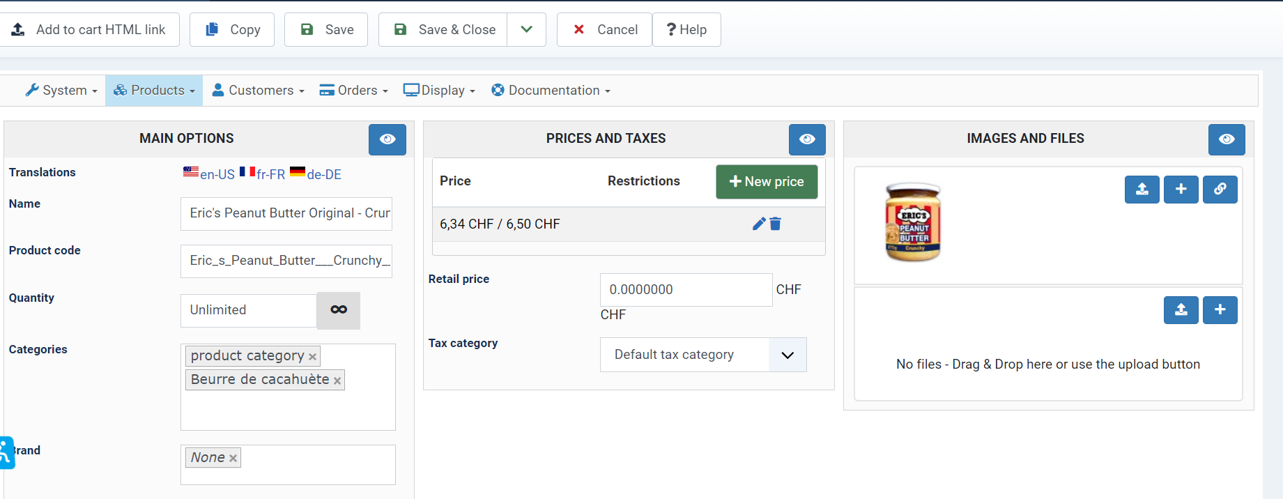

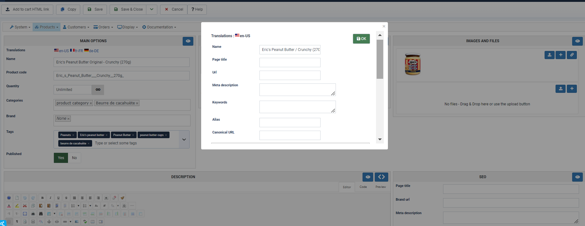

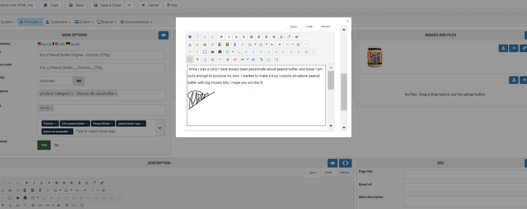

Could you provide screenshots of the settings of a product in your backend, and of its translation popups, and the corresponding link on the frontend so that we can check the situation ?
  • Posts: 71
2 years 10 months ago #356592
Please find print screens of the back end and a link to the English translation, but the product's description remains in French. www.ericspeanuts.com/en/shop-en/product/...-butter-crunchy-270g

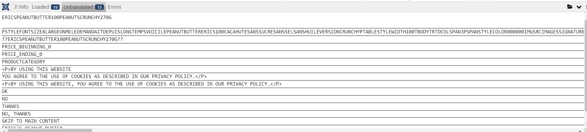

Please activate temporarily the "debug language" setting of the Joomla configuration and check at the bottom of the page with the issue.
It point point at at some problems with the translation override file, preventing Joomla from processing it on the frontend to access the translations.
  • Posts: 71
2 years 10 months ago #356598
Ok I just did. I could not see anything special. There was no error message.

Your screenshot says that Joomla doesn't find the translations.
So I'm thinking HikaShop might have found you still have the Falang tables in the database and thus is saving the translations in there, but they are not used because Falang has been uninstalled.
Could you check if you have the falang tables in your database via your PHPMyAdmin ?
If so, rename them, and redo the translations via the interface in the backend and it should then work.
