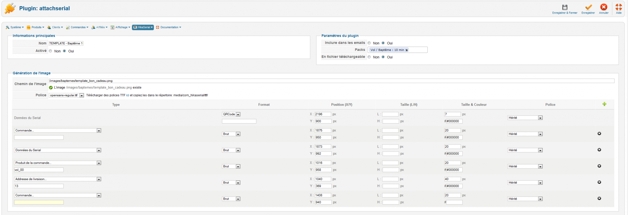

  • Posts: 79
12 years 3 months ago #157116

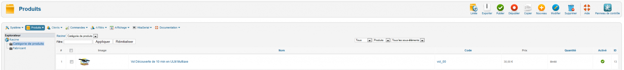

Hello
Can someone tell me what is 'namekey', i do not find this label in the product table.
Actually i'm using a French version , i will tried to use the "code" fieldname with no success.
My product code is 'vol_00'
I also would like to display the order number, but i do not find how to do it.
This is attached below what i did so far.
Many thanks for your help,
  • Posts: 26387
  • Thank you received: 4078
12 years 3 months ago #157190
The namekeys are the column name from the database.
You can find the HikaShop database structure here : www.hikashop.com/support/support/documen...ocumentation.html#db
Example : For the order number, it is the field "order_number" from the table "order.
