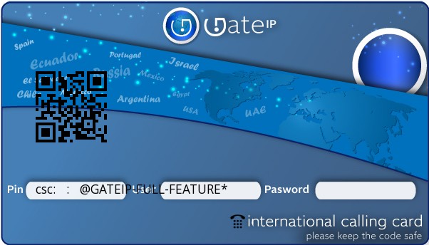

We are a VoIP providers and we sell Calling Cards and VoIP accounts using Hika Shop and Hika Serial.
we have different types of serial pak's uploaded the contain user/password and some other account information.

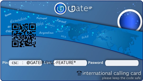

We added a new Phone Application to our system, this phone get's all configuration info from a QR and releasing the user from the need of dealing with configuration. at the same time we want the user to have the info in text view. i attached sample image containing fields for the account information and QR.
so we have one row of serial data that displays the account information and it works fine.
when we try to add QR code on the same "attach serial" we have 2 problems:
1 - how to add the text field to the same pack ? (must be the same user)
2. - how to display on the same image both, the text field and the QR

the outcome needs to be an image with 1 field containing the serial data (which is per-defined user and pin code) and a QR that contain a string with the user and pin code as well.
The pack should look like...?:
pack_name,serial_data,4QR_extra_data
withQR,999999999,aiAVvaw3,crc:999999999:aiAVvaw3@GATEIP-QR-PHONE
so the uploaded serials will have 2 sources
1 - will display the serial data field (999999999 aiAVvaw3)
2 - will display a QR code built up from another field (crc:999999999:aiAVvaw3@GATEIP-QR-PHONE)
The attached serial configuration to pick the serial data is working fine as long as there is no extra fields so my questions are:
1 - how would I write the new Pack and the uploaded file so the to add "4QR_extra_data" filed will show up on the serial list of the Pack
2. - Ho would I write the attached serial so this QR will pick the right data and display the QR on the image.
please let me know if i managed to explain the case.
Thank you.
