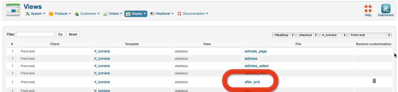

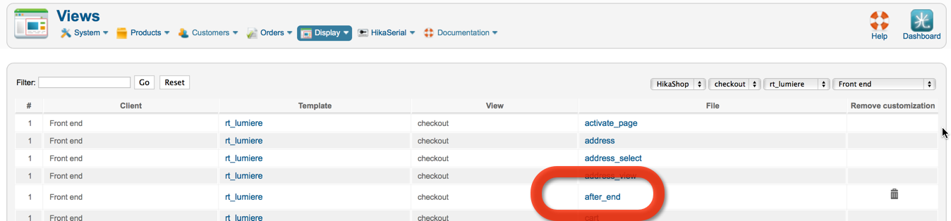

  • Posts: 10
12 years 4 months ago #156993
Hi Jerone
I'm sure i'm editing the right file, pls see picture below:
And didn't get any thing printed from the var_dump, it feels that the after_end file is not executed.
