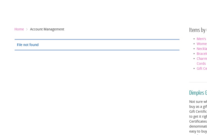

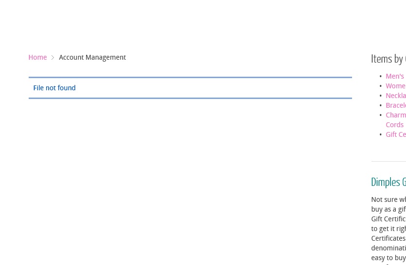

I can't get Attach Serial to deliver a coupon link in the confirmation email. It delivers the link, but when I click on the link I go to a "Message: File Not Found" error. Here is what I have done:

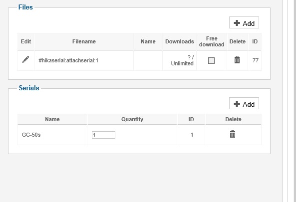

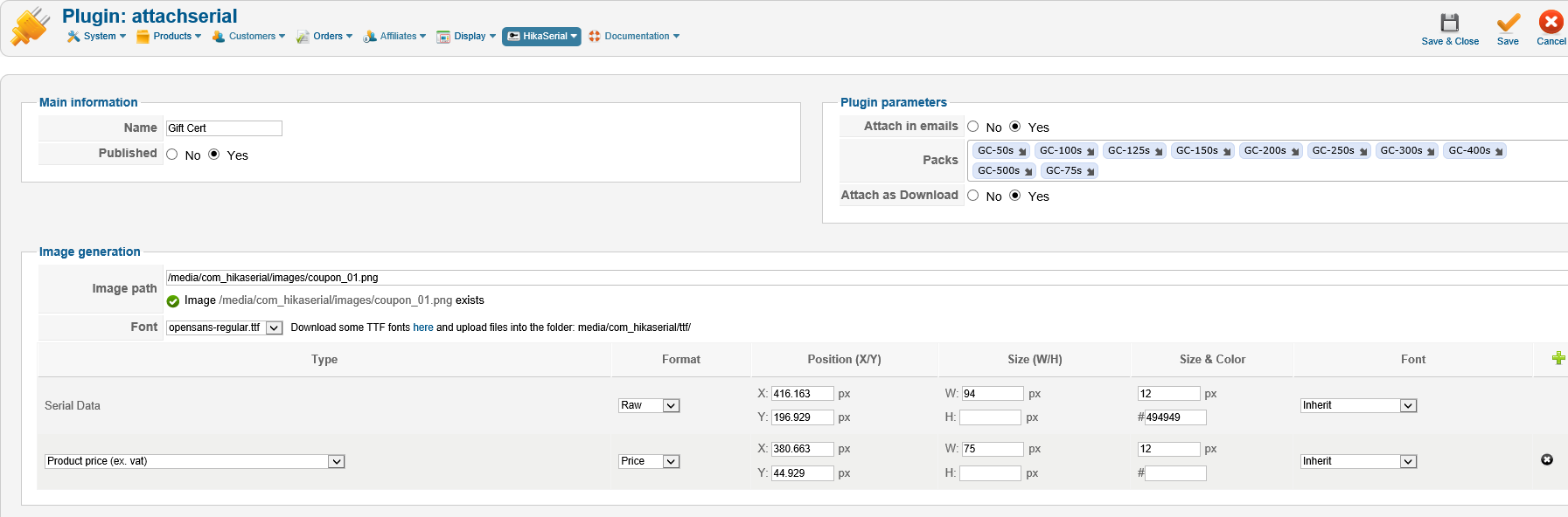

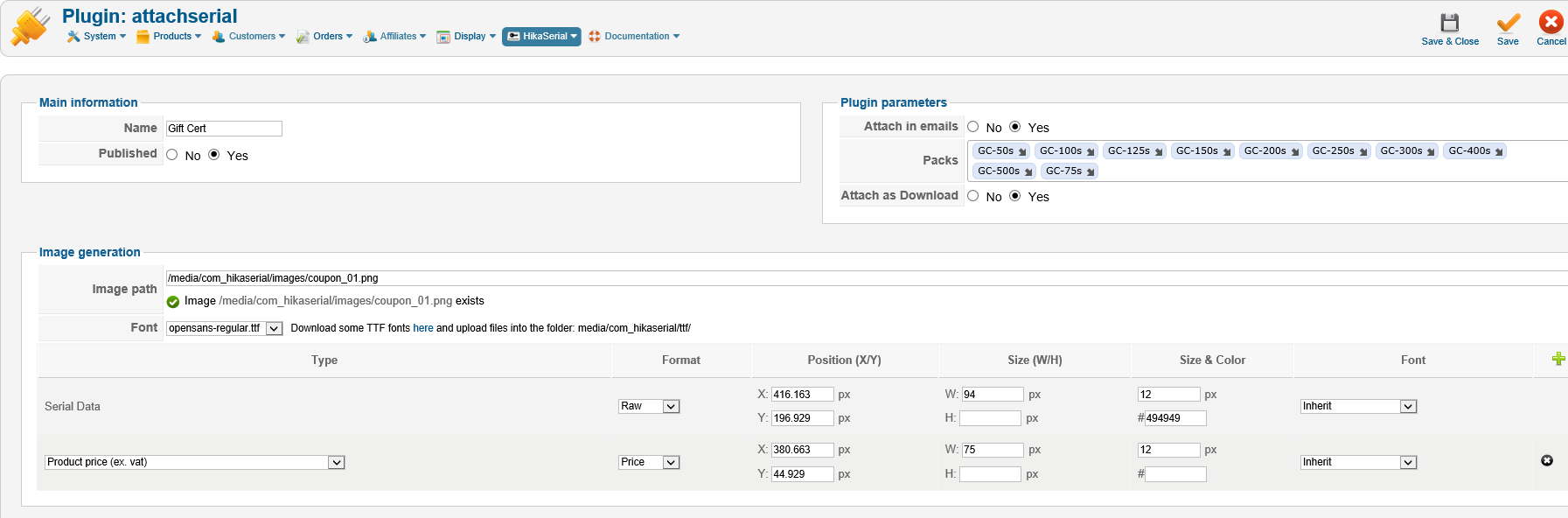

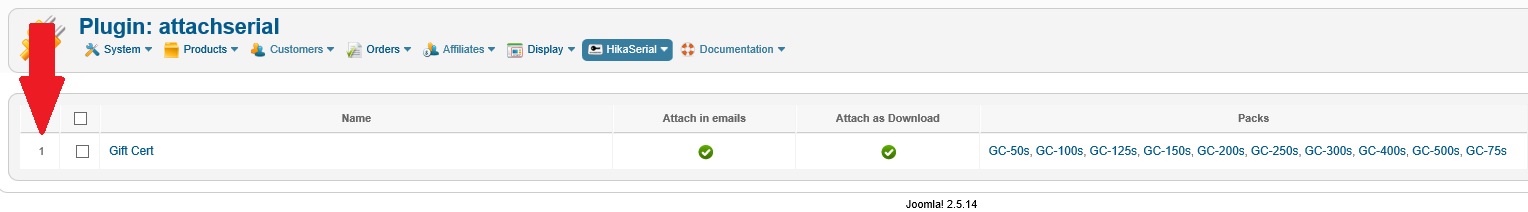

6. In Attach Serial plugin, created a graphic template for the gift certificate (Gift Cert, ID #1) - see attached file "attachserial1.png" for example - I just replaced your sample "coupon_01". I have tried embedding it in the email, and I have tried setting it up as a dynamic download, but this is where I'm getting stuck. Neither one works.
In your instruction you say: "To create a dynamic download file, you have to add a file to the targeted product and specify the url for the file. By using the url "#hikaserial:attachserial:X" where X is the ID of your attach serial configuration, you will let the plugin generate dynamically the file during download."

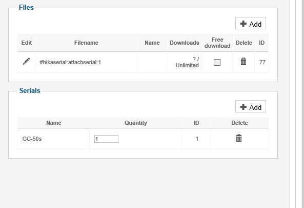

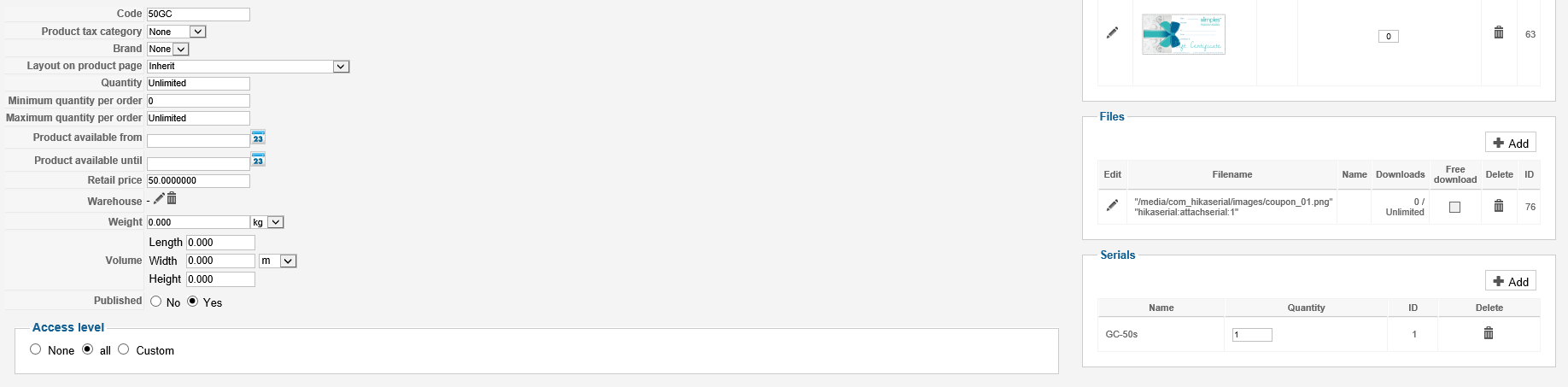

I have tried putting every possible configuration of "#hikaserial:attachserial:X" in the product file (see attachment "attachserial2":)
  • /media/com_hikaserial/images/coupon_01.png#hikaserial:attachserial:1
  • "/media/com_hikaserial/images/coupon_01.png" "hikaserial:attachserial:1"
  • "#hikaserial:attachserial:1"
  • #hikaserial:attachserial:1

The last one should be the good one :
But we have to check that your configuration in the first screenshot has the id 1
The "attach serial" configuration already know the file it should use and the data it should print.
That's why the plugin just requires the id of the configuration to load and process it.

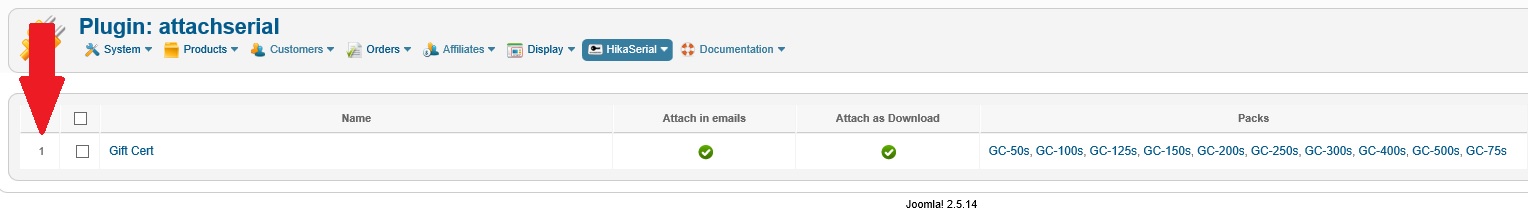

11 years 11 months ago #156813
Thank you.
1. The Configuration for the Attach Serial is ID 1 (see attachment "Serial1.jpg")

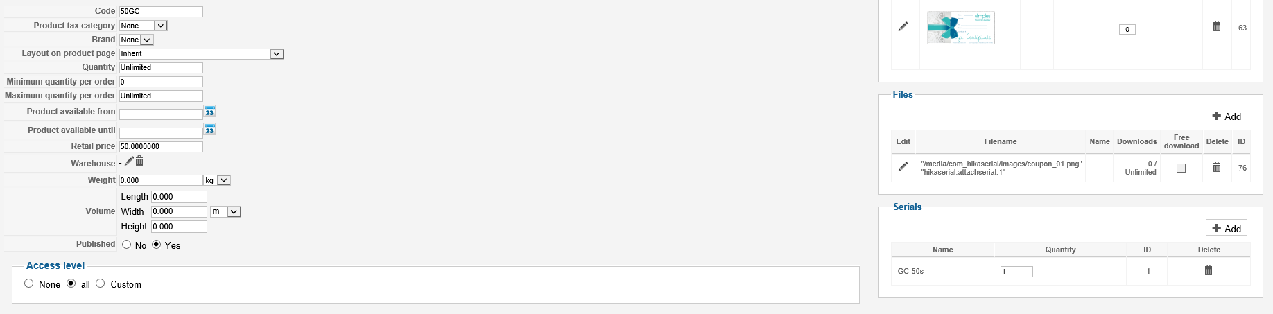

2. The product file link is #hikaserial:attachserial:1 (see attachment "serial2.jpg")

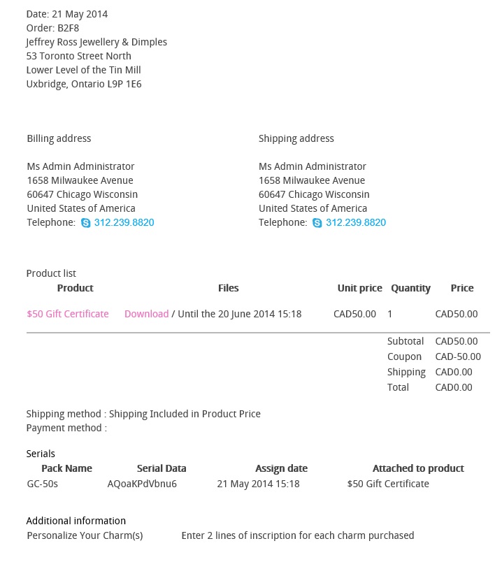

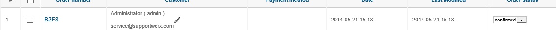

3. The order is "confirmed" (attachment "serial3.jpg")
4. The serial data shows on the order data in the customer file (attachment "serial4.jpg")

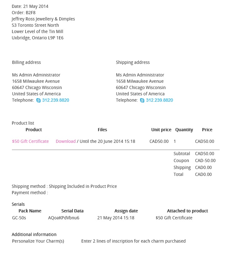

5. When I click the download link on the backend order view or the link in the confirmed order email, I still get "file not found." (attach "Serial 5 - click download.jpg")

Unfortunately, the plugin id is not display in the listing.
The number displayed in your first screenshot is the counter.
To get the plugin_id, you have to click on the "Gift cert" and read the parameter "plugin_id=" in the URL.

Thanks for the accesses.
The plugin "attachserial" wasn't published in your Joomla plugins (and in the HikaSerial plugin listing).
I published it and I have now the error :
Fatal error: Allowed memory size of 67108864 bytes exhausted (tried to allocate 32626080 bytes) in /home/content/87/11684287/html/plugins/hikaserial/attachserial/attachserial.php on line 907
Generating dynamically images requires memory, you have a 64Mb limitation which is too little for processing the image (which requires 32Mb in the memory).
Please increase your PHP memory limitation in your PHP setting (in your web hosting).
You can also try to use a smaller image than yours current one (width: 3336px / height: 2445px). It is really really a big image.
Kind regards,
