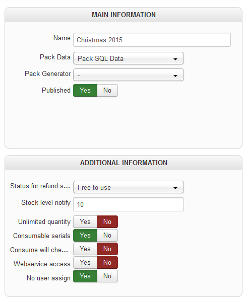

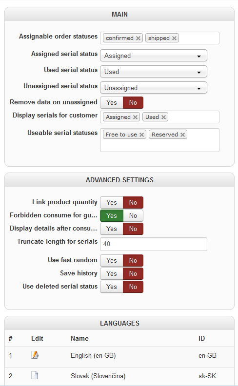

  • Posts: 3
10 years 9 months ago #223683
Hi Jerome,
Ron is my co-worker and we are trying to achieve this:
Change the assigned user at "consume" process.
I have tried set the Serial Pack to "No assign user=Yes" but after order confirmation, there is user (buyer) assigned to SN.
For better explanation here is the model situation:
- User buy some product from our shop and receive 2 codes.
- First one is SN for our software (not consumable in our shop)
- Second one is a code for Raffle via AttachSerial plugin.
- The code for Raffle can be given as a gift to someone (another registered user)
- Raffle code must be consumed for participation in Raffle.
But after consumption of the Raffle code, there is still the buyer assigned to the code.
Is there a way how to change the assigned user?
Or at least add some additional info to "Serial Extra Data" from user who consumed the SN.
thank you
  • Posts: 26386
  • Thank you received: 4078
10 years 9 months ago #223750
When the setting "no user assign" is set, the generated serial is not assign with the user.
But if you have a serial already "pre-assign", that serial will be select in priority.
So the setting "no user assign" is mostly when you're using a serial generator.
Would it be possible to have more details about your configuration in order to check that all is right ?
The following user(s) said Thank You: webium, Ron

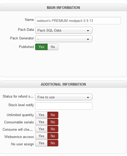

  • Posts: 3
10 years 9 months ago #223755

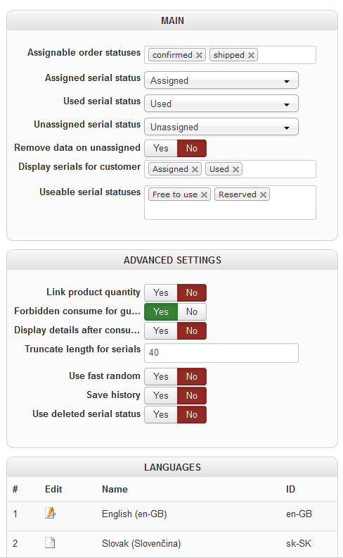

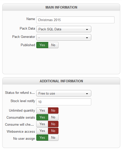

Configuration:
1. Serial pack (should be NOT consumable)
2. Serial pack (this one is consumable, and the user is assigned after order confirmation)
pls. let me know if you need more
thank you
Last edit: 10 years 9 months ago by webium.
  • Posts: 26386
10 years 9 months ago #223761
The setting "consume will check/assign user" is made to also perform the user assignation during the consumption.
If there is already a user assign, it will just check but if there is no assignation, it will perform it.
  • Posts: 3
10 years 9 months ago #223818
Great, it's working with Generator plugin
thank you again

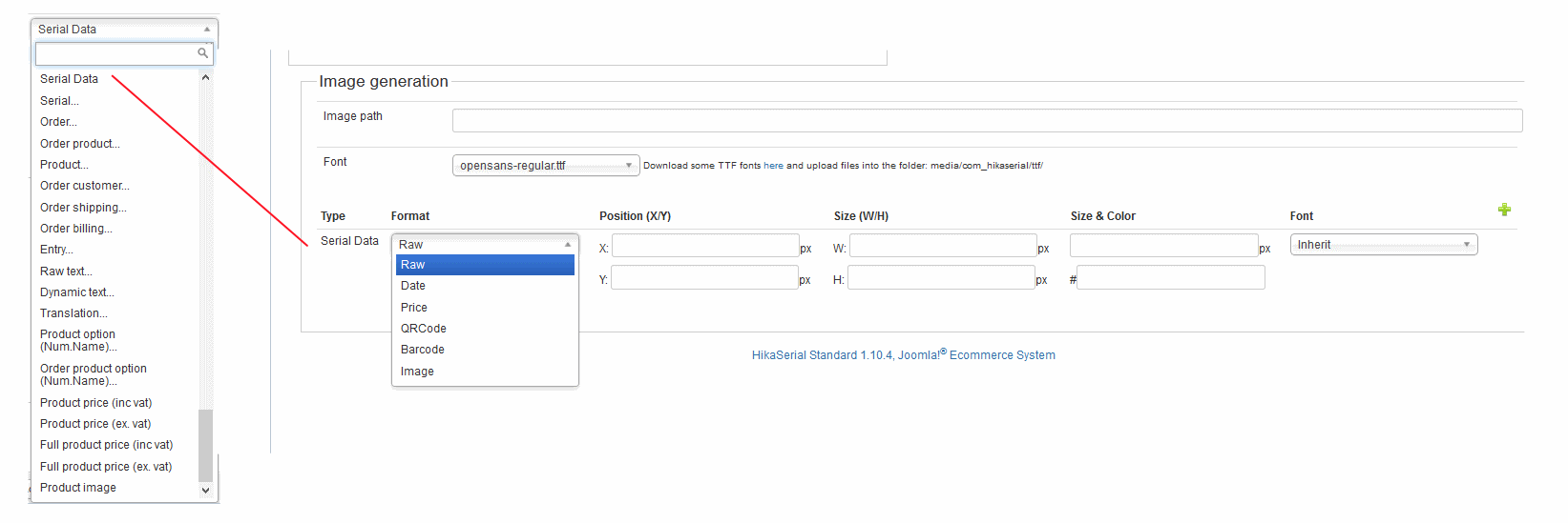

1)
@jerome you write
Now, if you are using HikaShop Business, you can use "item" custom fields.
So for the ticket products, you can display a text input as an item custom field. In that field, the customer would be able to enter the name of the person who will use the ticket.
And in the plugin "attach serial" you can display item custom fields like you can display order custom field, product fields, etc.
Can this custom field item be attach to any table name available ? which is the prefer one ?
durring using attach serial ( what a silly /funny name for create an image /ticket available in mail webpage !!Does it mean serial is required mandatory field ? ); which item let me acces to this custom field ?
Attachment not found

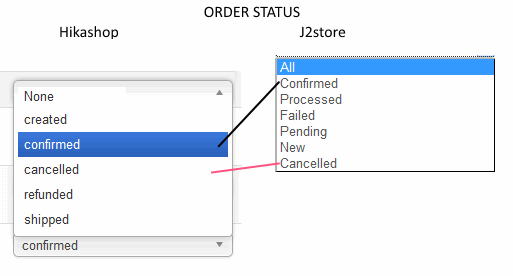

3) about status i see that some e commerce use differents word /term ? Can i have more information about hoses use by hikashop ?
I think there must be a status page in the documentation that explain howto go t oone status to another status ( manually /auto) ?
- pending in bank transfert documentation
-create ->confirm in awo coupon forum
How many status context exist in kikashop ? (3 ? like order , payment , serial )

1/ An "item" custom field is stored in the "order_products" table as it always did.
I can only recommend you to read again the attach serial documentation and see the example at the end of the page.
2/ That question is less related to the current thread than the previous one (which was not already out of the subject).
And I'm afraid that I am not able to understand what you're talking about. What options ? What values ?
3/ It's the HikaSerial section of the forum ; not HikaShop.
Thank you for your understanding.
4/ I'm not able to understand if the question is related to HikaSerial and, if it is, what you're talking about.
I think it would be easier if you create different topics for your different questions and that you do not edit you own post a lot of time to add new content and new questions.
And you're also free to use French if you want.
