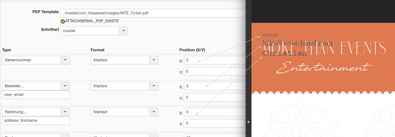

I use the attach PDF and also the atach serial plugin. But how to position the elements on the PDF. Where is 0/0 ?
When I position a text on -200/-200 he stays in the middle top of the document. How to fix that?
As you can see in my image I positioned three elements on 0/0 but they are aligned under each other.
Last edit: 5 years 11 months ago by andiman.
  • Posts: 26365
  • Thank you received: 4069
5 years 11 months ago #321989
Since "0/0" is the default value when you create entries ; that specific value is not read by the plugin and it display the text "below" the previous entry.
From TCPDF and FPDF documentations
SetXY
Defines the abscissa and ordinate of the current position. If the passed values are negative, they are relative respectively to the right and bottom of the page.
The unit is by default "mm" but that value can be override by your template. Since you're using a PDF as template, the plugin use "FPDi" to load your PDF and performs dynamic modifications.
