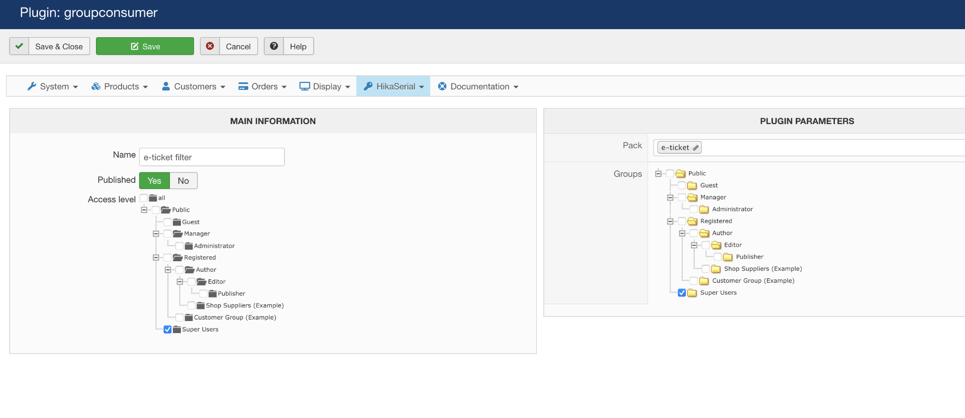

I assume I have made some error in the GroupAssociation - HikaSerial Consumer plugin
I have set the Access Level to Super User (myself)
Set the pack to the right pack and set the Groups to Super Ueser.
What did I miss?

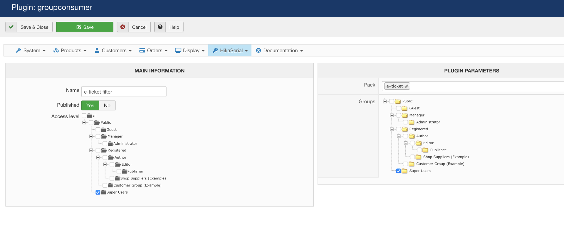

5 years 9 months ago #326266
Hi Jerome
If I disable the consumer plugin I'm able to scan and getting that the serial now is used.
But this way everybody can scan :-(

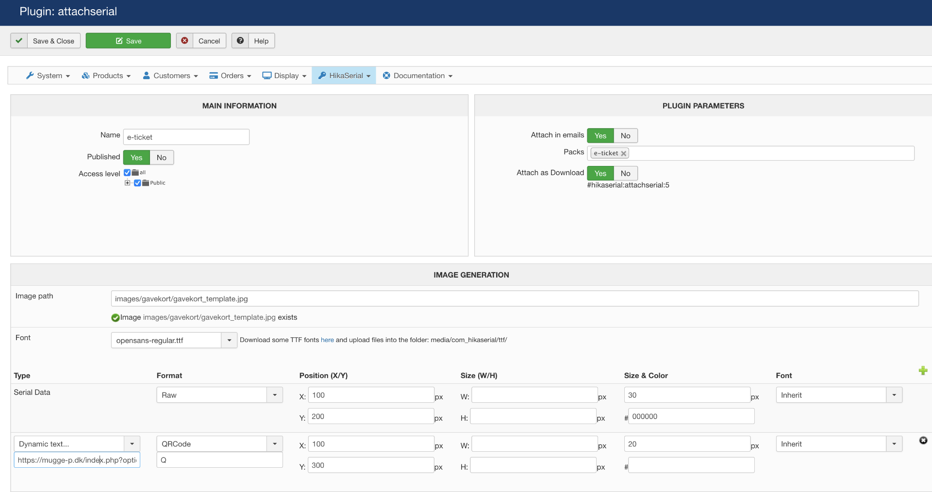

Attached the screenshots!
Thomas

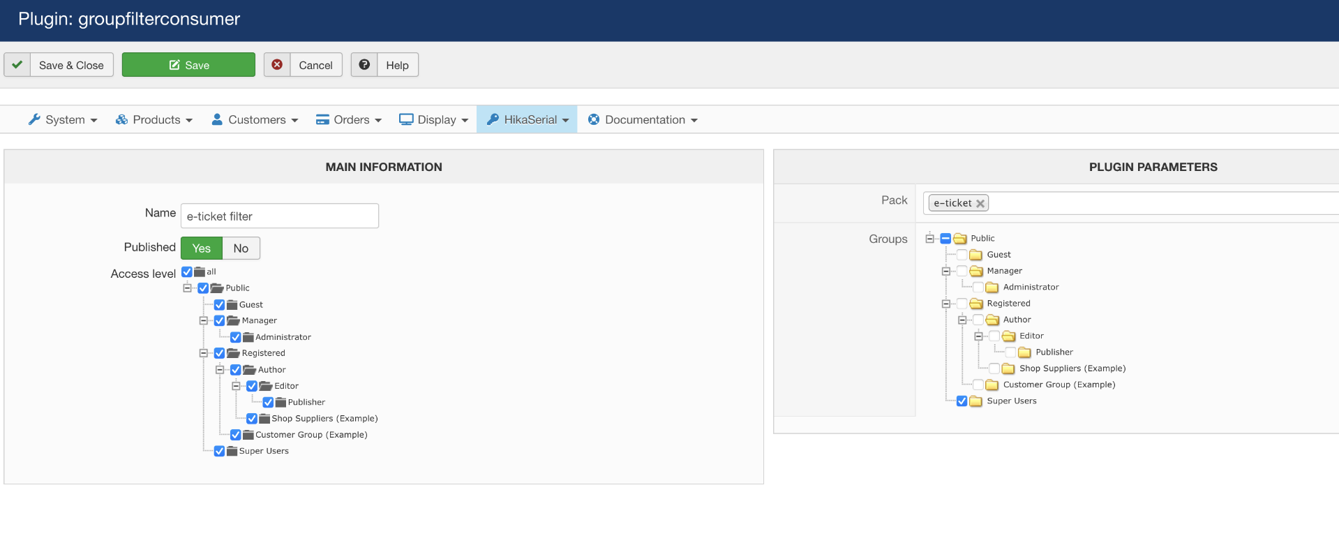

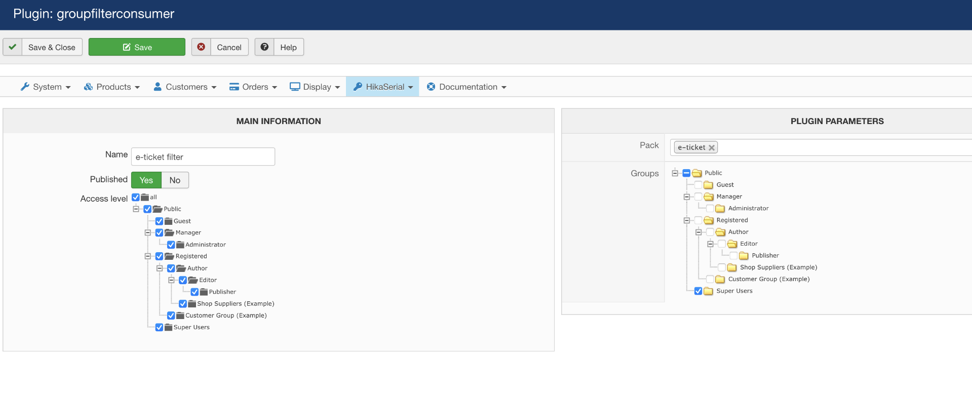

5 years 9 months ago #326323
There is an error in our documentation for the link on the "group filter" consumer plugin.
Here the right URL : www.hikashop.com/support/documentation/3...pfilterconsumer.html
You have to remove the "Access Level" setting (re-set to "all") and just let the "Groups" one.
Then, you will be able to open the URL while logged with a super-user account and it will perform the consumption.

5 years 9 months ago #326326
So I tried this, but I still get Invalid Serial - both as normal user and Super User?
5 years 8 months ago #326330
Your (last) settings indicates that you need to be logged as a super user to be able to consume the serial.
Please note that you can use the same serial (and URL) for your tests ; you can simply edit the serial in the backend to change its status to "free to use" and then perform a new test.
Regarding your configuration, please note that "public" won't have any effect since it's not a group used by Joomla. Classical users are generally "Registered".
