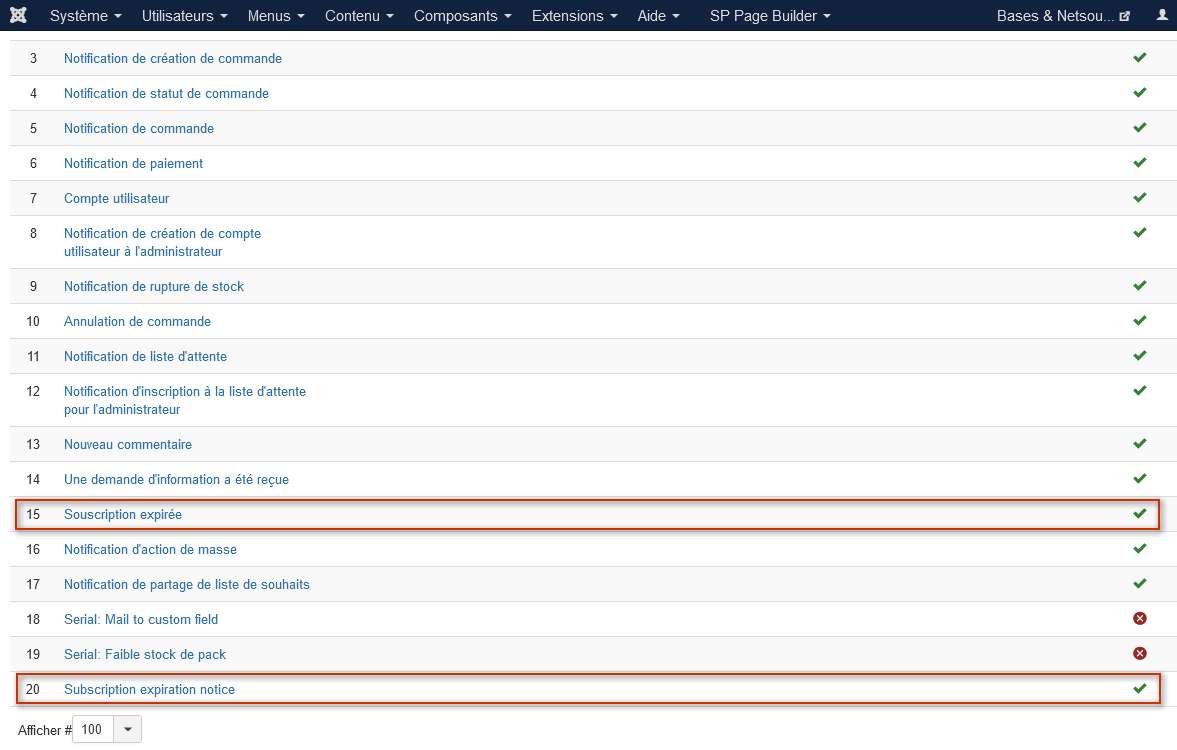

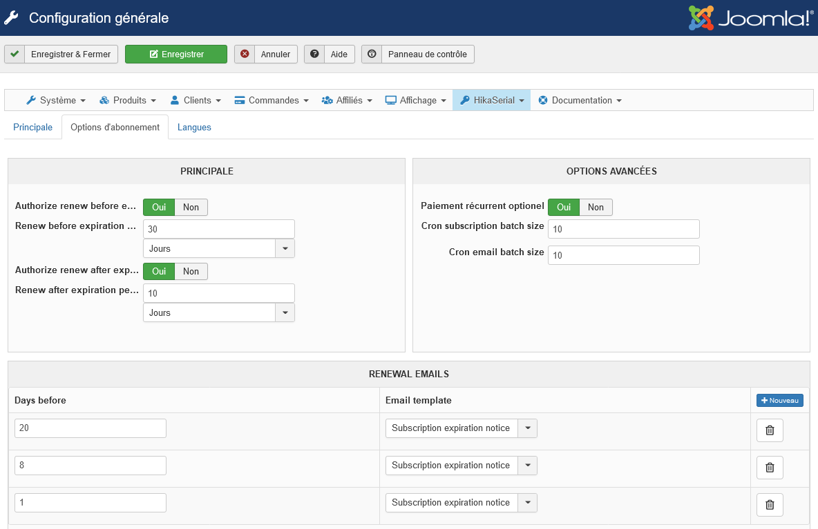

I manage a site that offers content under subscription.
For this I use HikaShop and HikaSerial.
The sending of reminder mails before the subscription expires is not done.
I don't understand what I didn't set correctly, I have activated the recurring payment in the configuration and activated the 2 emails that seem to be used for the reminder.
Thank you for your help ;)
