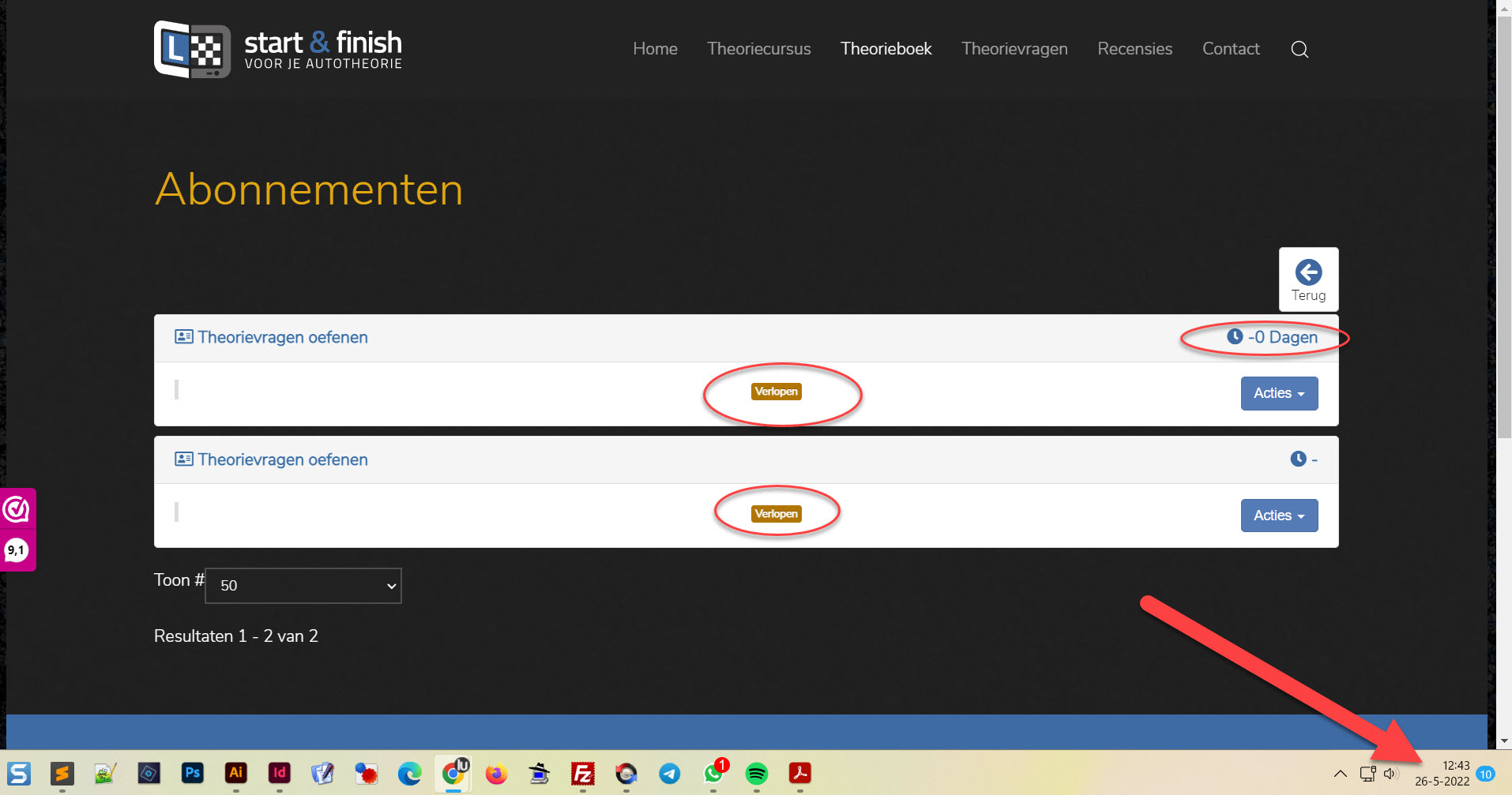

When you go to subscriptions it shows Expired (Verlopen translate to Dutch)
So that looks fine, but still we can see al the subscriptions pages and after a expired subscription that's not desirable

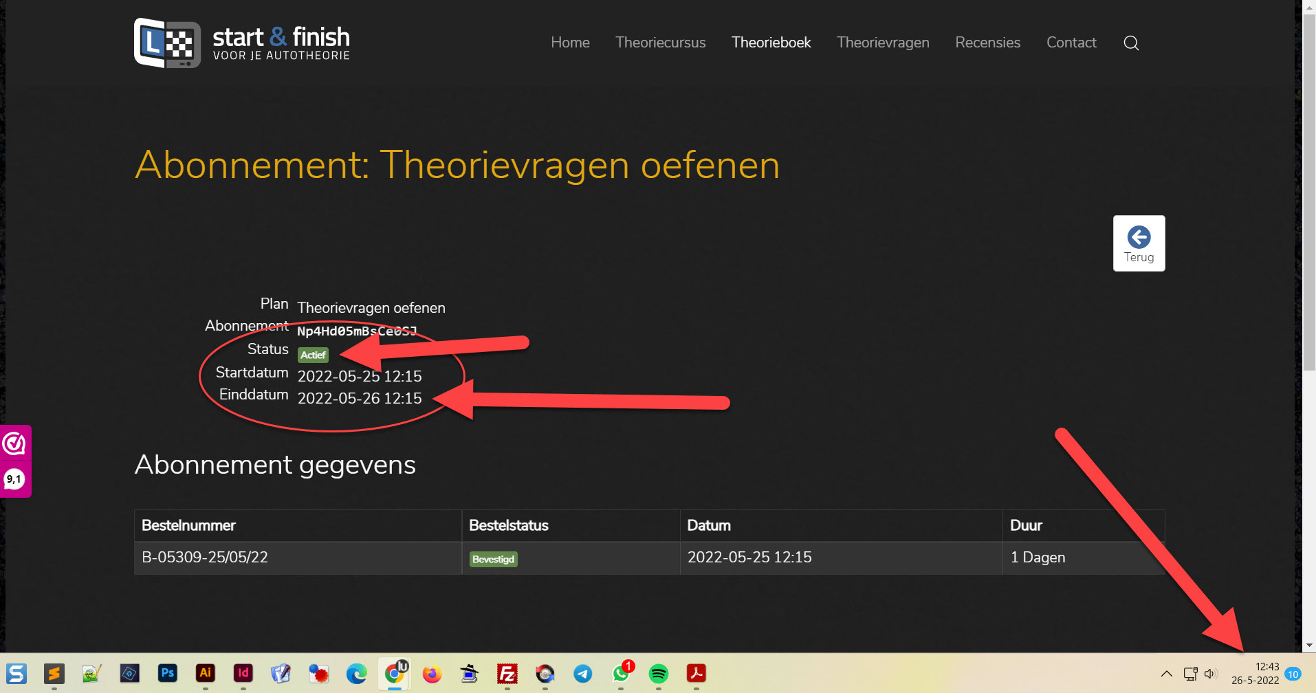

When we click on the subscription we see that the subscription is ACTIVE. How is that possible?

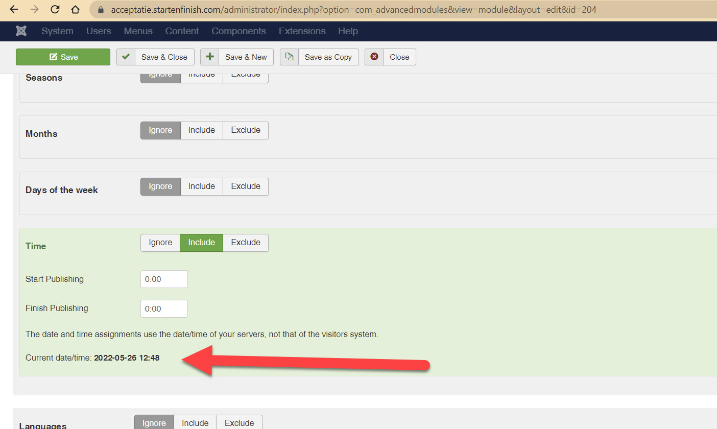

We checked our server time and that's correct.

45 minutes later it's fine now! So it looks like there is a delay
Kind regards,
Lumiga
  • Posts: 26386
  • Thank you received: 4078
4 years 3 months ago #341986
HikaSubscription update the subscriptions thanks to the HikaShop cron task.
But, when a user log-in, the add-on also perform a check for the user's subscriptions.
For performance, we do not check the subscriptions states for each generated page.
