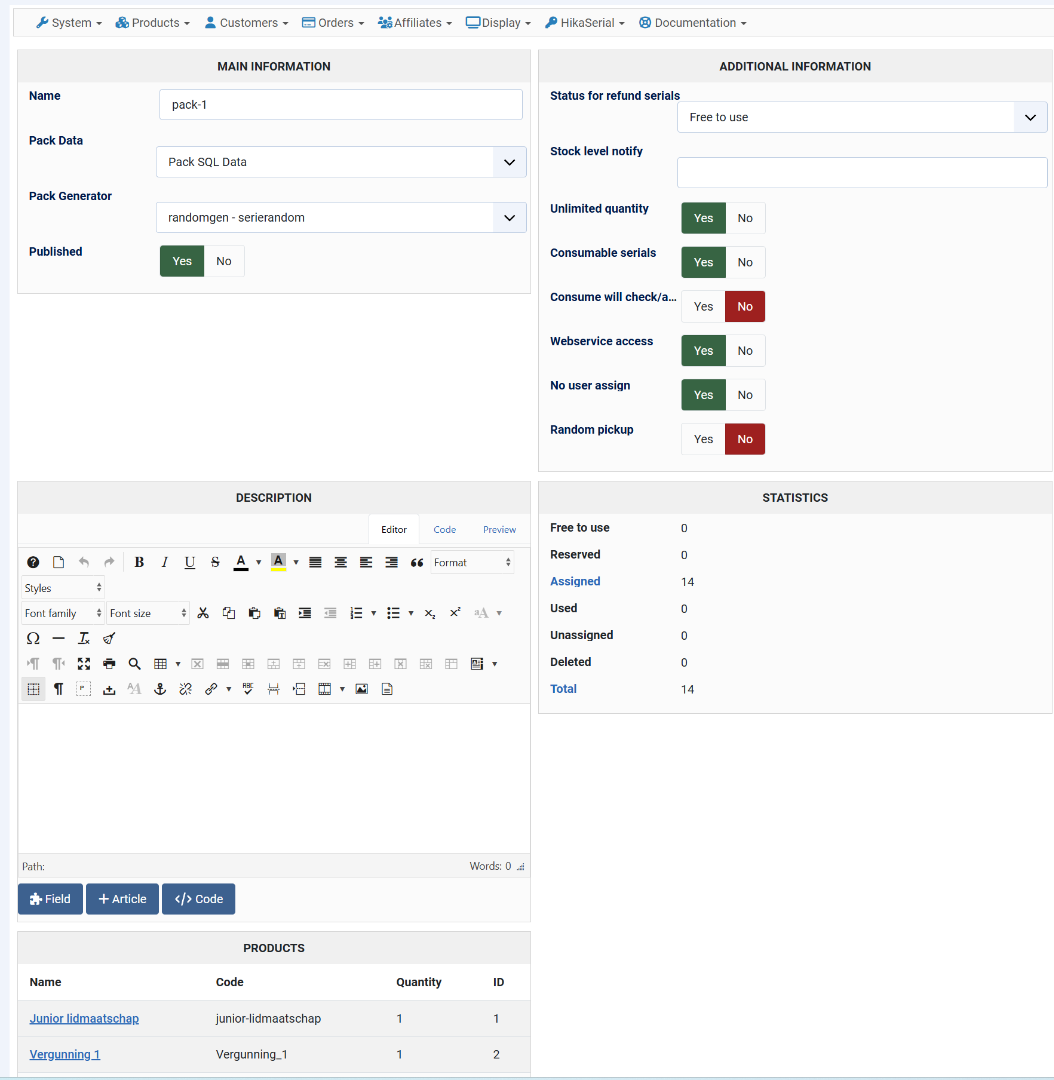

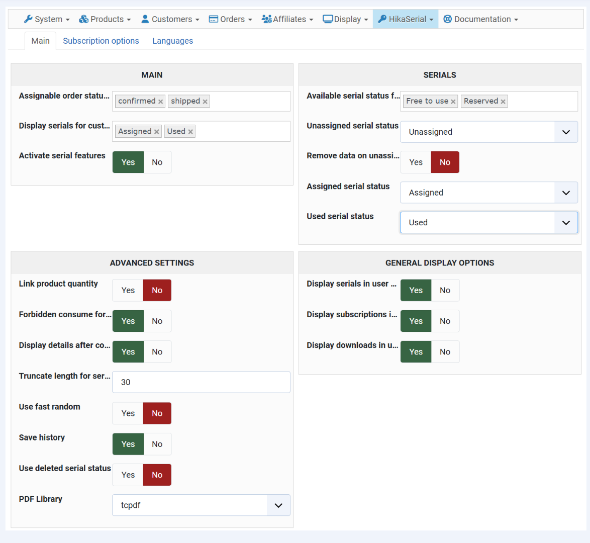

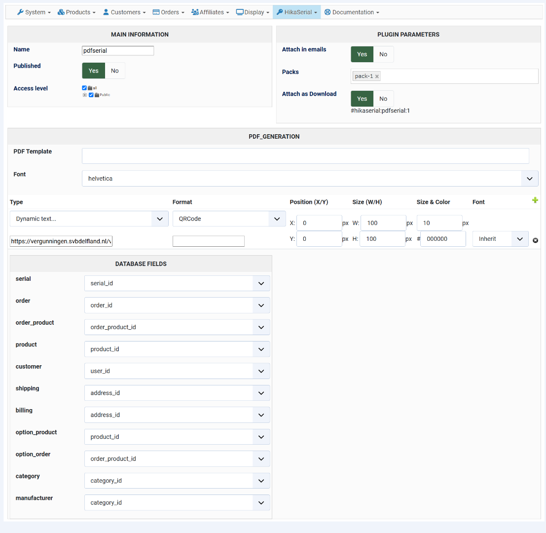

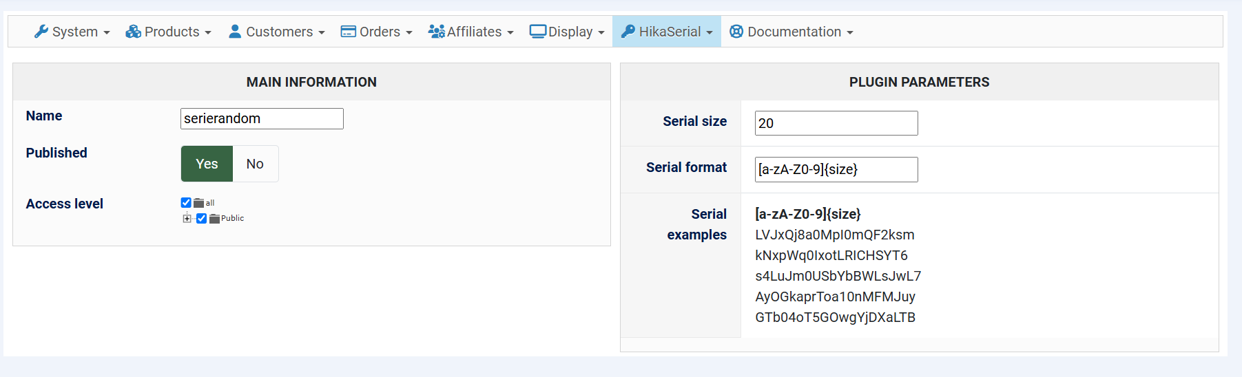

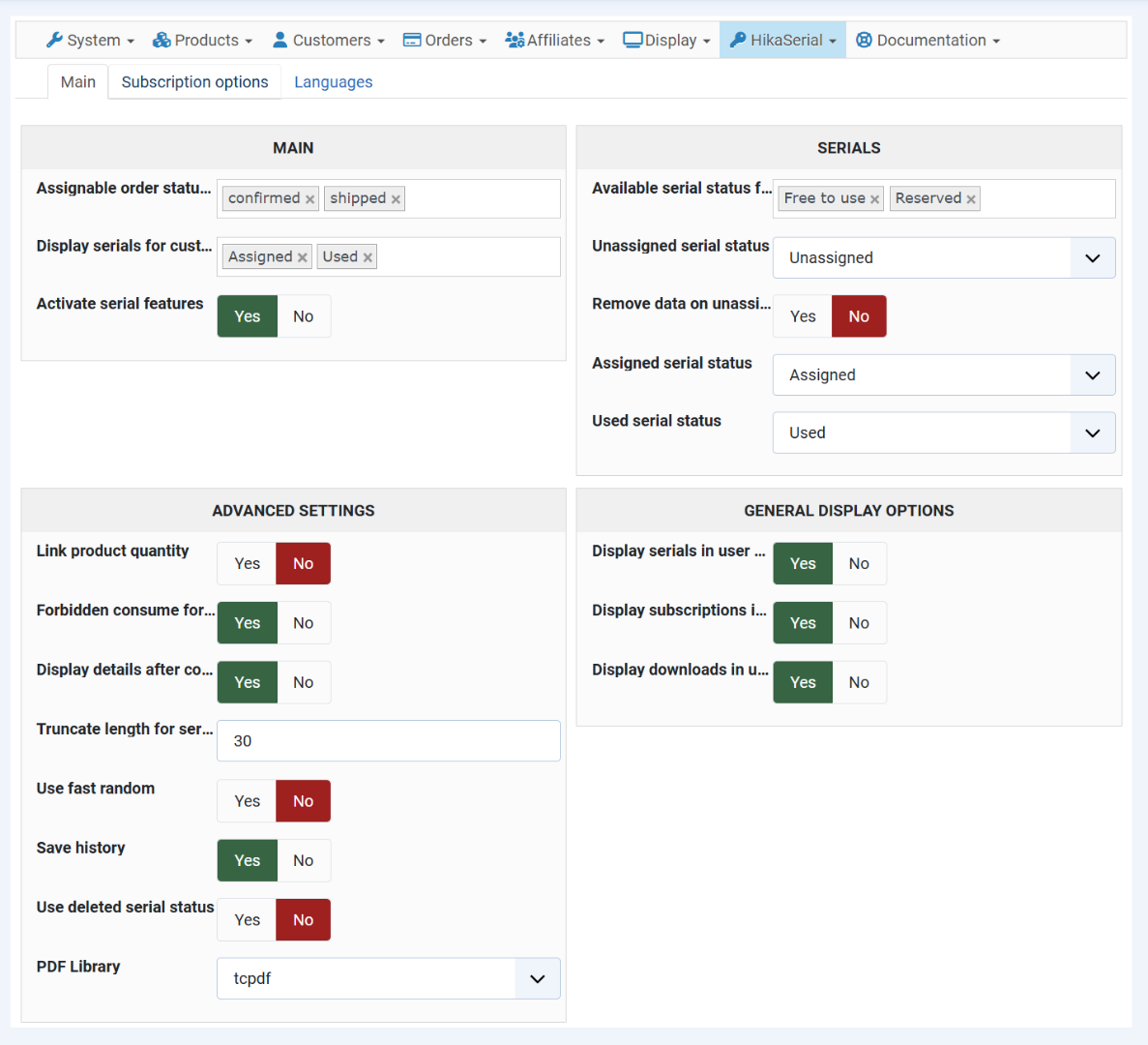

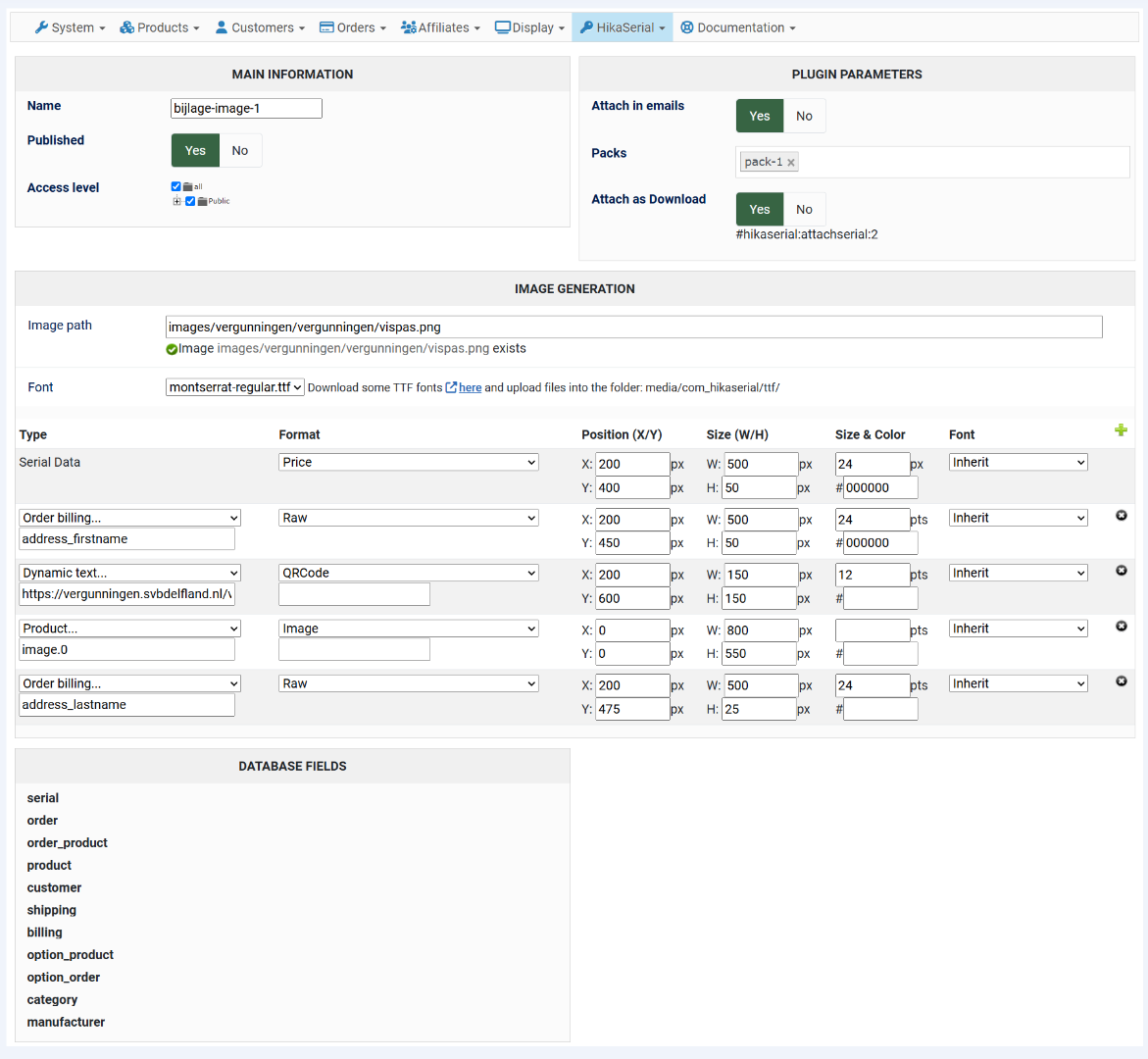

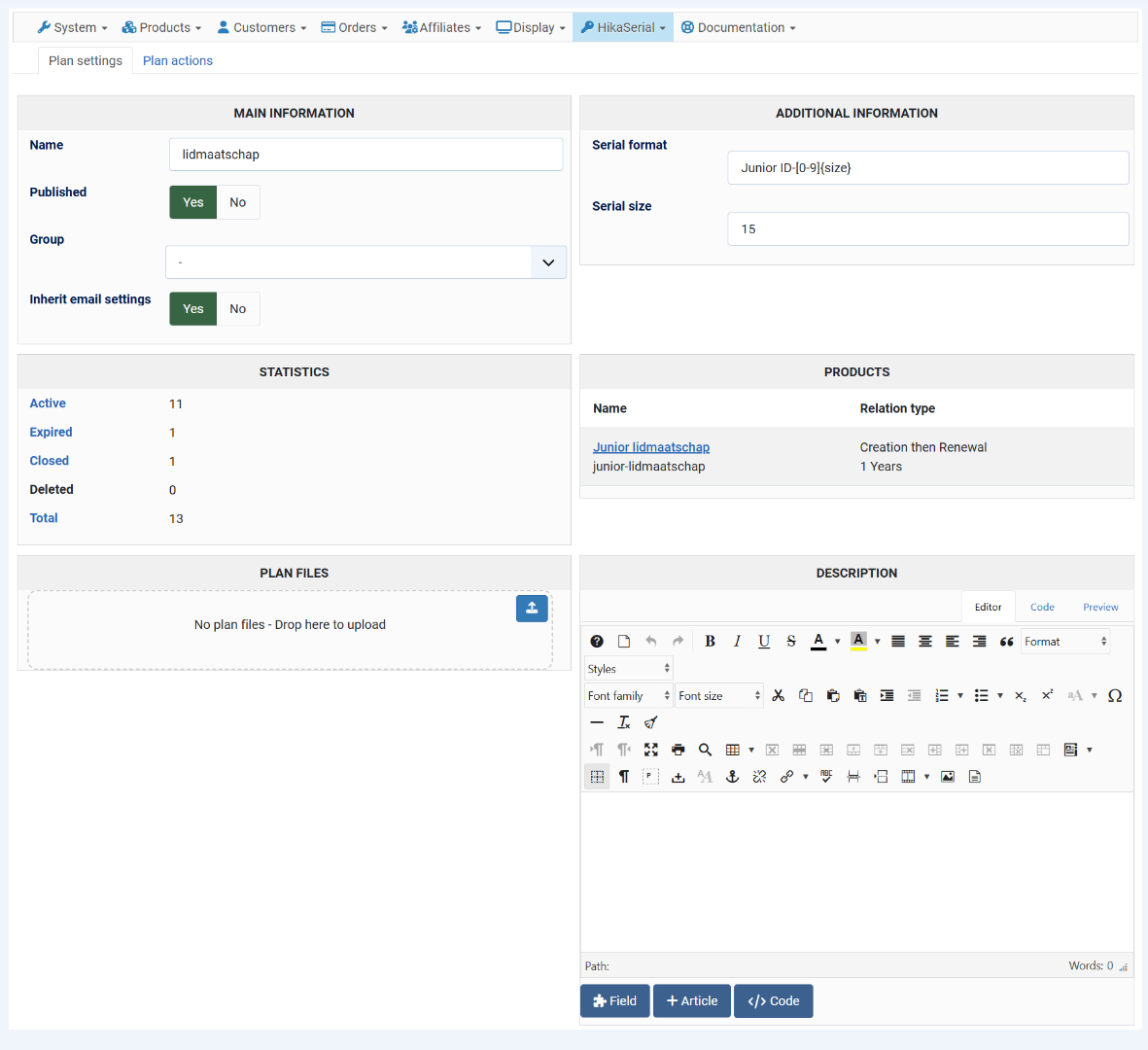

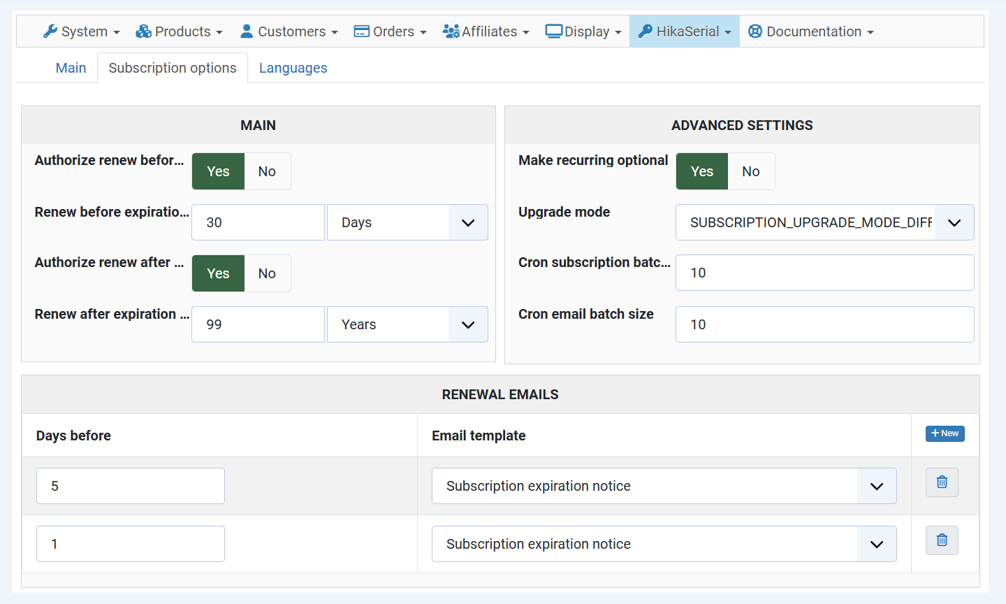

Hello HikaShop Support,
We’re experiencing an issue when using HikaSubscription in combination with HikaSerial.
When a customer places an order that includes a product linked to a subscription, the order status does not change to "confirmed" after payment. However, when we use a product without HikaSubscription, the order is correctly confirmed after purchase.
We followed this tutorial "Selling e-tickets with HikaSerial" to set up the club license:
Everything else works as expected:
If we manually change the order status to "confirmed", the serials are generated, the PDF is created, and the confirmation email is sent to the customer.
We would like to understand how to debug this issue and identify what’s preventing the order from being confirmed automatically.
Please find all relevant screenshots attached.
Thank you in advance for your help!

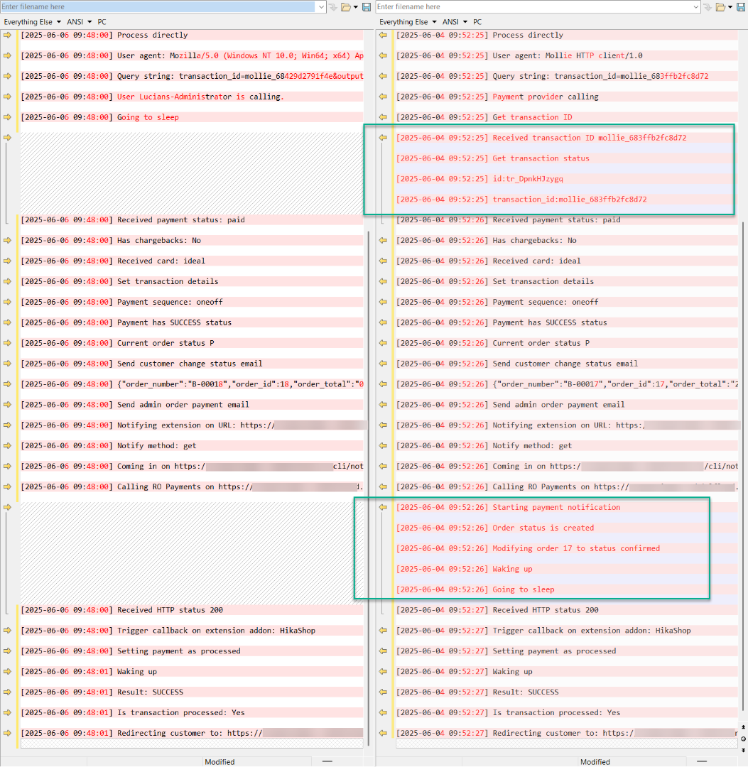

Here you can find the log from RO Payments with a succesfull confirmation and the last one without.

This payment did not set the order to confirmed:

As you expected, there is indeed a difference in the log.
