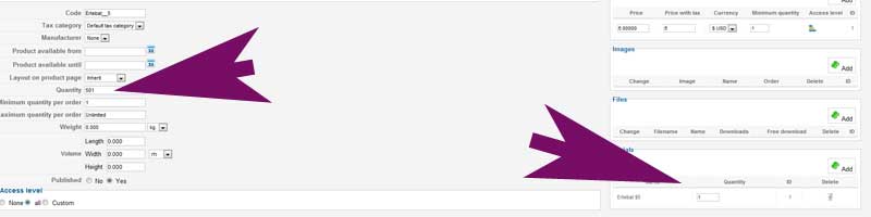

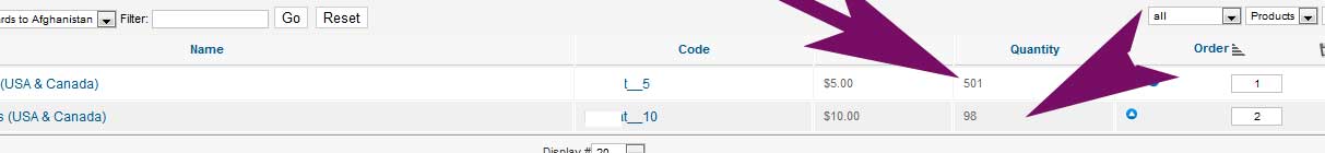

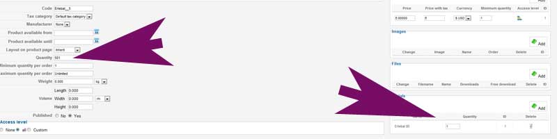

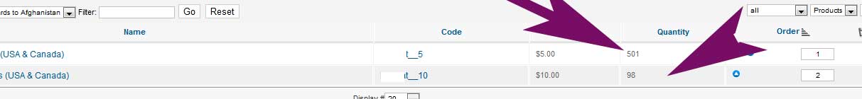

I pm'ed u just now, yes it did work fine, then I had to remove the test products and install actual products, and yesterday the site went live and we have orders which have no serial assign to them.
Under the product page it shows we got 100 item available but I have no idea why it is not assigning them.
Please do tell me exactly what you do, so next time I dont have to bug you guys.

14 years 3 months ago #51481
Last time I recreate the link between the product and the pack.
I think I have create a new serial too and look if the product quantity changed.
You can use the "refresh association" button in the order to make associations and look at the product quantity too (in the front end).
I will make new tests in order to reproduce your problem.
