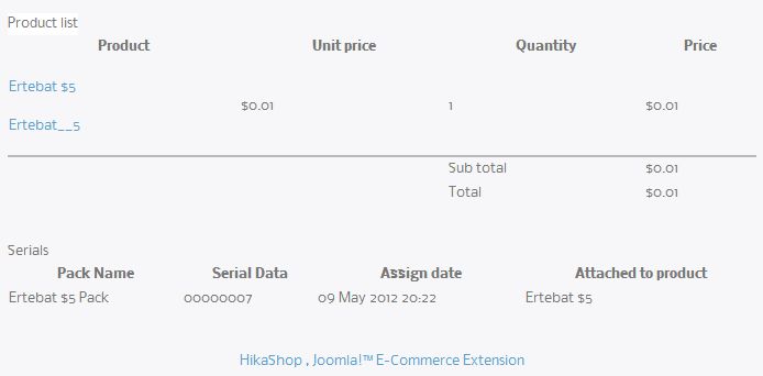

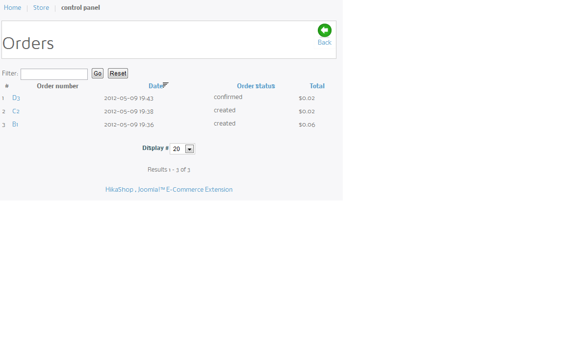

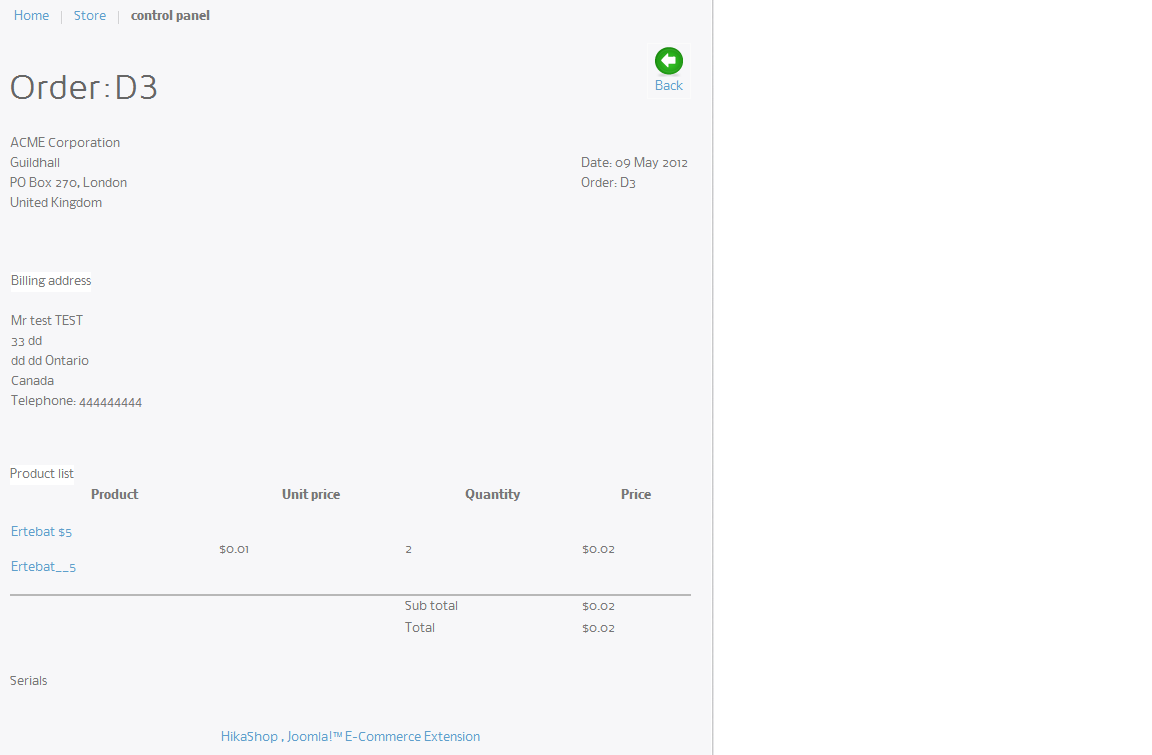

made the payment via paypal
It shows confirmed under my account, however the serials do not shows up, please advise and also look at the attachments

About your configuration, I have create new serials and update your product (the quantity was 0).
I went in the backend and refresh association on your previous orders and it worked.
I made a test and a serial was assigned correctly.
I think it should work good now.
